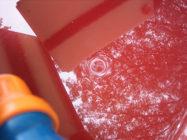

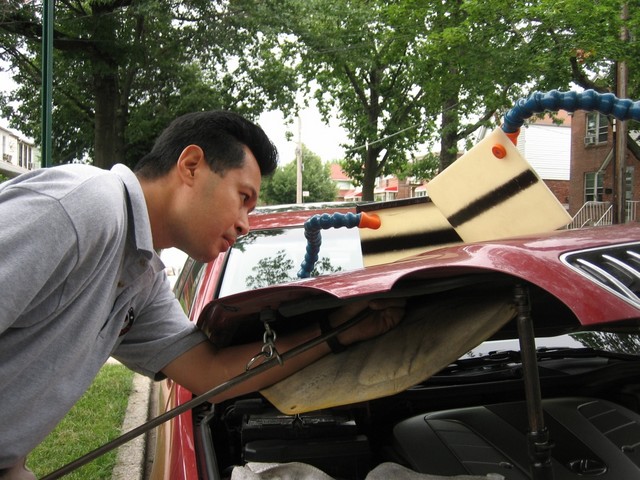

Paintless dent repair is awesome when done well. Some of you may recognize the individual pictured.
This quarter-sized circle was from a golf ball:
After he was done, I could still see where the dent had been, but I can't find the spot now.
Best $75 ever. (Local bodyshop was talking about $350-500.)
