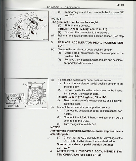

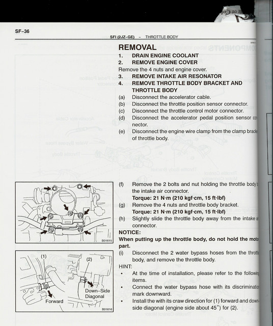

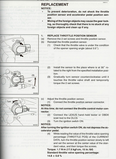

Here is the intake section from the manual. They mention Throttle control motor is this tha same thing that your talking about, idle air control?

more pages
