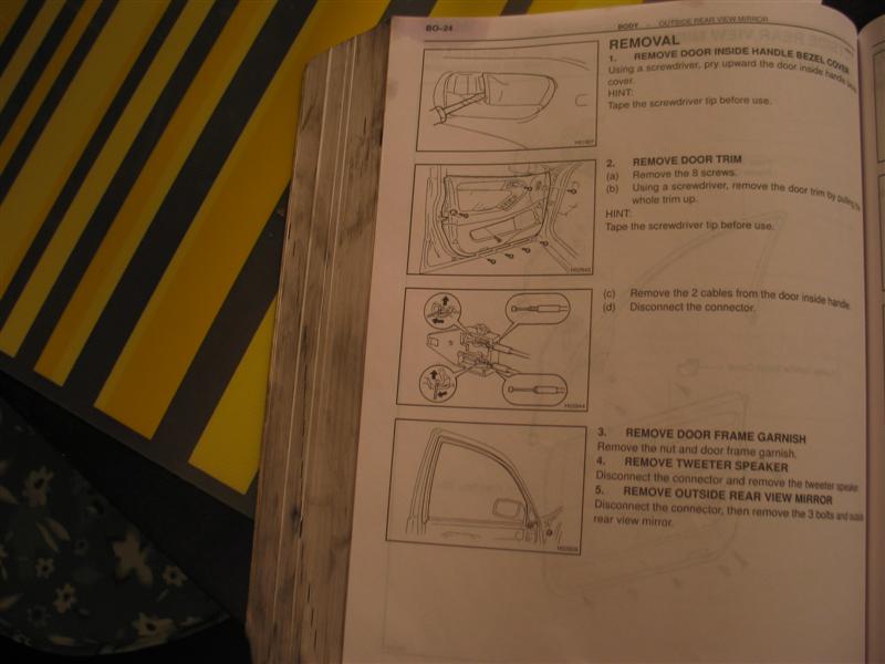

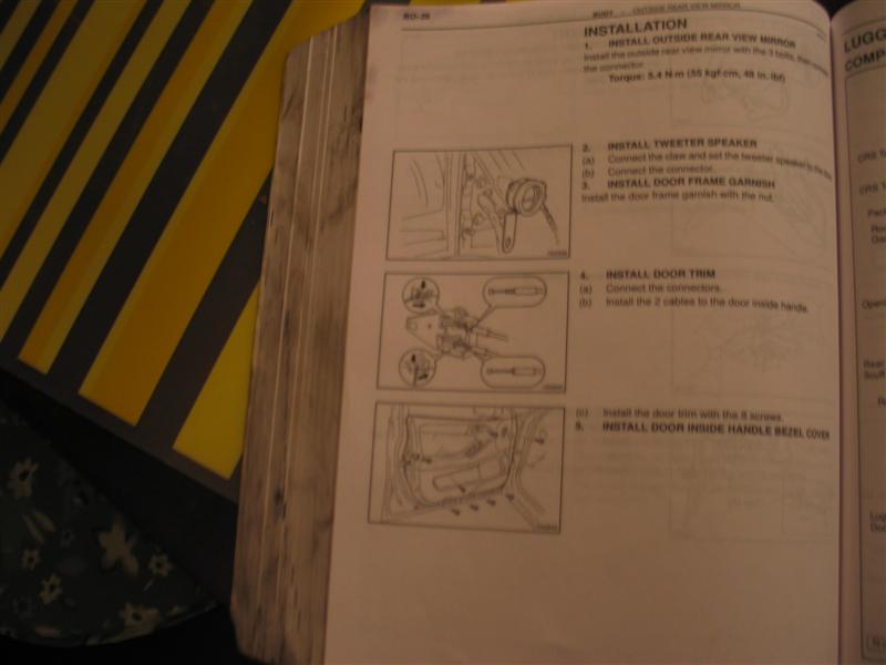

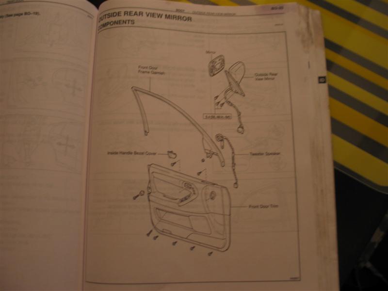

This may sound like a dumb question but is the passenger side mirror for a gs300 and gs400 interchangable? The gs300 is 2000 and the gs400 is 1999.

im going to say yes ..in the manual ..there doesnt say anything about a difference between the 2

you coming to the meet in brooklyn
if you want ill take a pic of the page in the manual

If you could take a pic of the manual that would be great. When is the meet? Not sure if I am ready to go to any meets yet. A few mods later and a visit to the body shop to have a few things touched up and I will be ready.

thanks for the diagrams
