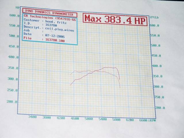

Default MyAristo 2JZ-GTE VVTI - 383 RWHP
So here goes...
I will like to give a big thanks to Punch10. Without you I couldn’t have done this. Second Farley @ GR Racing (He is a supra God).
This project was done in 3 weeks as promised by Farley & his partner Chris. Everything works. Yes I mean everything. No check engine light, VSC works, Cold AC etc…Specs below.
If you have any questions email me at MyAristo@Gmail.com or MyAristo@MyAristo.com
• 17.5 PSI ON 93 OCTANE.
• APEXI S-AFC2 Fuel Controller
• APEXI AFC - Custom Setting Tuned by GR Racing
• Custom Built ATF Accumulator And Valve Body Kit
• B&M Racing Oil Cooler
• Turbo Smart E-boost 40 PSI Controller
• HKS Turbo Timer
• Custom Built 3in Into Two 2 1/2in Mandrel Bent By Florida Performance
• Turbo Piping Is Stock And Feeds Into Custom 3in Intercooler Piping
• Walbro High Pressure 255 Liter Custom Adapted To Return less Fuel system
• Intercooler Core Custom Piping 3in Mandrel Bent And Polished By GR Racing
• 3in Custom Down Pipe
• Stock Turbo Inlet Pipes
• Stock Fuel Pressure Regulator,
• Stock Factory thermostat
• Stock Radiator Dual Fans
Thanks
