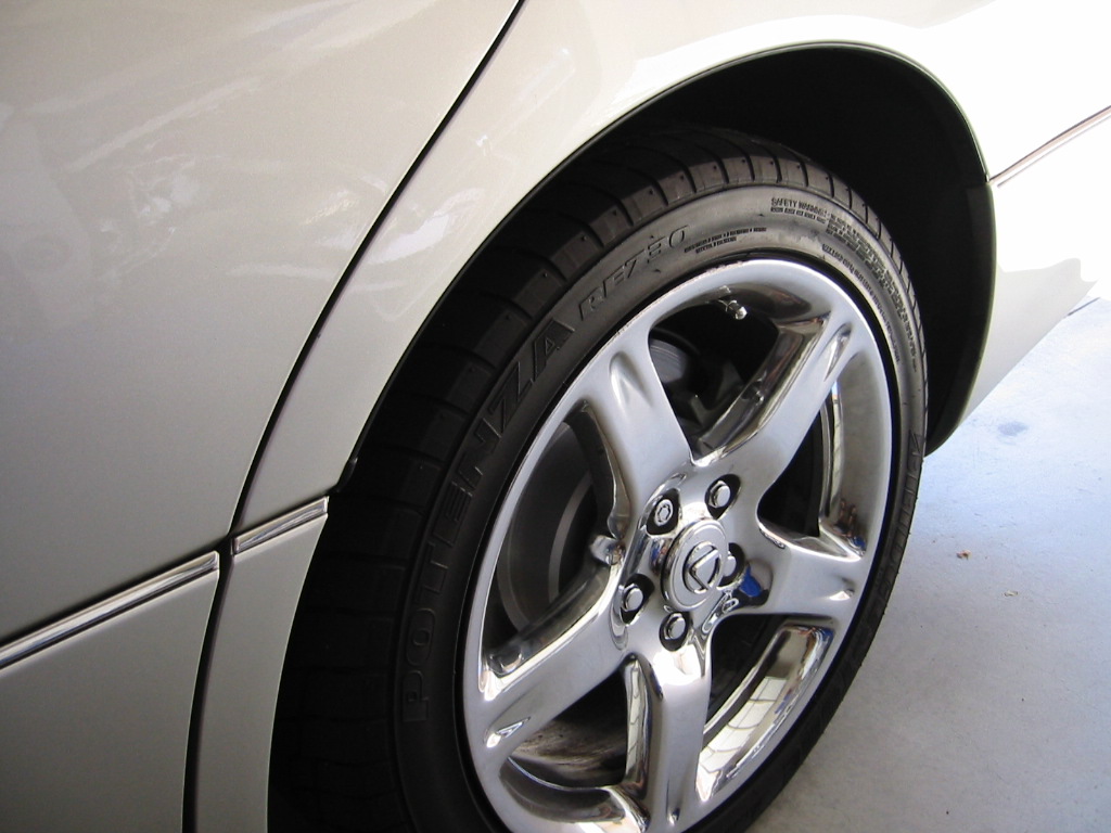

Here is a picture of my rims with the cross drilled/slotted rotors and painted calipers.
