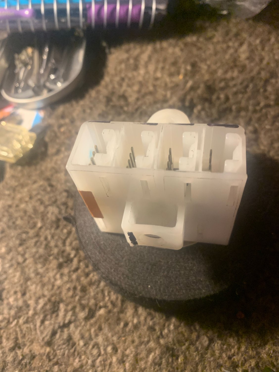

Hello, I am in need of guidance please! Does anybody have any idea what the red circled white plastic box is/purpose?
It is attached to the inside of the top of the dashboard, in the middle, a little behind the ac vents (once you pop out the vents, you can see this box) . The wiring harness that runs within the dashboard connects to it with 6 'connectors'. 3 in the front and 3 in the back of the white plastic box. If you have a part number that would help a lot too !
I cannot seem to find ANYTHING about this. Please help!

Well, while swapping my dash to a black one, dumb me threw away the previous dash without checking I had taken everything off that was needed for the next one... but I have learned that it is some sort of junction box. I have a solution for it now but feeling very stupid for doing that!! Lol

I pulled the donor dash last night, it wasn’t to bad excpt my hands are mangled from trying to reach up behind the damn thing and discovering there is a lot of sharp metal waiting to get some dna from me. I have that little box thet you were asking about. I will post some pics later today, umif you still want to know what it is

Sharp metal?? I didn't experience that.. I wonder what you may have touched. Also, i figured out it was a junction box! You can still post the photo incase anyone curious who may see this thread

Ya, it’s just a Union or something to make it easy to deal with the wiring harness. I already did my headliner. It takes some skill to do it right you still want get the Sun visors, overhead console, grab handles etc everything from your donor vehicle that can’t be recovered. I would also suggest getting the headliner material that doesn’t have the foam backing. The thinner it is, the better you’ll like it.
