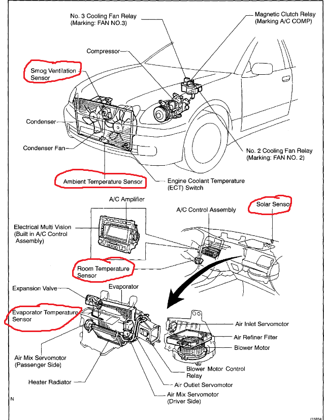

So this is a pure guess but my guess is that it's one of the temp sensors are bad and hot temps is causing it to send bad data. It might be the inside temp sensor but I know there is an outside temp sensor too.
My thinking with this is that over a certain temperature the sensor just doesn't work at all or is sending bad data so the computer is just shutting itself down.
The other thing it could be is the pressure sensor for the system is bad and it's shutting off because it's reading the pressure is too high.

Thank you, this definitely all seems plausible. I think the outside/ambient air temp sensor is okay because the reading of the outside temp displayed on the dash is accurate. But maybe I'm off the mark there.
Do you know if the inside temp sensor is the little slatted box beneath the ignition? Or is it the black dome near the passenger side windshield?

so a couple things, if it was low on refrigerant, then it leaked out from somewhere. Did the shop say the pressure was still correct when you took it in the second time? Or did he just look start looking for signs of where the dye leaked out? The outside air temp can effect the refrigerant pressure , sovif got low again, that might explain why the compressor started engaging after the car had been sitting. There is a cabin temp sensor in the dash by the drivers right knee. The lower section of the dash comes off pretty easily. The sensor can get full of crap, and keep it from working. So start there. In my car the compressor started making some crunchy noises, and as it got older the noise got worse, and it performed about the way your describing yours. I had to replace the compressor cause the clutch was worn out and stopped engaging when the temp was hottest and the refrigerant pressure would be its highest, so the compressor wasn't able to cycle correctly.
Check the dash semsor and get the refrigerant pressure checked again, please keep this thread updated to help the next guy with the same problem. Good luck

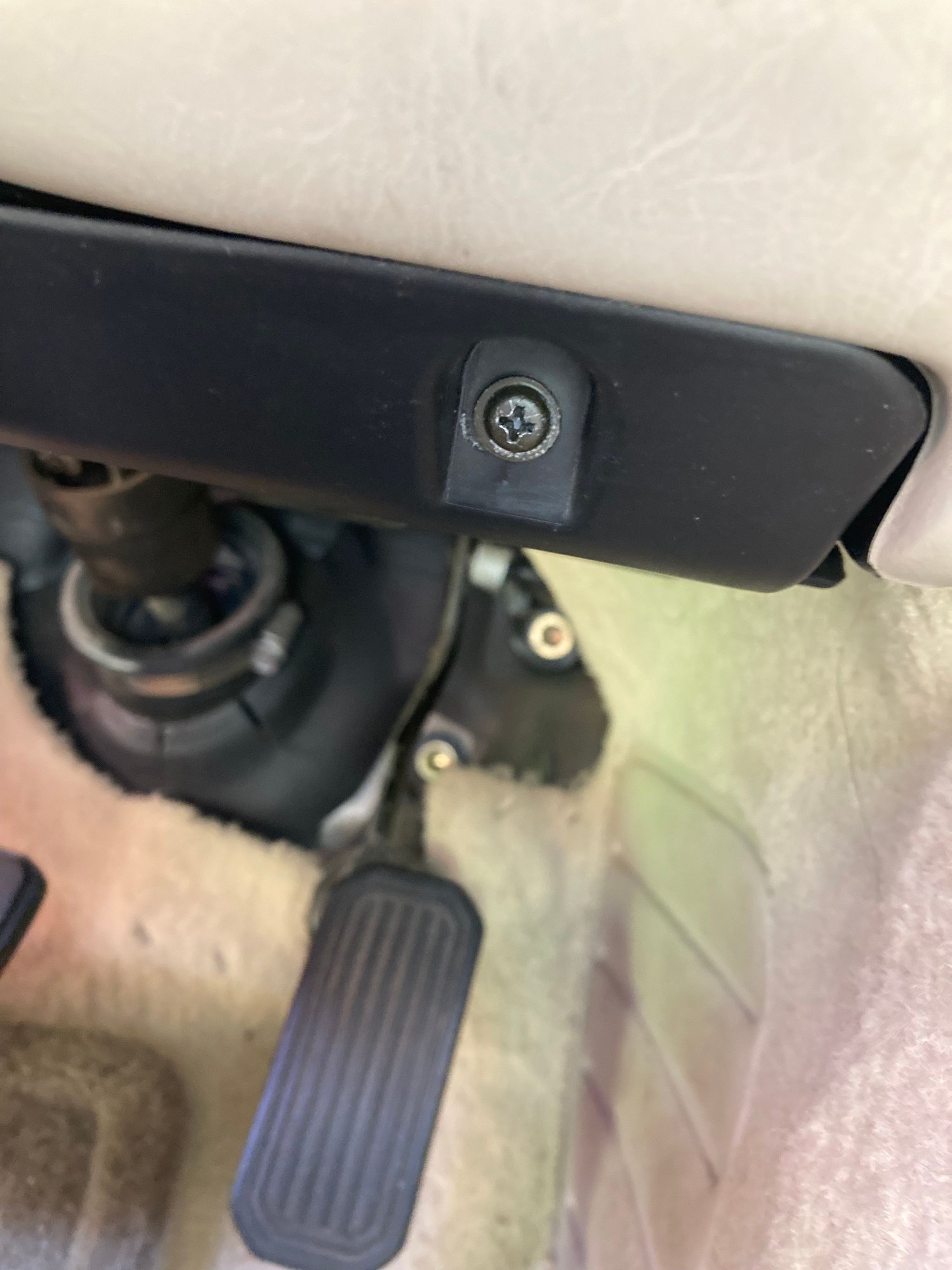

Thanks dwoods, I really appreciate the advice. I have an update: after taking out the cabin temp sensor, cleaning it, and putting it back in, the AC is now working. Because of the intermittent nature of my problem, I'm hesitant to believe its fully fixed. But it would be amazing if this ends up being what it needed. Here's a more detailed explanation of my process for cleaning the sensor:
Taking the lower section off of the dash is indeed pretty easy. I only had to remove these 2 screws and depress the 2 tabs on the left side and in the center of the cover.

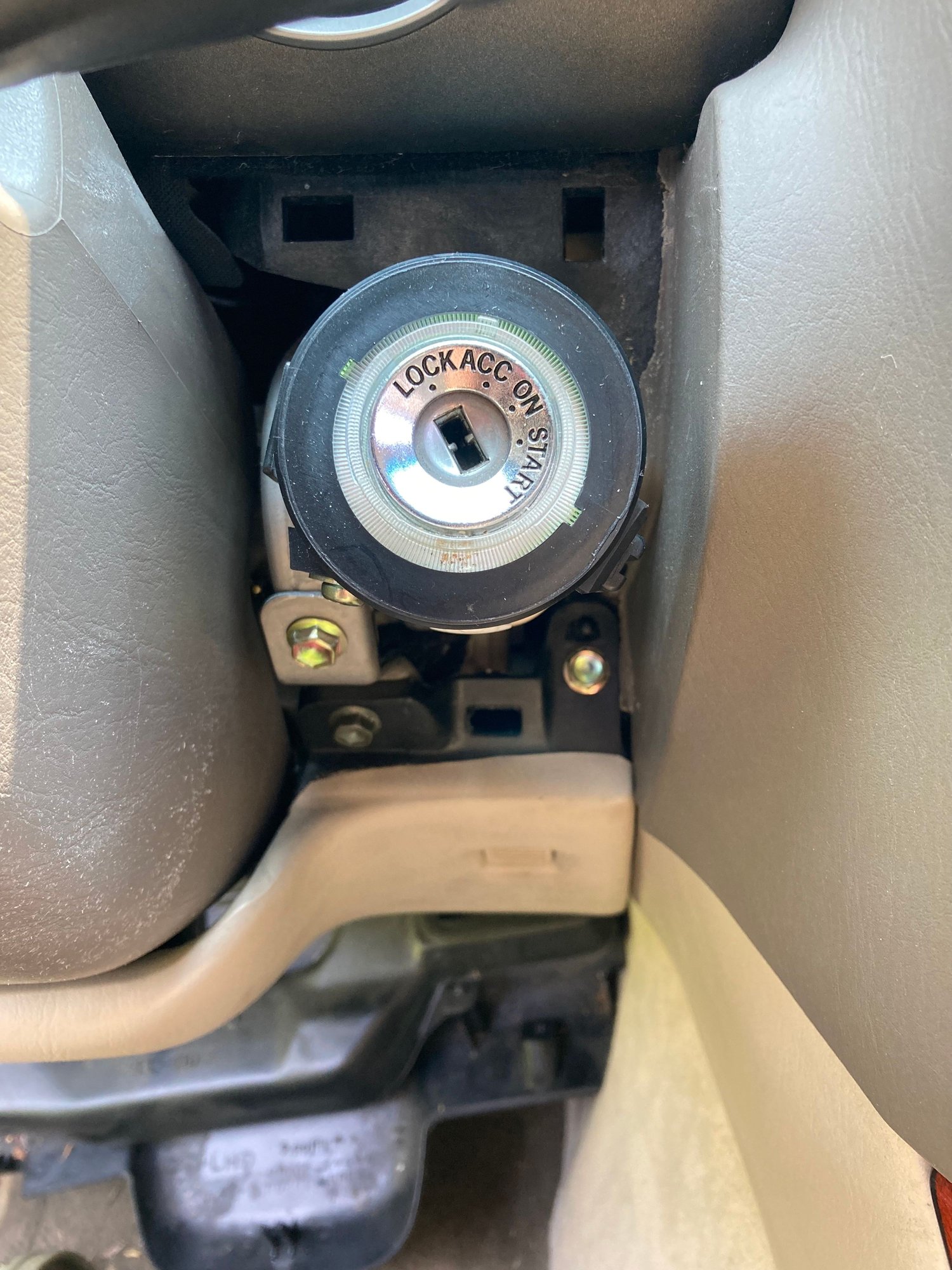

Once that was off, I had to remove the ignition cover to reveal 3 of the necessary bolts to fully remove the lower dash cover. I used a stiff butter knife with a thin rag around it. There are 2 clips on the top and 1 on the bottom. I had to be careful, but it came off pretty easily.
