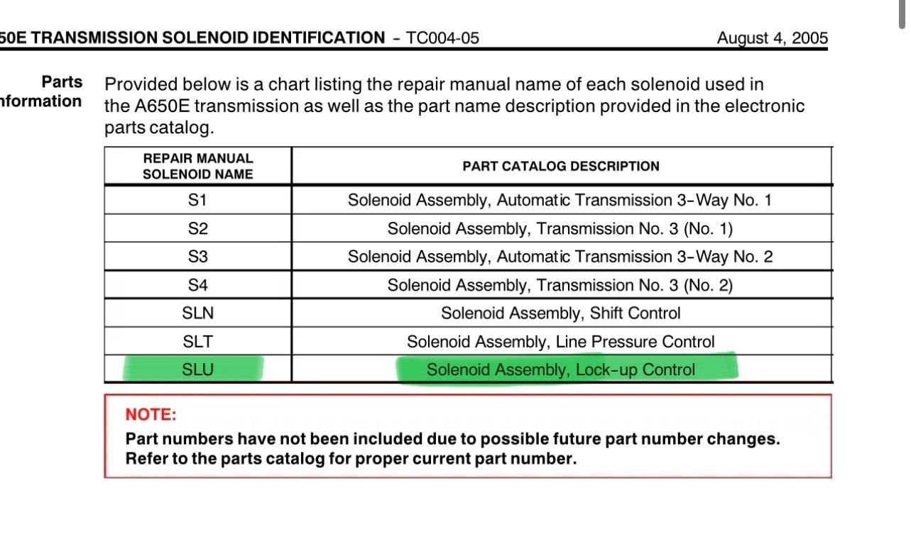

Need this solenoid for my transmission but can’t seem to find it anywhere. Anyone have a part number or link to purchase?
Below is the solenoid location (circled green) and description (highlighted green)

Pretty sure this is the part number 3528030040. What's happening with your transmission that you need to replace it?
https://www.lexuspartsnow.com/parts/lexus-solenoid-assy-lock-up-control~35280-30040.html
I edited the post to include a link and what I believe is the right part number.

Drive or reverse doesn’t engage, unless I rev it up a bit an then it catches, also shifting from 1st to 2nd is harsh, feels almost as if the the transmission slips, and if I’m in 2nd it does feel like it’s slipping but after it’s hot it works fine, adding aswell the shifts are really only smooth under light throttle.
scanned the car and I get malfunction on solenoid a and solenoid e, so that’s where I thought might need to replace.
