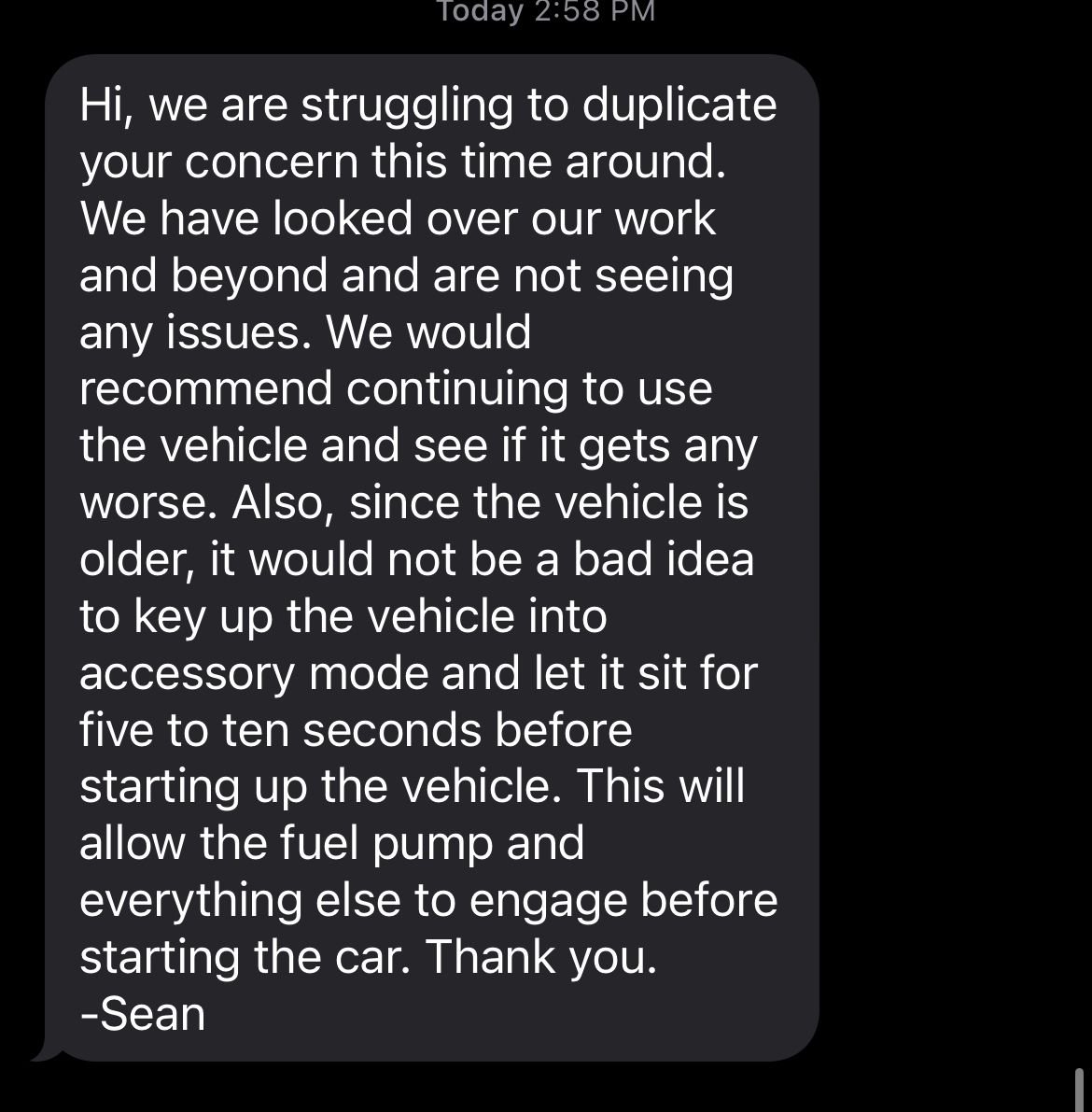

I got this car about 6 months ago with no information on its maintenance record or anything. I did some light maintenance on the suspension and was bringing it in for regular maintenance and checks. But I recently ran into a a starting issue. Basically, when i turn the key in the ignition it has a slow turnover/ hesitation to start. It hasn't misfired on me and only does this about half the time. Im really at a loss as I don't know much about cars myself so i took it to the mechanic right away and they did an electrical as well and general diagnostic check. They told me it was my fuel pump regulator so I agreed for them to replace it. 800 dollars later my car is having the same issue… I brought it back and they agreed to double check it for free and told me that they could not find the problem. Im a college student and i will be driving cross country to college in two weeks (1,500 miles) so I dont have the time or budget to keep guessing and fixing until i get it right. Please help!!
