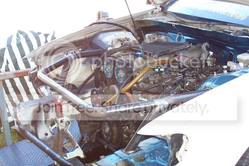

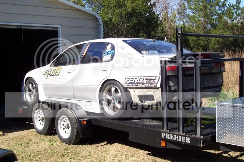

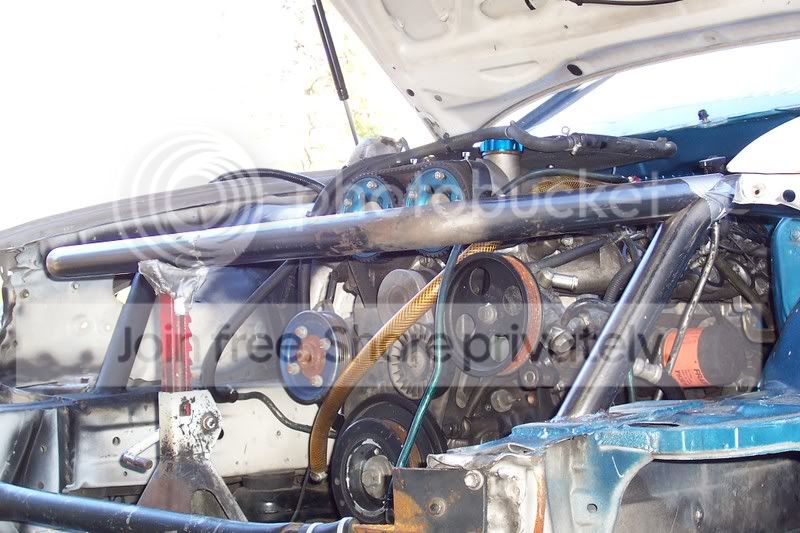

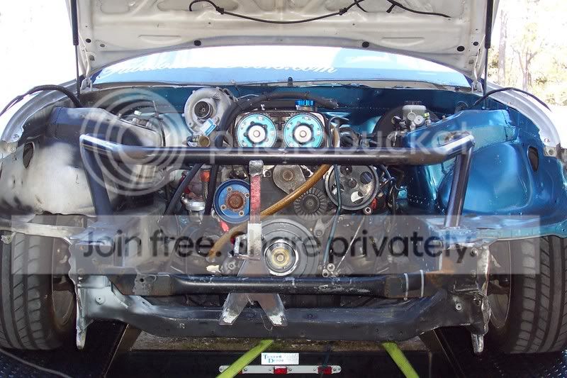

The weather cooperated today so I dragged the GS to Ferd's house this morning and we came up with this..
The headlights, hoodpins and intercooler will all be based off that tubular front bar in the next few days.
