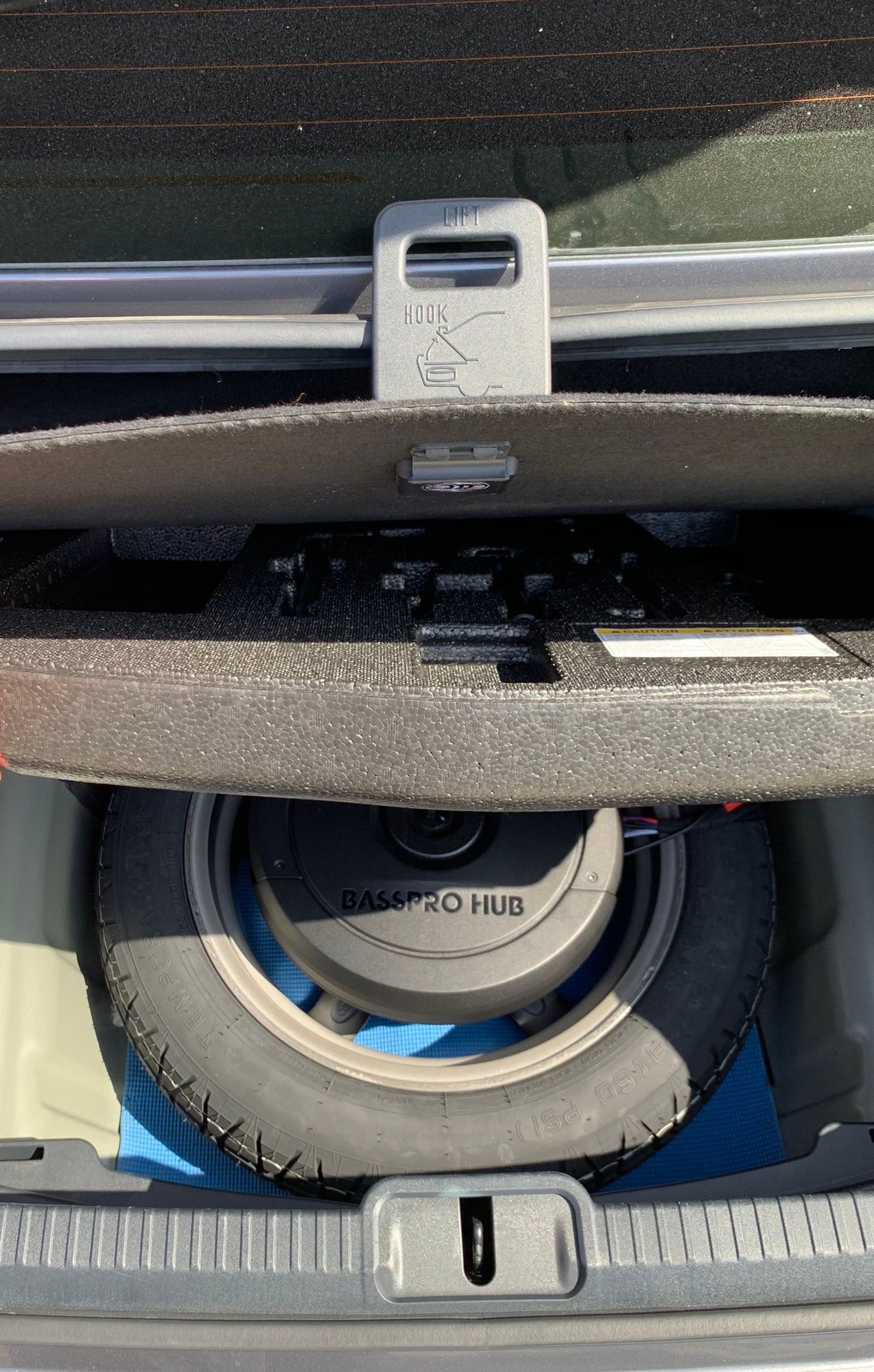

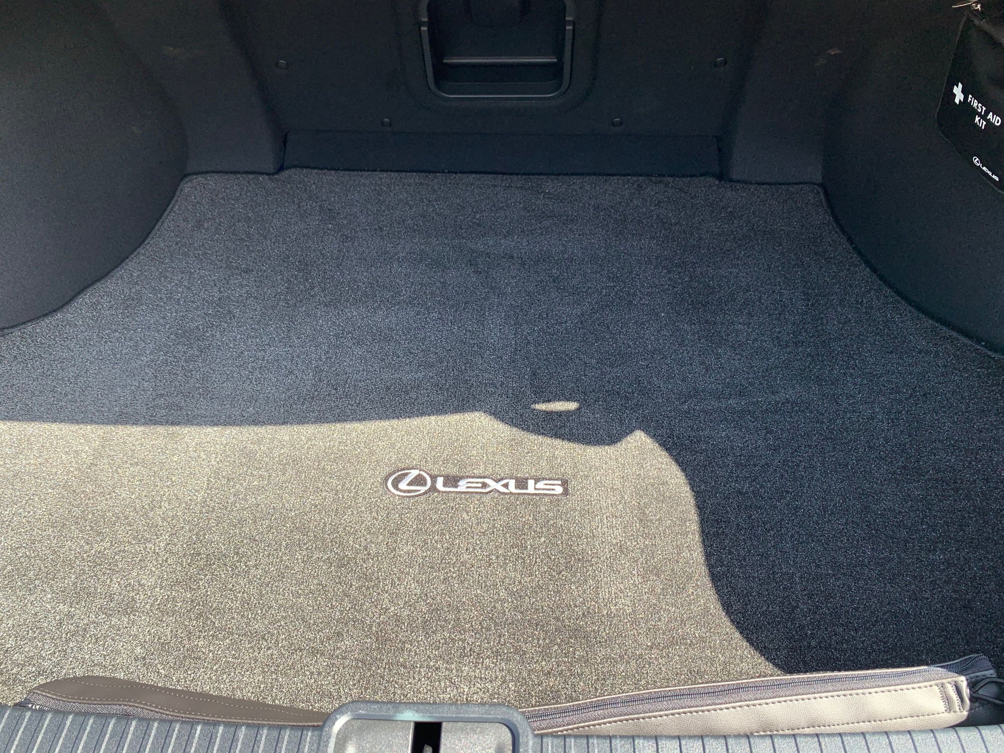

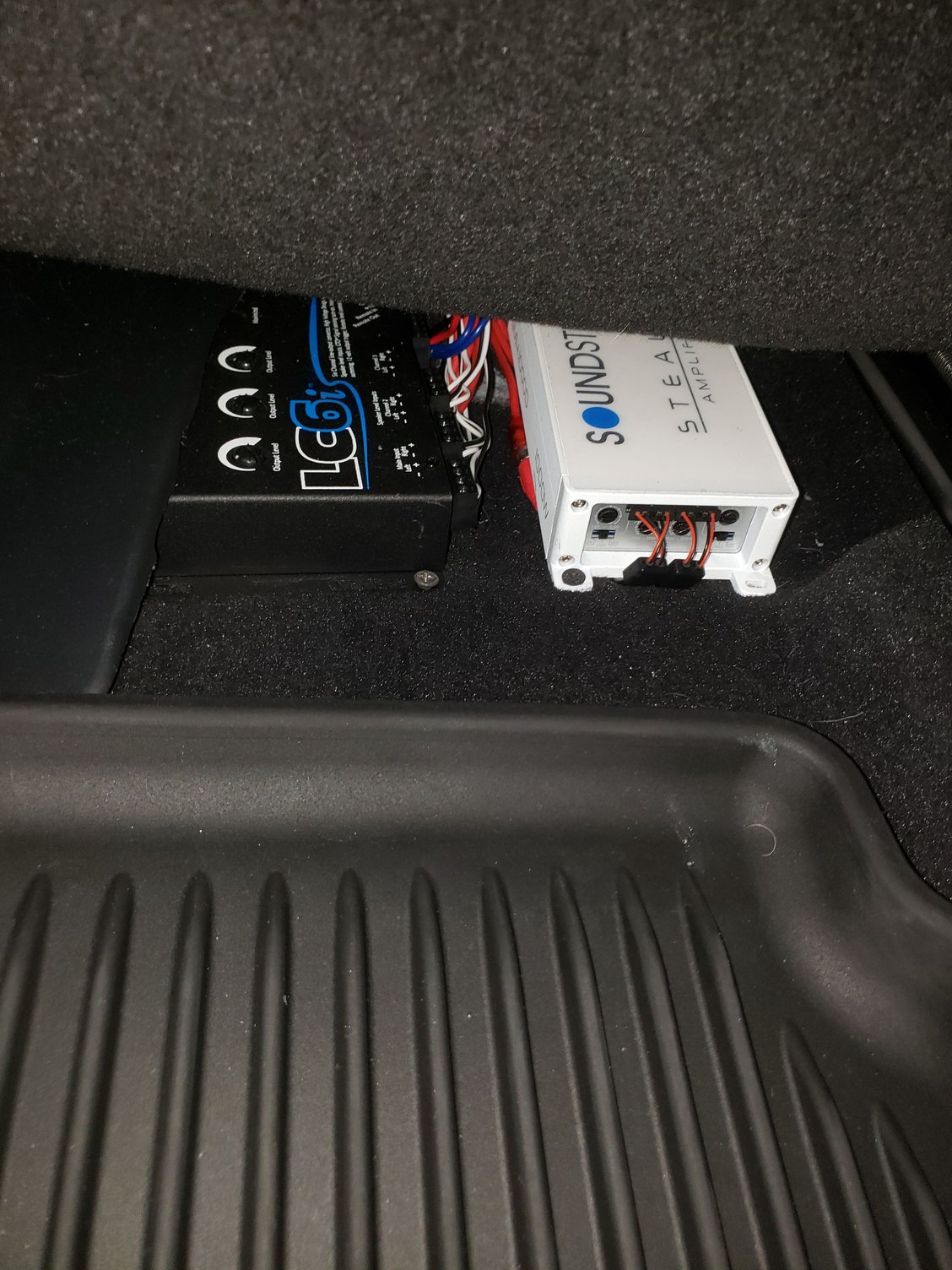

How to fix or change the cheap and awful sound system in the 2019 Lexus ES350? You don't pay the dealer extra $1,600 for a Mark Levinson Audio upgrade because you're still gonna have a garbage sound system. From the factory audio you just can't hear enough bass and just not enough sound from the rear. It doesn't matter how much you try to adjust the fader, bass or volume, you're stuck hearing little or no bass but only the soft mids and highs from the rear. This makes you feel like all the sounds are flat, incomplete and they're all coming from the front of the dashboard. It's a big design flaw from Lexus of just putting a tiny 3.5 inch mid range speaker on each of the rear doors whether you have the base audio or Mark Levinson audio upgrade. The factory woofer in the rear doesn't produce any significant bass and is almost useless.
I was able to resolve this problem by installing a spare tire mount powered subwoofer from JBL (BassPro Hub) using Audio Control (LC2i) line output converter by tapping into the factory radio's front door speaker wires. A discreet setup which doesn't sacrifice any trunk space. Now my factory audio sound much much richer and fuller and complete with tight bass. Highly recommended if you own 2019 or newer Lexus ES to correct the audio problem. IMHO I don't think there is any better solution than this.
Powered Sub by JBL (BassPro Hub) https://www.jbl.com/car-subwoofers/JBL+BASSPRO+HUB.html
Line Out Converter by AudioControl (Lc2i) https://www.audiocontrol.com/car-aud...-upgrade/lc2i/
Lc2i mounted under the driver's seat next to the facotry amp.
Powered sub-woofer mounted in the spare tire. You would have to flip the spare tire upside down to fit the sub and shave off the bottom of the jack tool foam holder to fit flush.

You think the factory ML system is garbage and has no bass, but you install that piece of trash and pass it along as an upgrade? And you complain about the ML price, which is $900 not $1600, but you'll spend $560 on a subwoofer that equates to one of Andre the Giant's farts? That JBL and the factory sub are nearly the same size, but the JBL being shallow mount means there is no suspension travel. Probably has an Xmax of 4mm LOL. JBL even knows it's terrible which is why they don't even publish the woofer T/S specs.
You'd be FAR better off installing a small sub in the trunk for half the price. They have subs that take up such little volume wouldn't even miss the space, but would actually give you bass.

I've never heard of people complaining there's not enough bass in the ES until now...how does pumping out more bass increase treble and mids volume for the back passengers?

The problem is factory amp no good regardless of versions. We had two versions installed from dealer and still only had 20% output. We installed AudioControl 6 channel line out converter to control what the factory couldn't, Sub/800 watt amp with base **** control and motorcycle amp for Factory speakers. All installed under seats after factory amp so nothing removed. It sound unbelievable we have total control of sound now. Bose quality

I'm so sorry if I offended you, Andre the wise guy. I appreciate your 'expert' advice but I rather have a full trunk space and be discreet about the upgrade. I wasn't complaining about the ML Price. I just googled the price and got that figure. Good for you if you got your ML for $900 and are content with the ML sound. By the way my total cost for the upgrade was $230. ($180 for the powered sub and $50 for the Lc2i.)
