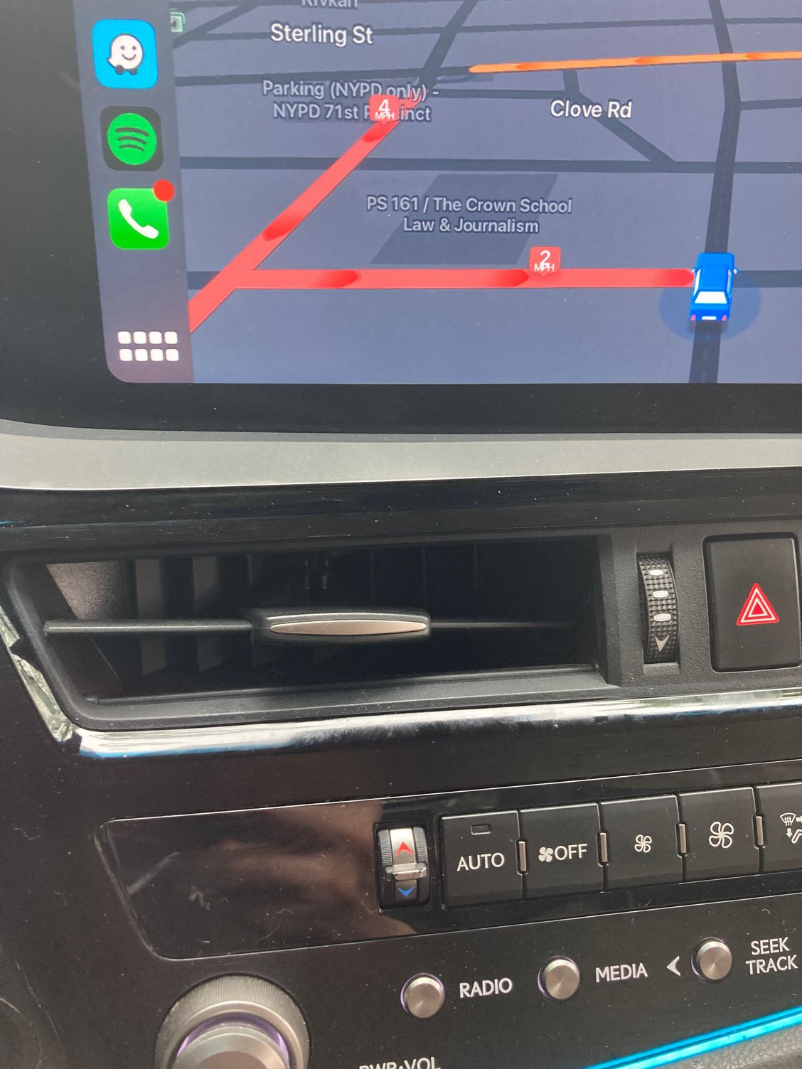

just got a broken ac vent after the car wash but I didn’t noticed until a few days later . Plus like a dummy I use a heavy *** vent mount on the piece on it was a matter of time anyways
( I’ll just glue it back if it’s a whole center console removed to install the that piece)
I never go to car washes but it’s been the whole winter with no wash so I went f it just to get most of the dirt off and just wash the car myself at the DYI gas station washer pressure.!
I have my personal extension brush and my Xxl microfiber cloth to dry it
I just don’t want to burn out that motor since I’ll probably drive it till the wheels come off since the next gen is not for me or just drive my s class so I’ll just find someone outside the dealer since I have have no time to sit and wait for those jerks.!!
I will
Drive side ac vents broken on my side and the clips is like a size of a pencil lead cheap car markers!!
post a pic of the vet. Hopefully there’s a way to fix it without going through so much trouble. Many thanks again.

Most likely you must remove the whole thing to fix it. The pin broke or snapped out?
Old Jun 11, 2025 | 05:40 AM
Mrbungle11's Avatar
Mrbungle11
Joined: Aug 2020
Posts: 442
Likes: 56
From: Ny
That little thing is broken .!!
The side toars the hazards are double while toars the cluster is single.!!
even if it’s under warranty I don’t feel comfortable from they removing the whole center console and radio .!
I guess I’ll just use I think it’s called e6000 or something and call it a day.!!! A type of clear glue or something
