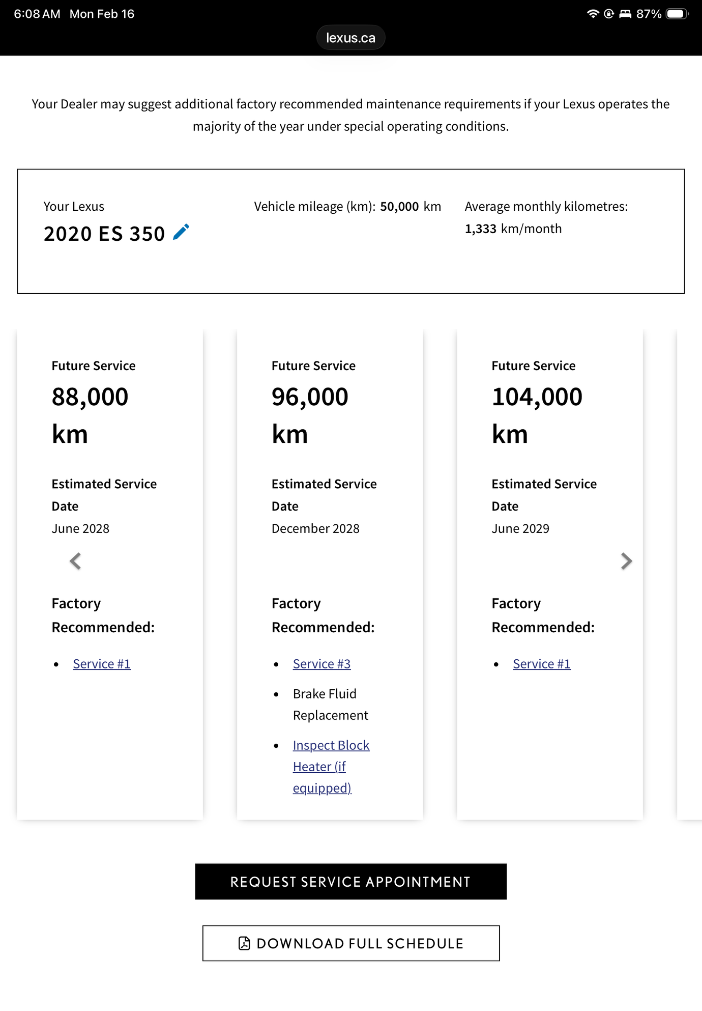

Just going to throw this out there…the Gen 7 ES 350 maintenance schedule is to change the plugs at 60,000 miles / 6 years, right? Well…maybe. The Lexus Canada schedule is to change the plugs at 192,000 km (120,000 miles) / 12 years. So, why the difference? Can’t be the machinery, same car, same engine, from the same factory. Some kind of weird, government mandate? The only explanation I can think of. Sceptical? Here are the maintenance checklists from the Lexus.ca website.
96,000 km/6 years:
And…the “Service 3” details
See? No spark plugs there. Now the 192,000 km schedule:
There they are! Documented.

I guess the difference must be the difference in mileage for the warantee; This is what is in my manual:
Roughly translates to 50,000 miles and 80,000. I’ve never once heard of a problem with this system, neither here or in any other forum. Sounds to me like gambling..,pay $X hundred now to avoid the slim (negligeable) chance you may have to pay $Y hundred later. It used to be that only BC and Ontario mandated regular testing but BC dropped that mandate. Alberta and Quebec proposed legislation for testing but it failed to pass. So, if no testing required then “who is to know”?
I guess that answers the question on the difference in the recommendation.
