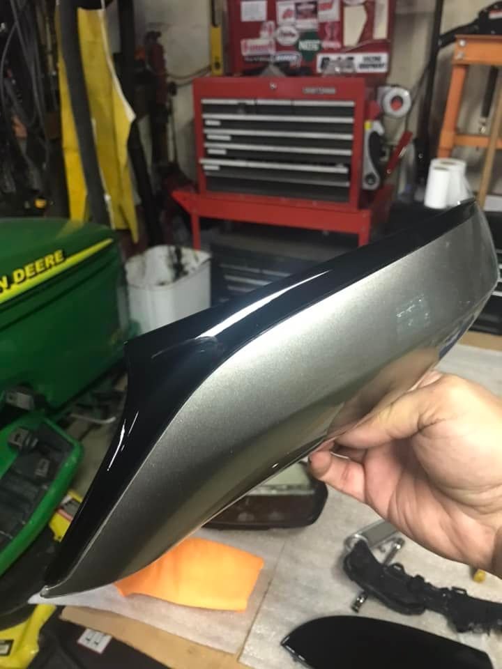

I dont have any pictures of the whole car as the PAS side parts are curing overnight. But here is what I have so far..
