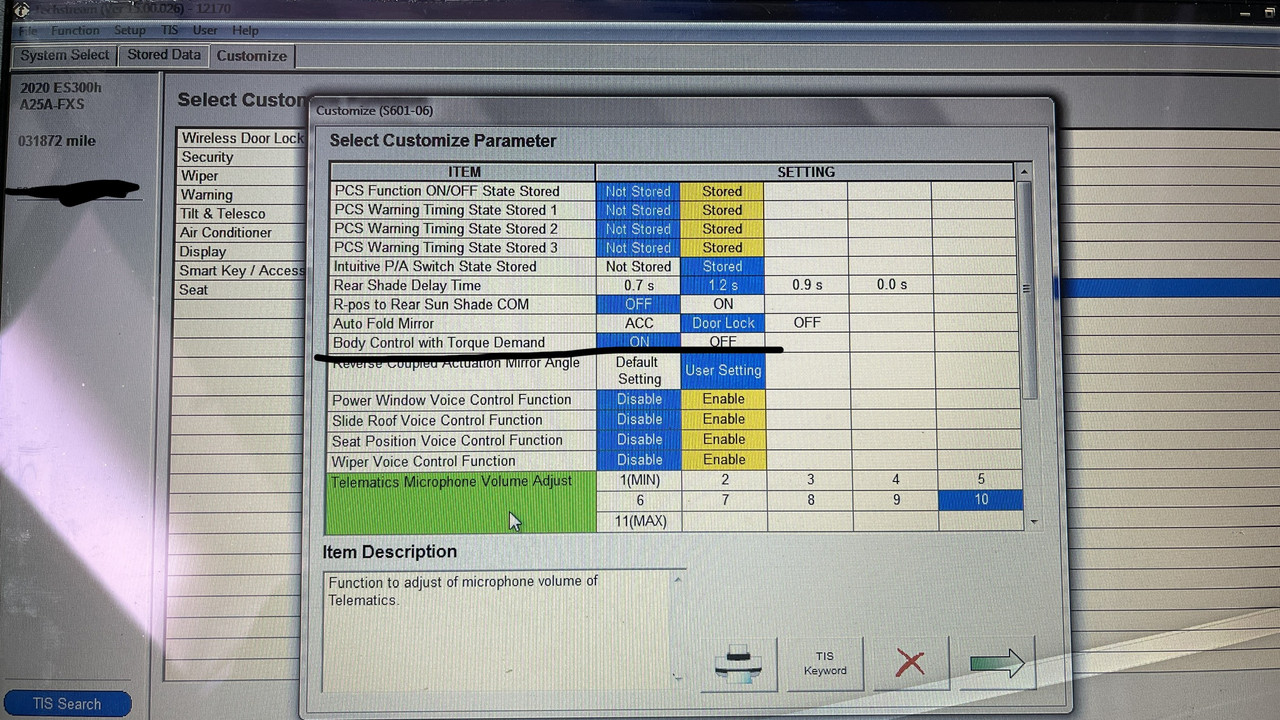

What it is?
This function uses wheel speed sensor information to establish when the nose of the vehicle is either lifted or lowered by road surface undulations. When the nose is lifted, this causes the heads of vehicle occupants to tilt backwards. The system momentarily reduces engine torque to compensate, reducing occupant head movement. When the vehicle nose dips, occupants’ heads are tilted forwards, and the system adds torque to compensate in a similar manner.
If you want more punch during take off, less lag (i4 and V6) then disable this function.
It can be disabled via Techstream or Carista.

Originally Posted by BBQapple
I wonder if Sport mode reduces or removes this effect.
That I don't know but I would say yes, at least a little.
However the above doesn’t seem to imply this is during takeoff, but rather it’s applied once underway. It’s not super clear.
Everytime.
