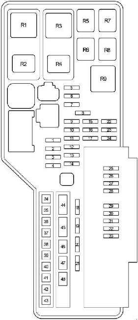

The relay is under to hood, driver side fuse box.

maybe this will help

Which of the relays is the one for the high beam headlights?

Thanks for the diagram. I checked these fuses. They are OK. I even tried swapping in the spare one in the fuse box cover to make sure. Nothing new happened. So none of those relays in the fuse box is associated with the headlights? Maybe it doesn't have one? I guess I will buy a new bulb and try it in each side. I guess that will tell me something. I have had some flickering of the headlights prior to these going out. It occurred for a long time. I do not see any breaks in the wiring leading to the lights.
