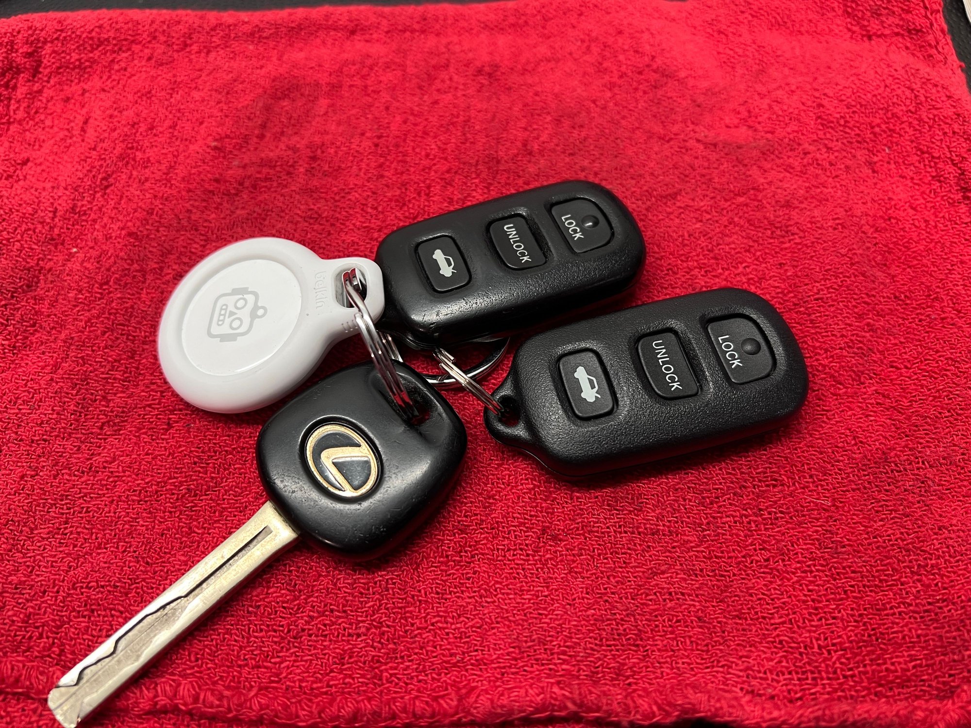

Added a new genuine Lexus key fob - same issue with the range. I can get maybe 30-40ft depending on the angle between the car and the fob.
This is what I ordered 89742-33100
