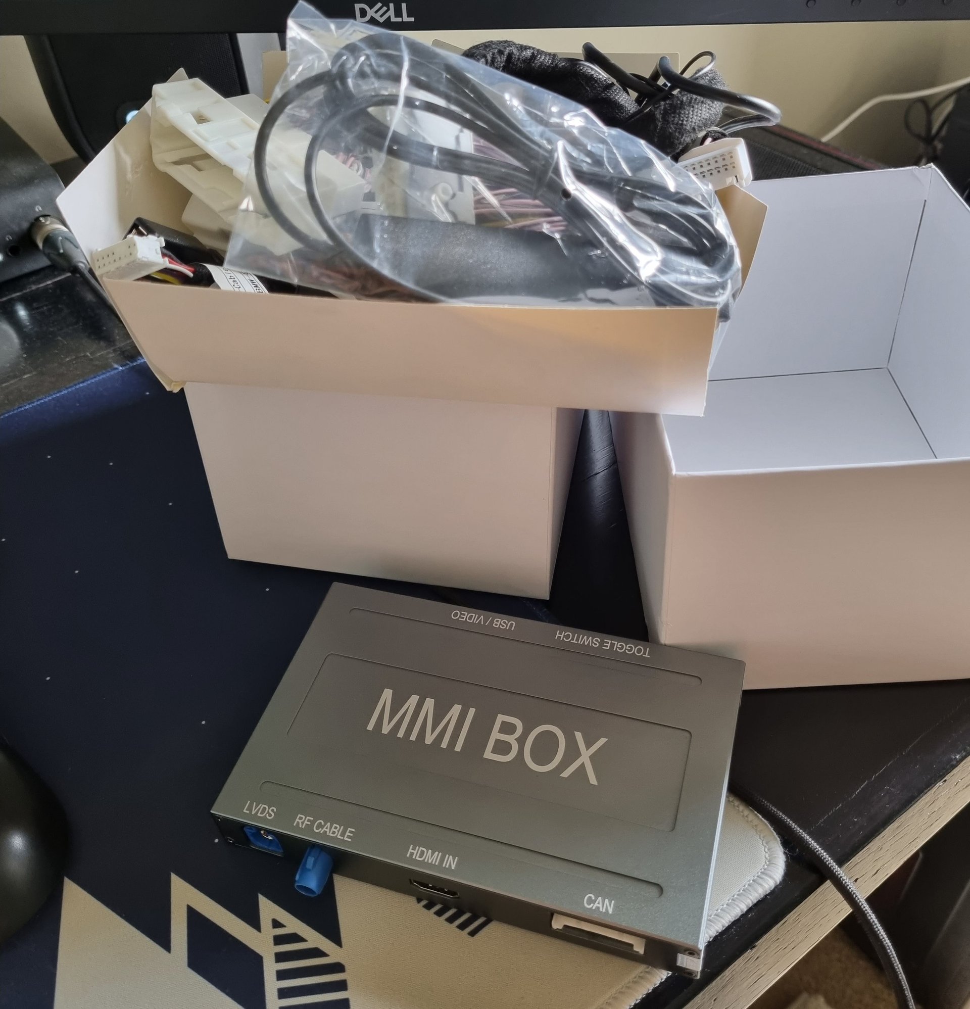

Andream MMI box came in a week or 2:
Came with a cable harness for USB + custom front/rev cameras, one for the display, one for the radio unit + power, one for the wireless antenna, and two CAN power cables for alternative setups to mine (I just needed the radio + power one).

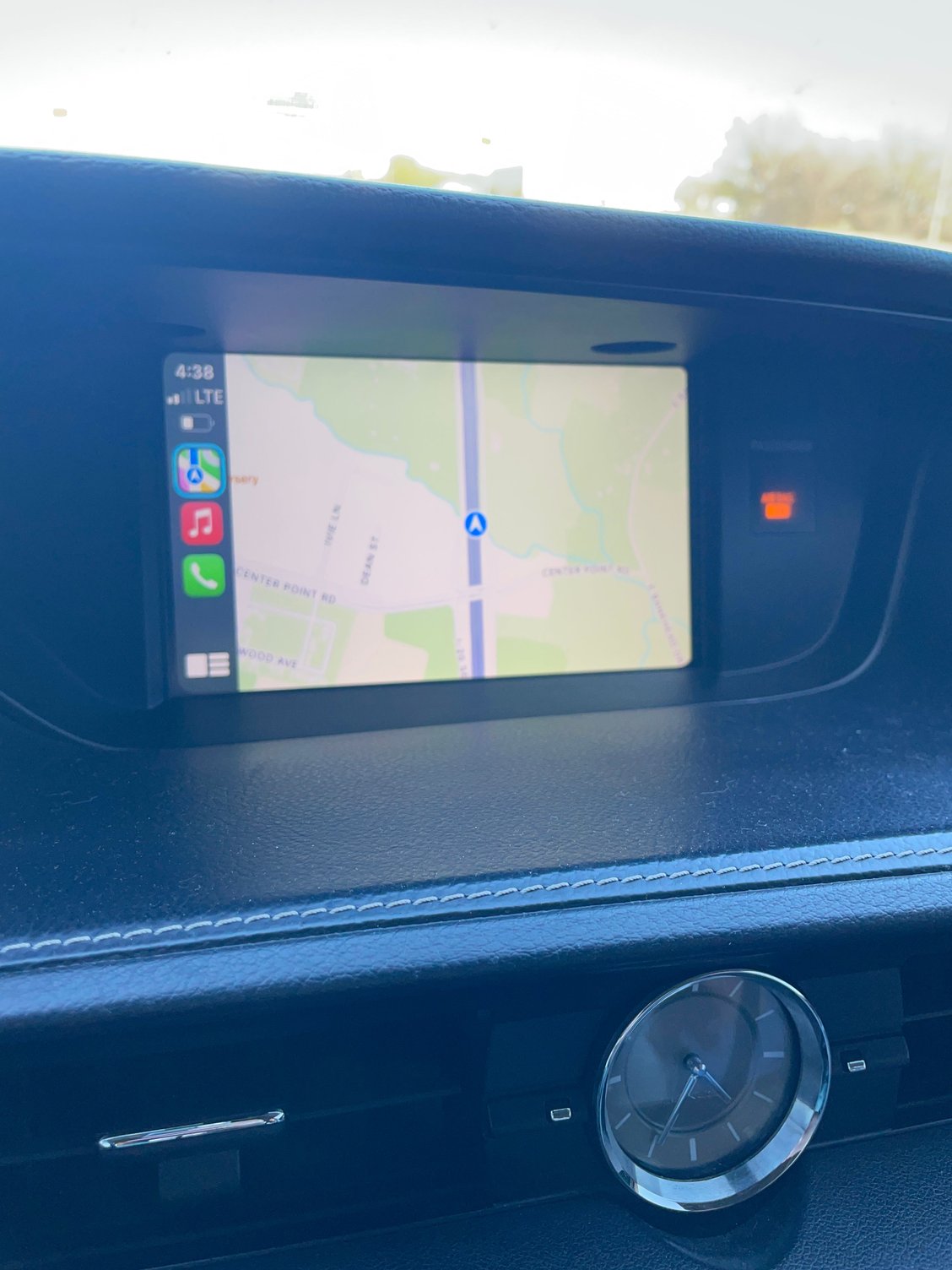

Such a super easy install! Thanks for the help mxblue!
I started the install 1.5 hours before we were supposed to leave for vacation and finished with 10 minutes to spare!
the only issue I had was the flashing screen and that was a quick 5 minute fix.
I will post some pics when I get back into town.

Would love to to see more photos of the interface.

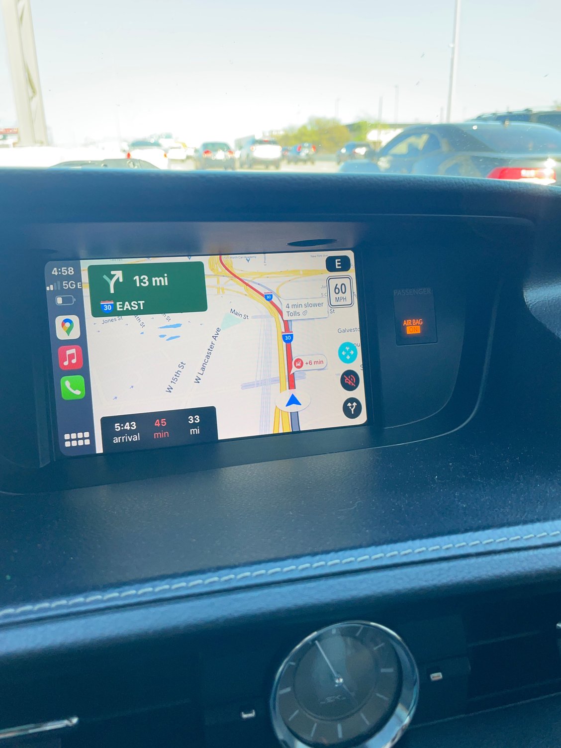

what do you need to see? Here are some pics of various apps:

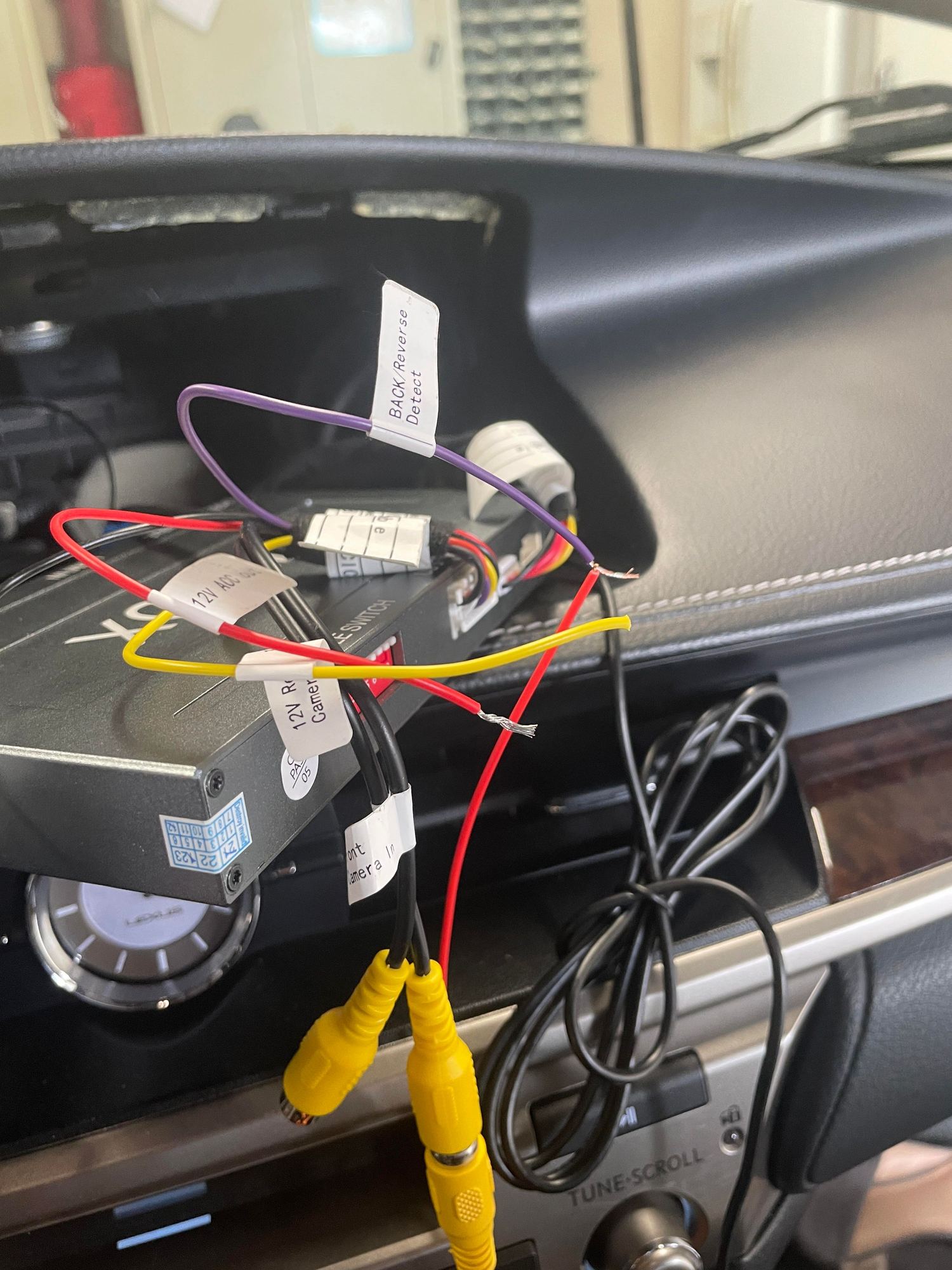

Question for MXBlue (or any other technical folk)
I have had this module installed and working great for Apple CarPlay and iphone integration. No regrets there.
However, I am trying to incorporate a front camera and its not working the way i want it to. I have been discussing back and forth with the Andream support, but the language barrier is such that we arent getting far.
I have the front camera working, but the issue is that you have to go into the menu on the Andream unit and select camera instead of it just coming on when I power the switch. See video
These are the connections on the Andream module:
-12v ACC (red) power to the camera
-Ground (black)
- CVBS in for front camera - video in
-CVBS in for rear camera - video in
-12v rear camera (yellow) - unused
- BACK/reverse detect (purple)
I have tried to utilize the rear camera input and the purple wire to trigger the module, however, it does not work correctly. It came on for a second and then goes back off. I am thinking it has something to do with the fact that i utilize the factory back-up camera, but im not sure.
Any other ideas you gurus can think of that i can try to make this thing work with the switch?
