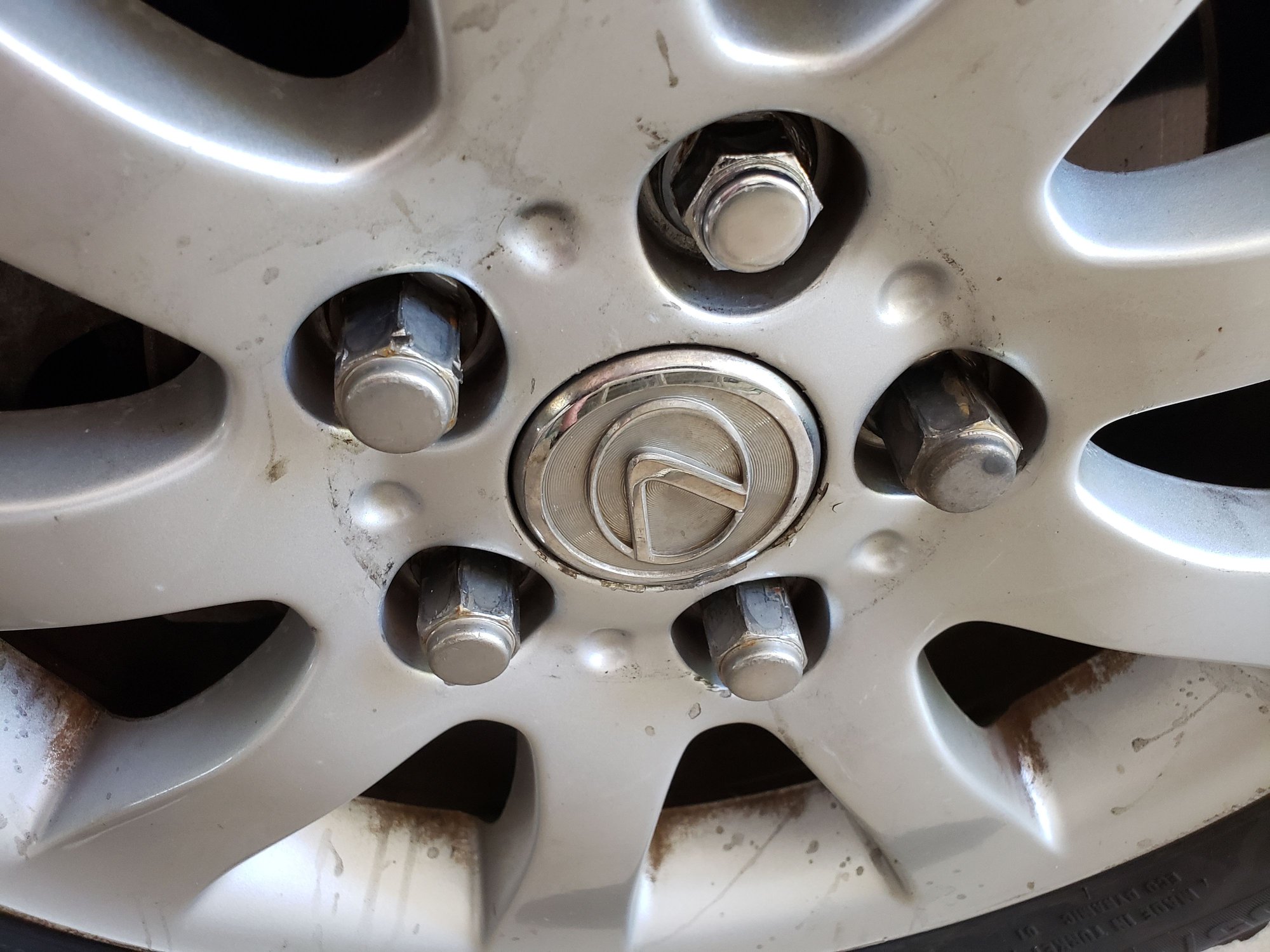

My new to me 98 es300 came with these wheels 17" first pic. The ride was terrible so I went down to the 16"from an 03 second pic. What lug nuts do I order? The ones on the 17s are to dang long and stick out and look well yuk 3rd pic
. Would an acorn type lug work?

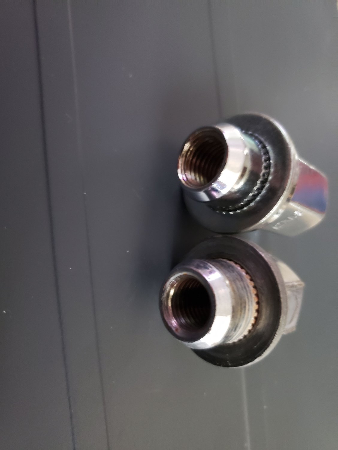

Hey guy's a few more pictures. The shorter lug is from my 2015 Prius. It looks to be the exact same size but the outside is not as long. I put it on the es300 they seem to fit. I mean same threads same depth that screws in. What do ya think? I went to AutoZone today explained I wanted shorter lugz so the outside wouldn't stick so much out from the rim. He really didn't understand. I did have the old log thats to long. A few pics are attached. Let me know what your think. the lugs sticking out are from the 17 in Lexus wheels I believe from a 330 that were on the car when I bought it

Google 90942-01033 that's the correct lug nut for the wheel.

Thank you so much! Funny thing is that is the same part for my Prius! That makes me feel a lot better!
