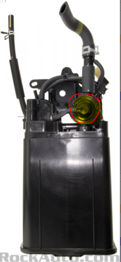

Thanks Oro but I believe that you have mistakenly given me the wrong information. This isnt the part that sits on the engine by the intake, this is underneath the car and connects directly into the charcoal canister. The dealer told me that the entire charcoal canister must be purchased at a whopping 385.00. I called my local O'Reilleys and they don't even show the part. Oh how I wish you were right. I got exited there for a second then life kicked in. I have attached a picture of the part at any rate.

No, the canister vent solenoid is in that picture above. it's to the left of what you circled. From mechanics I've talked to, that is the part that typically fails. You circled a purge valve - not usually the culprit but you can go underneath with a vacuum gauge and test them to see what is at fault.
The part in the engine pay is the vacuum switching valve AFAIK.
You can get take-off parts much more cheaply on ebay and recyclers. The valves are available separately.
I may jack up the car and crawl underneath on Tuesday when I am off work and test these components on my own car and see if I can post some better info then.
