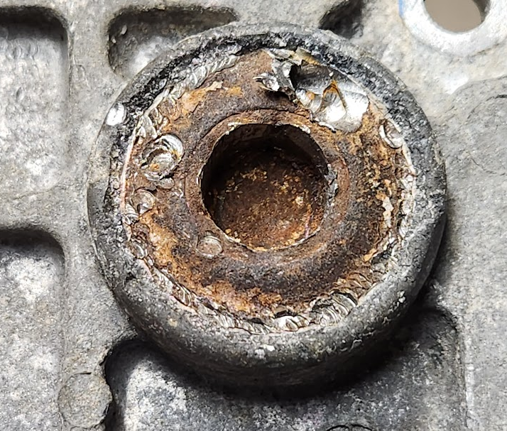

Successfully replaced the plate a few days ago - the plate comes with a drain plug already installed. Used
permatex ultra blue gasket maker permatex ultra blue gasket maker
and let it cure overnight. Then filled her up with fresh coolant - no leaks. Did not even need the Techstream as the coolant pump started right away with ignition.
Here is the old plate with a stuck drain plug. After the inner hex stripped I have also tried (unsuccessfully) to use an air hammer to drive it out - that is why it looks so mashed up.

Played with a milling machine today and carefully drilled out the old drain plug. Then resurfaced the plate so it can now accept the larger "outer hex" drain plug. I will keep the plate for the future as I have two cars with this transmission (ES300h and Rav4h) and may need to swap this plate again. The original and the "upgraded" drain plugs are shown for comparison.
