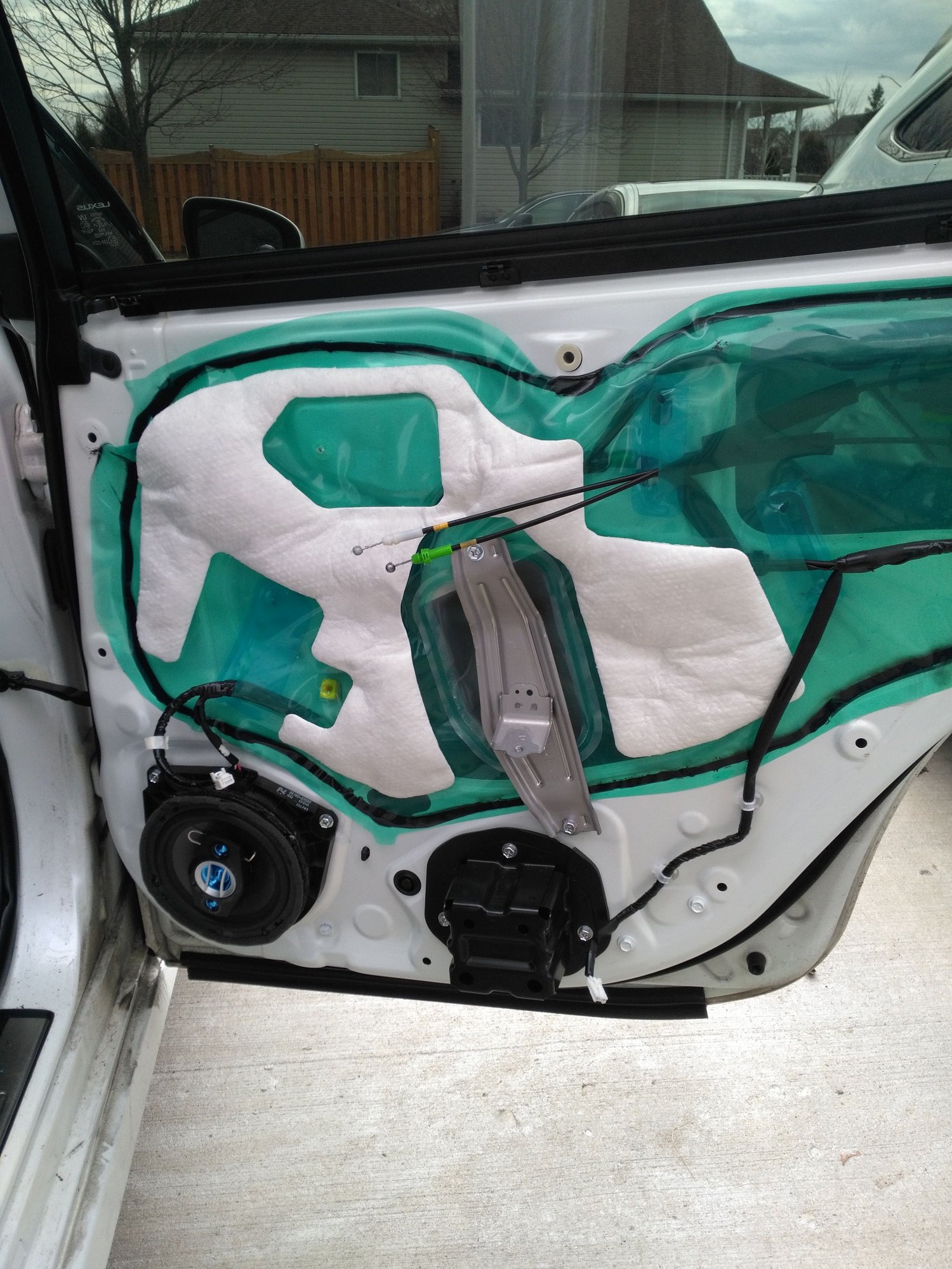

For the front speakers I was using special adapter and cable harnes from amazon.procedure was same .I don't want to describe how to remove door panel ,because it is very easy to do it.
This the part numbers of adapters for front speakers.
Picture of oem speaker in front door ,waiting to be removed .

Jbl 6 1/2 inch speaker in original adapter with harness from amazon ,great fit ,no foam gasket needed in my case.

This left over material was used to get a bit better sound.i didn't have a lot of it so I just used small pieces.
One small piece inside door ,speaker cavity.
The rest of them just used random location on the doors.
6x9 front speaker JBL installed.
Aluminum duckt tape used to close rest of gaps
Connector secured with tape.

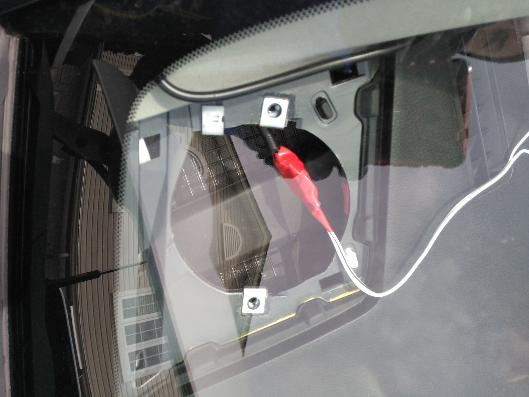

Yes after doors was done I have decided to go nuts on center speaker.
It was very tight fit .I did cut 2 bracket to fit in .
Center speaker only closeup.
Door panel assembly

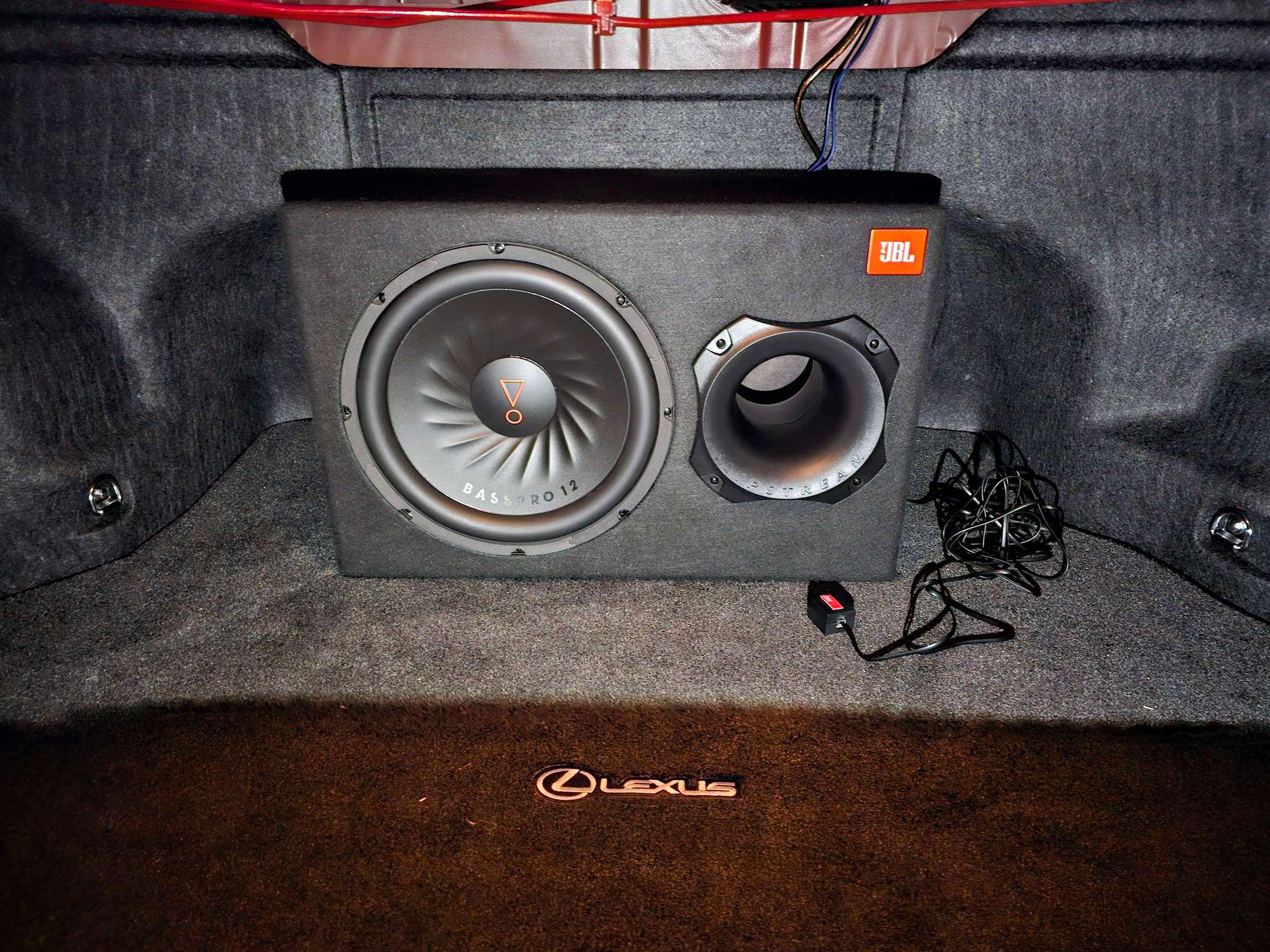

I added a JBL BassPro12 Powered Subwoofer to my '17 ES350 today. It is DEFINITELY more than enough and more than what I expected. It costed me $219.
I spliced into the factory subwoofer as this sub has high level inputs. I wired the power wire through a rubber grommet in the driver side footwell and through the inner scuff plates through the backing of the rear seat. I did not need to remove any rear seats or anything.
I'm finally happy with the audio in my ES350. I'm a youngin, but I never wanted brain rattling bass, just something to add to the low end. I keep the bass **** at around 30-40% and that is more than enough for me.
