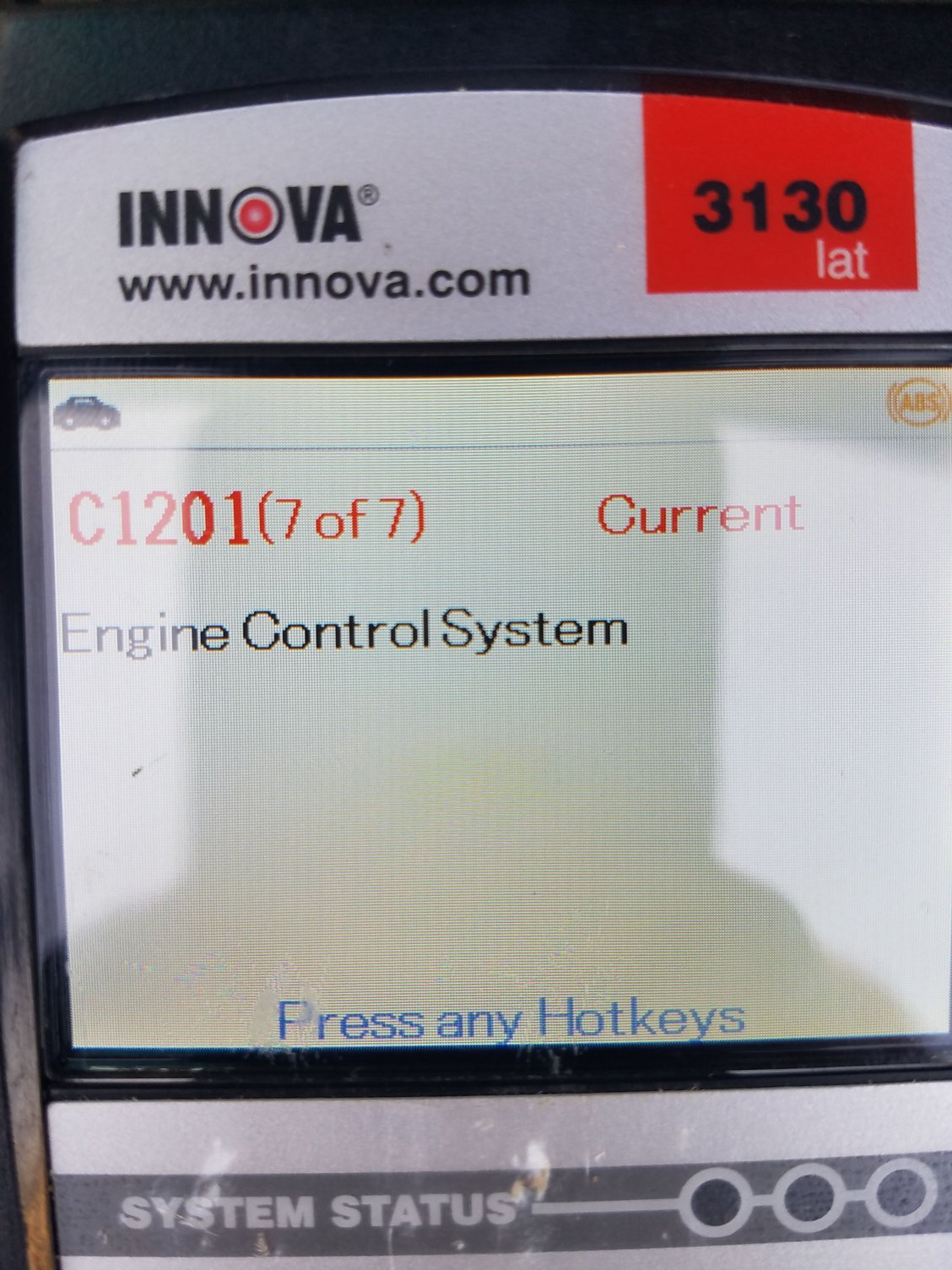

My abs light came on with a blinking "trac off" light. Took my car to auto zone and read the abs codes. Attached are pictures of the codes. Anyone had this problem? Anyone know any causes or fixes?

Ignore the last code, it's a red herring. First thing to do is get your battery checked out, get your alternator checked out, and clean battery terminals and grounds. If that doesn't solve the problem, expect to replace your ABS unit.

I just replaced my alternator and the code has been coming on less and less, so I'm hoping that was it!
