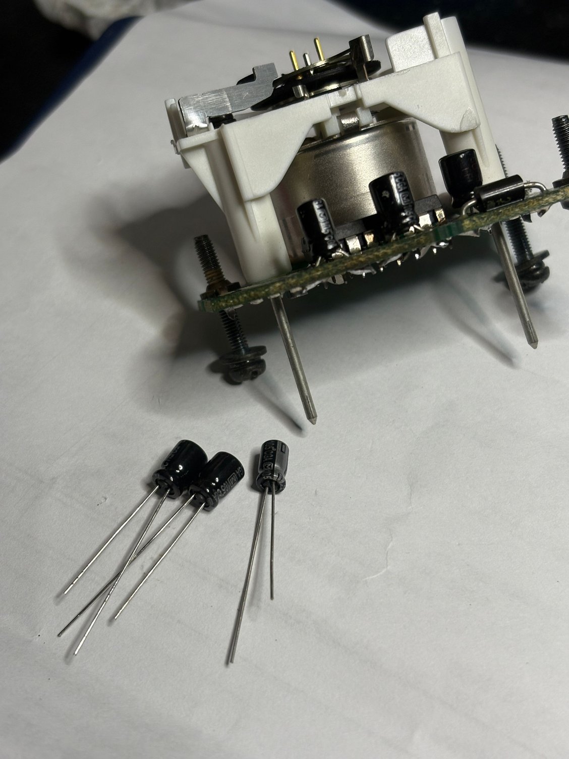

Default Capacitor replacement for bad speedo
96 es300 bad speedo
Jared,
I hadn't worked on my RPM motor, and if you do, get the board number and pass it along here. I would like to get the caps for that board, too.

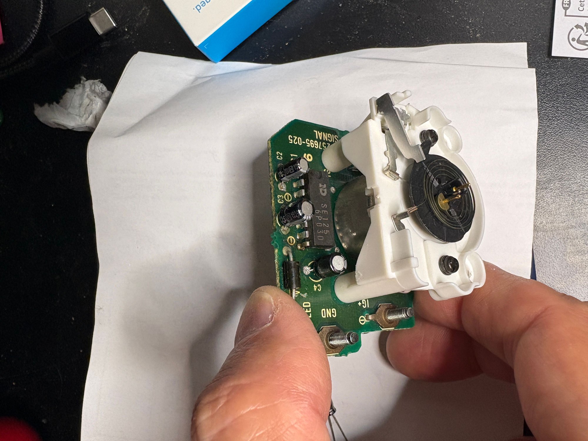

I just worked on my speedo which was showing +15mph at idle. Before it had this problem, the speedo and rpm needles were stuck occasionally, and I banged on the dash until they popped up and started working. I checked the RPM and speed on my OBD meter; the car was going the right speed and the tach was accurate, too. So, I knew that my VSS (vehicle speed sensor) was working properly. Also, these clusters are quite robust, except for these motors.
I took out my speedo motor and board from the cluster, and noticed some type of non-viscous fluid, maybe resin on the board right below a capacitor. I did searches and found that these speedo boards, 257695-025, had capacitors that leaked or just went bad. Also where I saw the slight liquid was underneath a capacitor that had, apparently, overheated because I couldn't read the specs on the side of the cap and the cap was discolored from navy blue to almost black.
I bought 3 new capacitors (see order receipt, below), took off the old ones and soldered new caps on. I had a spare, working motor which I swapped out and use in my current cluster. The speedo motor I repaired is a spare, but I'm not sure if I was successful in repairing it. I'll know when I install this fixed motor in the cluster at another time.
Here's one club lexus site with good images and the cap ratings: https://www.clublexus.com/forums/sc-...op-solved.html
Look at this link, above. It shows what caps go where; two 22uF caps are the same, 2 x 22uF and 1 x 6.8uF. The person in this link removed the motor, and that may be the best way to access the cap closest to the motor. I kept the motor on the board, but it was tricky in removing and adding the new one.
I bought the Panasonic caps with 1000 hrs at optimal conditions. Also, the 6.8uF cap is rated at 35V, which isn't a problem. The best electrolytic caps for these boards are the ones made in Japan by Nichicon which some online electronic stores showed they were avaiable. I don't know these stores, and I would like to purchase the Nichicon because of the perceived quality and rated for 2000 hrs, but I'm worried about counterfeit parts. So, I went for the sure thing.
I purchased the caps from DigiKey.
If you get fingerprints on the cluster black part, you can use some putty stuff for watches, Rodico, made by Bergeon, 6033-1. It's made for watches to remove fingerprint smudges on the watch face dial and back. It works on the face dials of the cluster, too. Just pull off a pinch and roll over the cluster or pat on it to remove fingerprints and smudges.
Hopefully, this helps. Be sure to NOT bend the speedo spring, but it can be readjusted if you do a little accidental bending. If you question your soldering skills, then find a person whom you can trust to do it correctly. It's worth paying a little extra to get it right the first time.
Best,
Byron
These two images show the new caps soldered into place. I bought two sets of caps, one for this motor and the second cap set for the current motor in my cluster when it goes bad.
