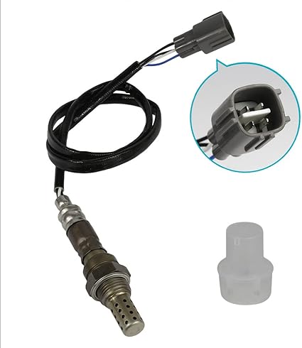

About P0135 - that is the code that you have to experience at some point, especially with older vehicles - it means that a Bank 1 Sensor 1 heater element is malfunctioning. It is really easy to test - just disconnect your sensor and measure the continuity between two black wires, if there is none, unfortunately you will have to replace the Oxygen Sensor, its part number is written on it.

The thing is that there are two elements to the Oxygen sensor - the sensing element and the heater coil that is wrapped around the sensor. O2 Sensor cannot function properly while cold, so it needs a heater to warm it up. That is exactly what your issue is - while the sensor is perfectly fine, your heater doesn't work, hence why it may need to be replaced.
About the readiness monitor - that is a good question, it should not be complete, but I don't think it will last long.
The easiest way to tell what is wrong is to measure the heater's continuity - if it's there, the sensor is working, if it's not, the sensor is toasted. Simple as that.

Did you press on the tab? They could sometimes cease together and require quite a bit of force to disconnect. Try taking a picture of your connector, there is enough room to do so.
As for the replacement - I wouldn't recommend running to dealer (or as it is commonly referred here as stealer), because it is way too expensive (I was charged $278.59 without tax for it). In the same manner, I would not recommend going with cheap eBay's OEM-ish parts (ask me how I know); I mean you can buy parts off of eBay, but you need to pay really close attention to the manufacturer graph in the ad - if you see an OEM box on photos, and the ad says that it was built by DENSO, or even worse, Unbranded, it is most likely a fluke and should be avoided at all costs.
I think the best solution will be to go with DENSO or NTK sensor - those are Toyota's OEM suppliers, and those are a fraction of the cost. Here are a few that should fit your car: NTK 24594, DENSO 234-4623; and just for kicks and giggles here is an OEM equivalent. There is no real difference between them, just pick one that you like better..
