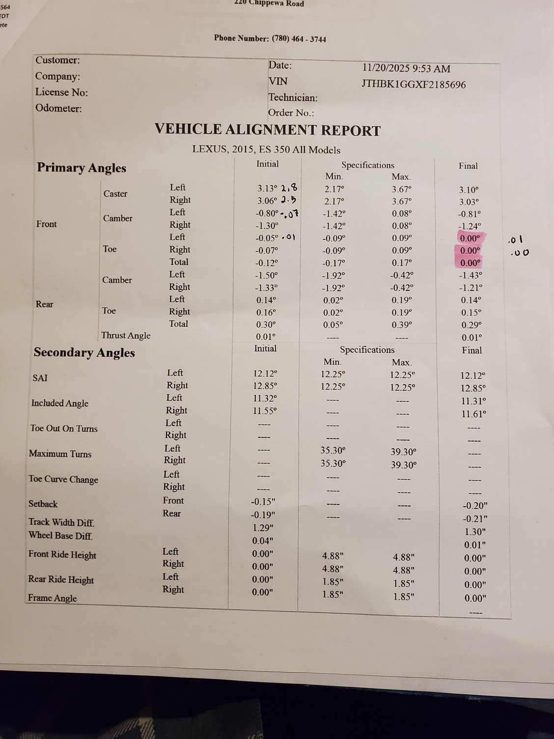

Car has a tendency to wander when driving. Very hard to drive. Feels like a pull or drift and it is not in only one direction. Consistentlycompensating while driving. It does drive straight but feels very vague like it is floatingaround on the road. Also I find the steeringwheel is very smooth to turn but if at any speedyou move the steering to say the right or leftfrom say 12 oclock to 2 oclock the car continues in that direction. It does not return to center. I also do get torque steer from the front from the last alignment from Lexus.
I have had 3 different sets of wheels and tires on the car. All the same. algnment from Kal tire and it tend to pitch when driving ( felt like the rear left was passing me). Now with recent alignment from lexus it pulls right and backfeels like it going right and drifts everywhere. Lexus says everything is perfect cant find anything wrong. Tires all at 6/32 no weird wear.
Please help me. I hate this car yet i searchedlong and hard for a es350. Now I regret it.
First is Kal tire, 2nd is lexus, 3rd is lexus returnand check
