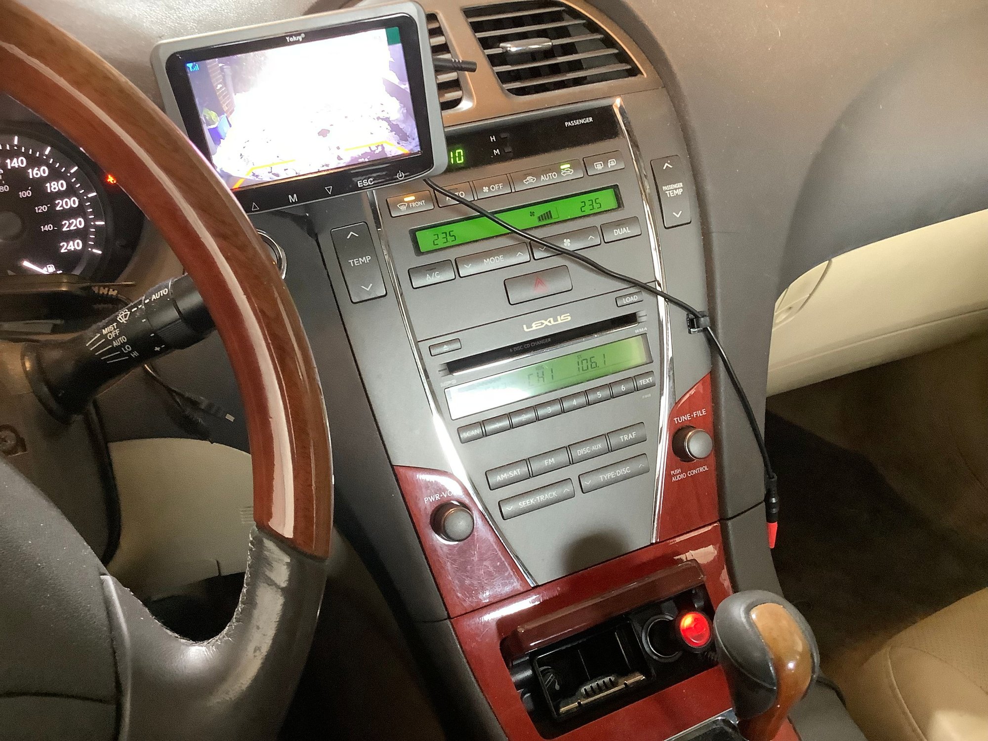

Years ago, I set up a GPS backup camera and this is the link to my installation then. I decided last year that I didn’t need the GPS and I wanted a better camera and I basically use the same install for my new camera and display as I did for my old one, and here’s the link to the new camera and display. .
Amazon Amazon
I really like it. It fits on the old pro clip mount I had, and fit where the old camera was no problem. I didn’t bother hard wiring it to fuse box because I liked the cigarettes lighter adapter they provided with the red led when on, despite the dangly wire. The image is crystal clear day and night and glare not a problem. This pic in garage does not do image justice with snow in driveway🙂
