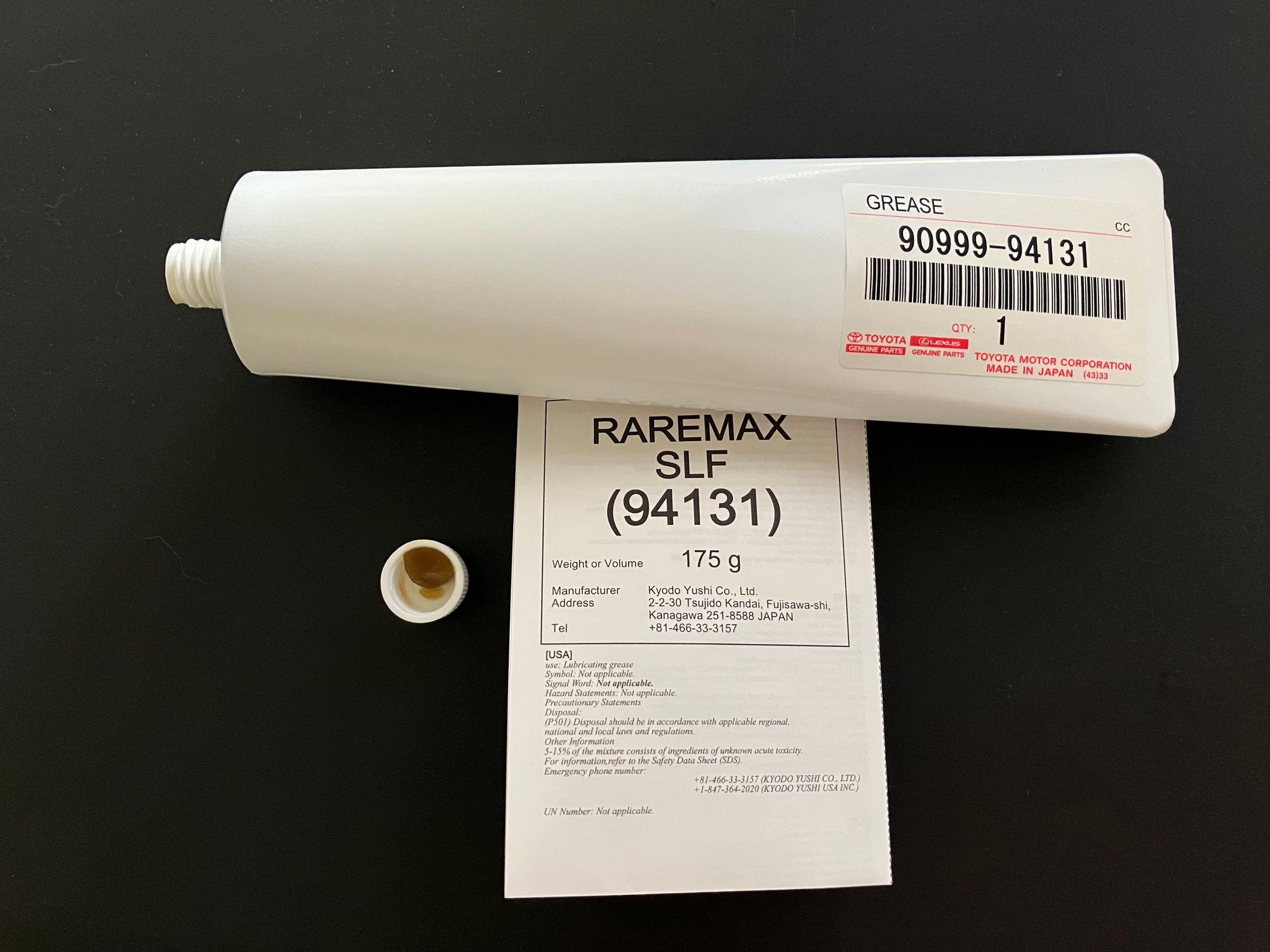

I purchased a Toyota/Lexus boot kit for the driver side of my car
04438-44051
It comes with two tubes of grease (outer and inner)
90999-94135. (205g)
90999-94131. (175g)
The Lexus Repair manual states the following
As for consistencies, -94135 feels like a sticky toothpaste, & -94131 feels thinner
90999-94135. (205g)
90999-94131. (175g)
- INSTALL OUTBOARD JOINT BOOT
- Pack boot with grease in the boot kit.
- Grease capacity:
- 205 − 215 g (7.2 − 7.6 oz.)
- INSTALL INBOARD JOINT BOOT
- Pack front axle inboard joint boot with grease in the boot kit.
- Grease capacity:
- 185 − 195 g (6.5 − 6.9 oz)
