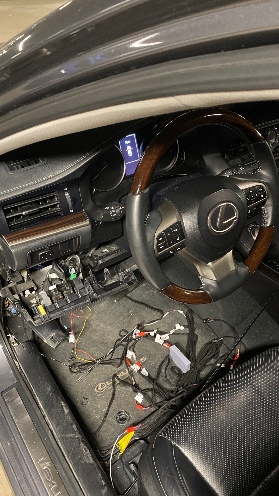

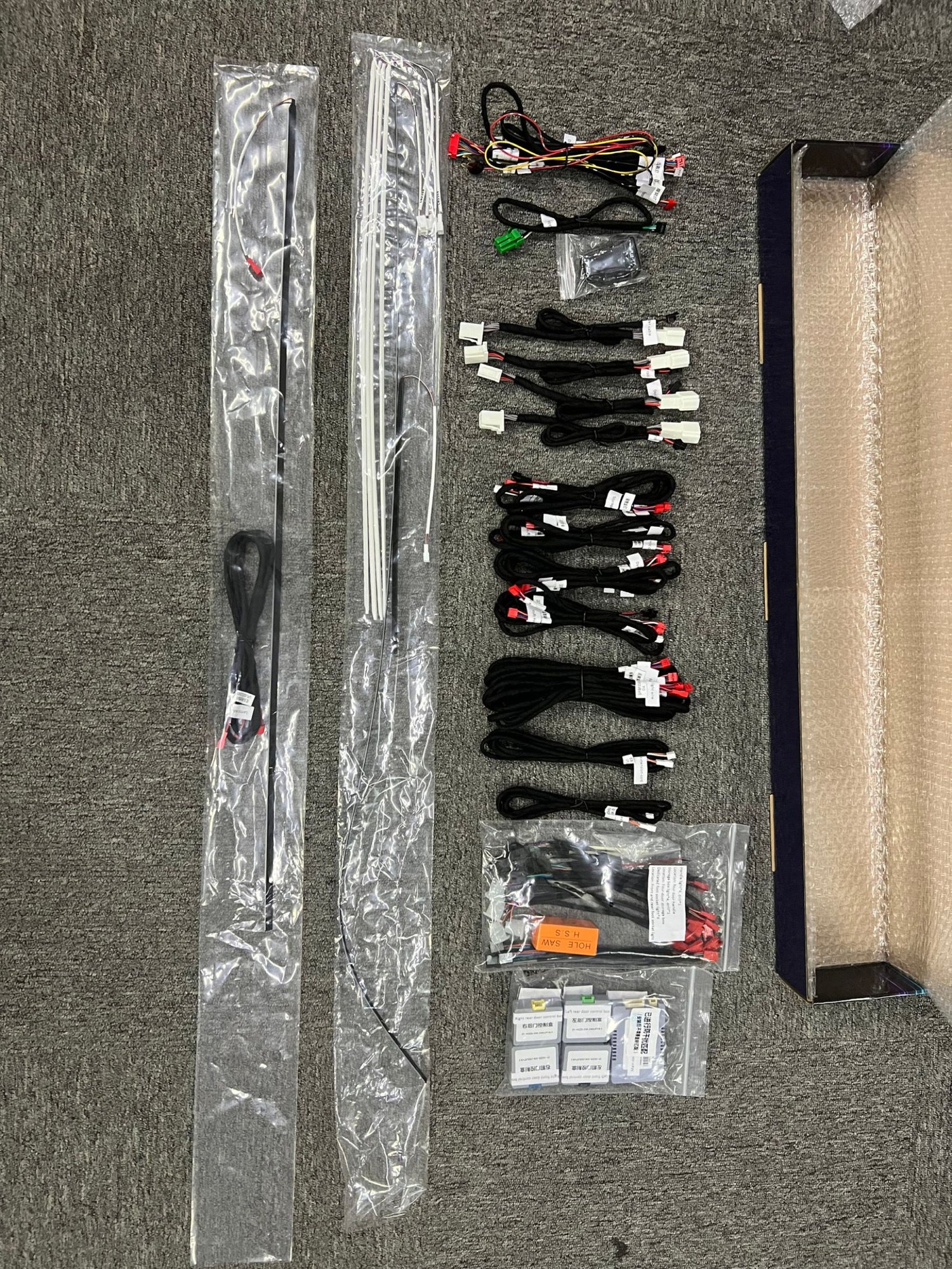

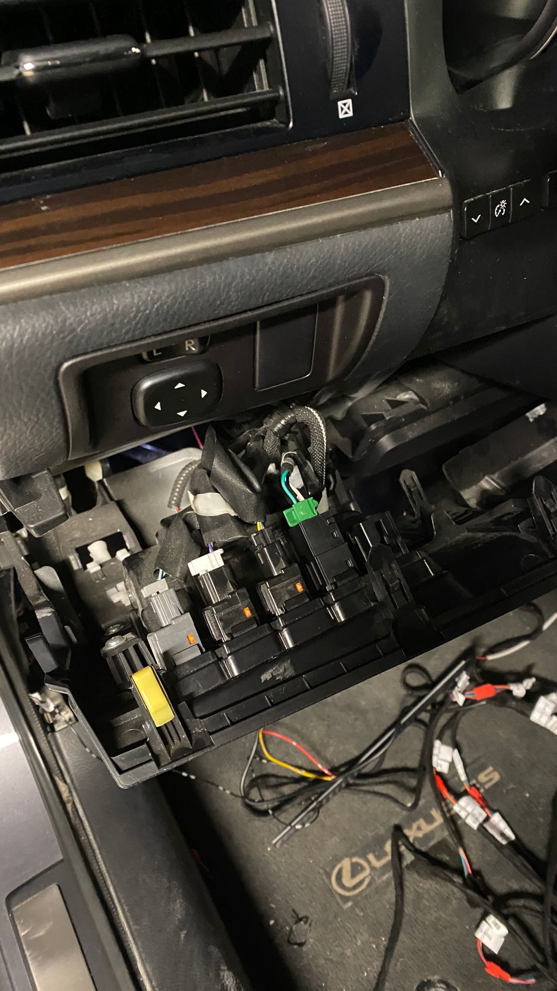

I have ordered this package from Alibaba after long time searching for the right product for my 2017 ES350, it should arrive tomorrow evening, I’ll see how it’s gonna look like after installation and share with you guys.

Just a small recommendation, use a permanent black marker and black out the end of the line. It will prevent the light from spilling out of the end of the fiber optic.
Yea I did that lol I'll try doing that also for the thick side to make it even thinner light

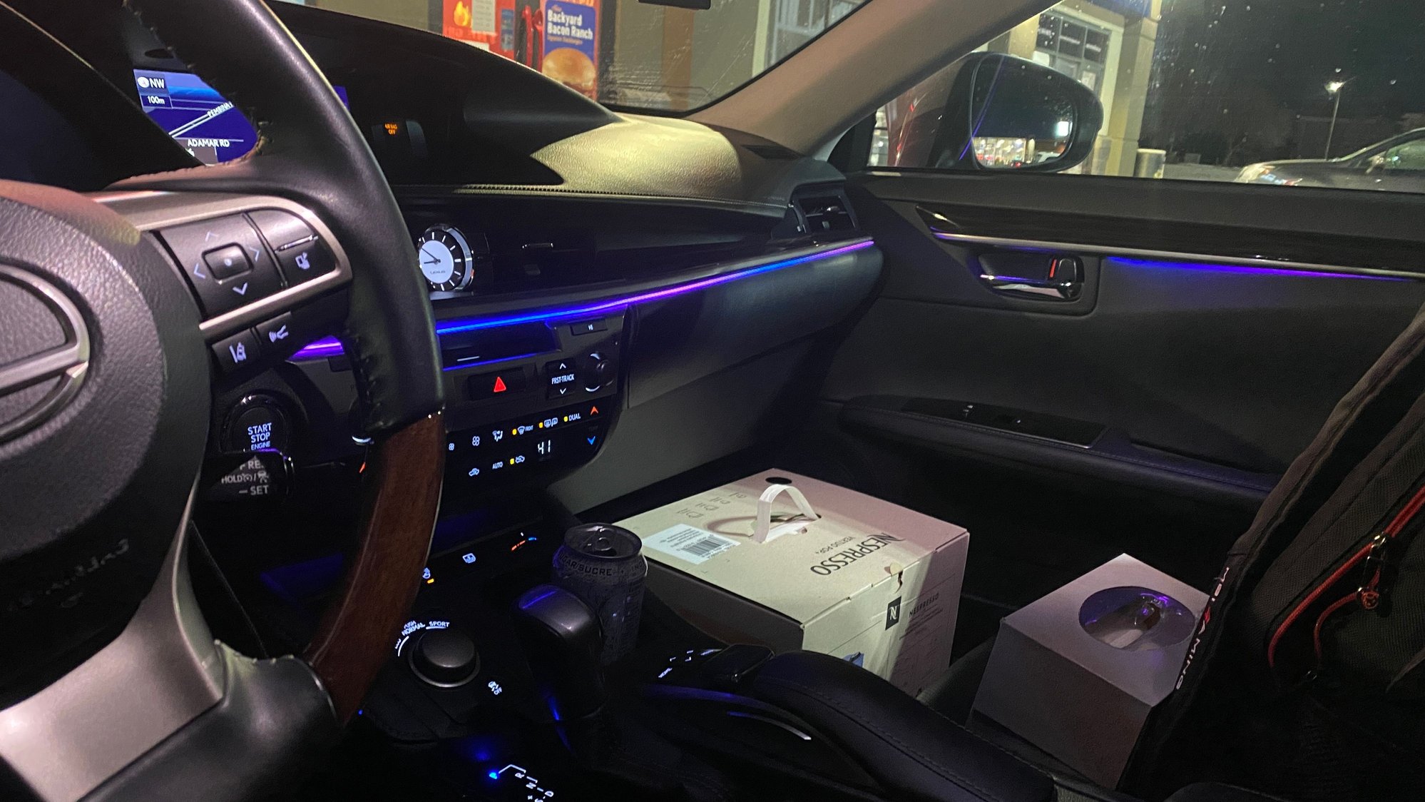

Old Jan 3, 2024 | 12:59 PM

it looks great! I love how the controls are integrated into the car rather than using an app like most other kits

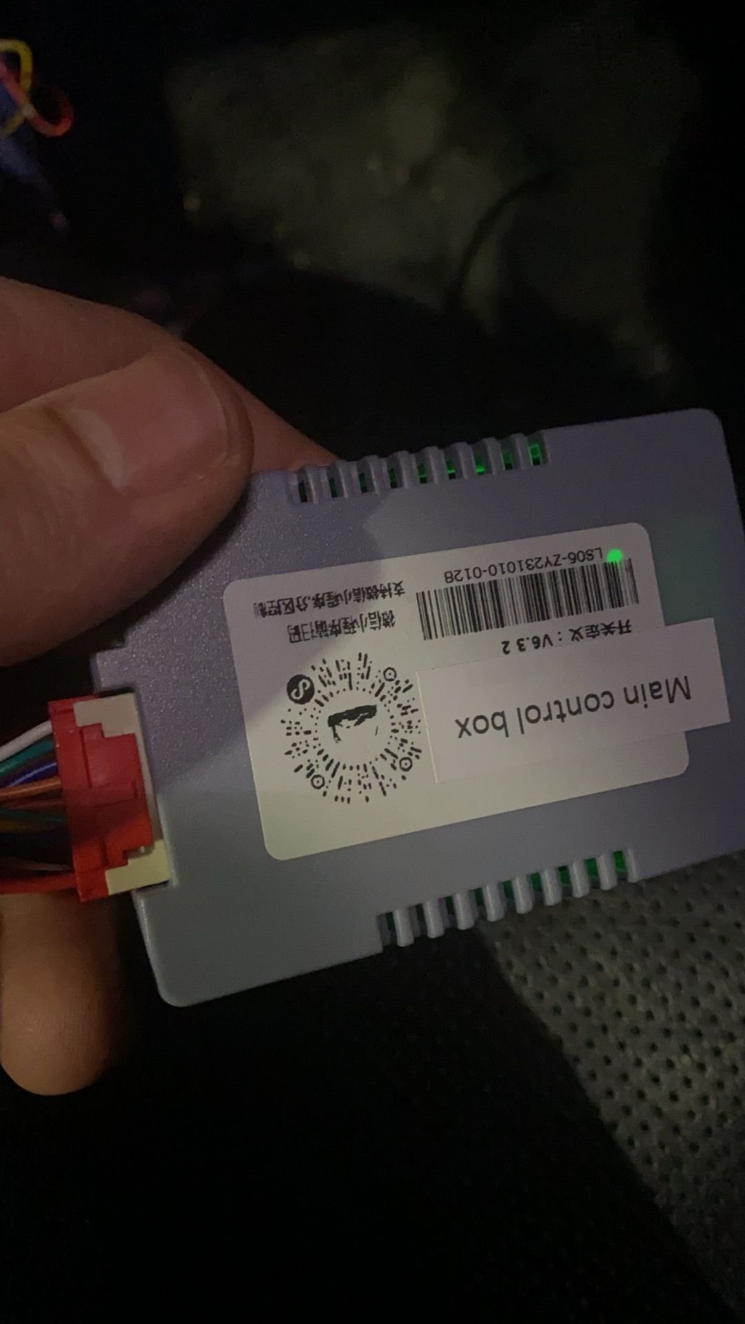

Yea me too I found this supplier after long search on Alibaba and yet I still can control them from my phone. The buttons work perfectly and specially designed for Lexus ES350 and it's connected to the main control Box. each button has 2 different functions when you long press it or when pressed quick.

Quick question regarding the strips, did you have to unscrew the trim piece off to install the light strip? I know theres like 10 screws that hold it on on the door panel.
At first I unscrewed the entire screws of the trim piece located at driver’s door, but then I figured out that you can simply allocate the opening and try to push or slide the light bar in an angular way back and forth slowly and like the worm motion, until it fits inside the housing.
You might loosen the first couple screws if you couldn’t allocate the opening or if it was hard to push in.
The hard part actually is putting back the door cover back in place, which I figured it’s easier if you tilt it upward and flush with the window line and you should start putting it back starting from the edge closer to the side rear view mirror all the way back. There should be no gaps or bloating in trim when you finish.
