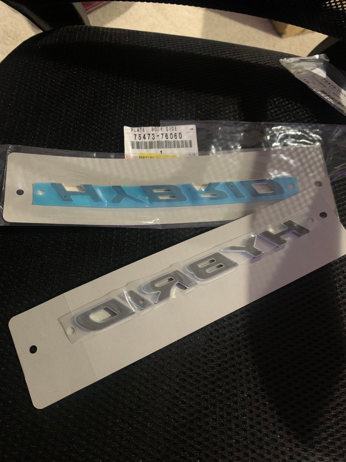

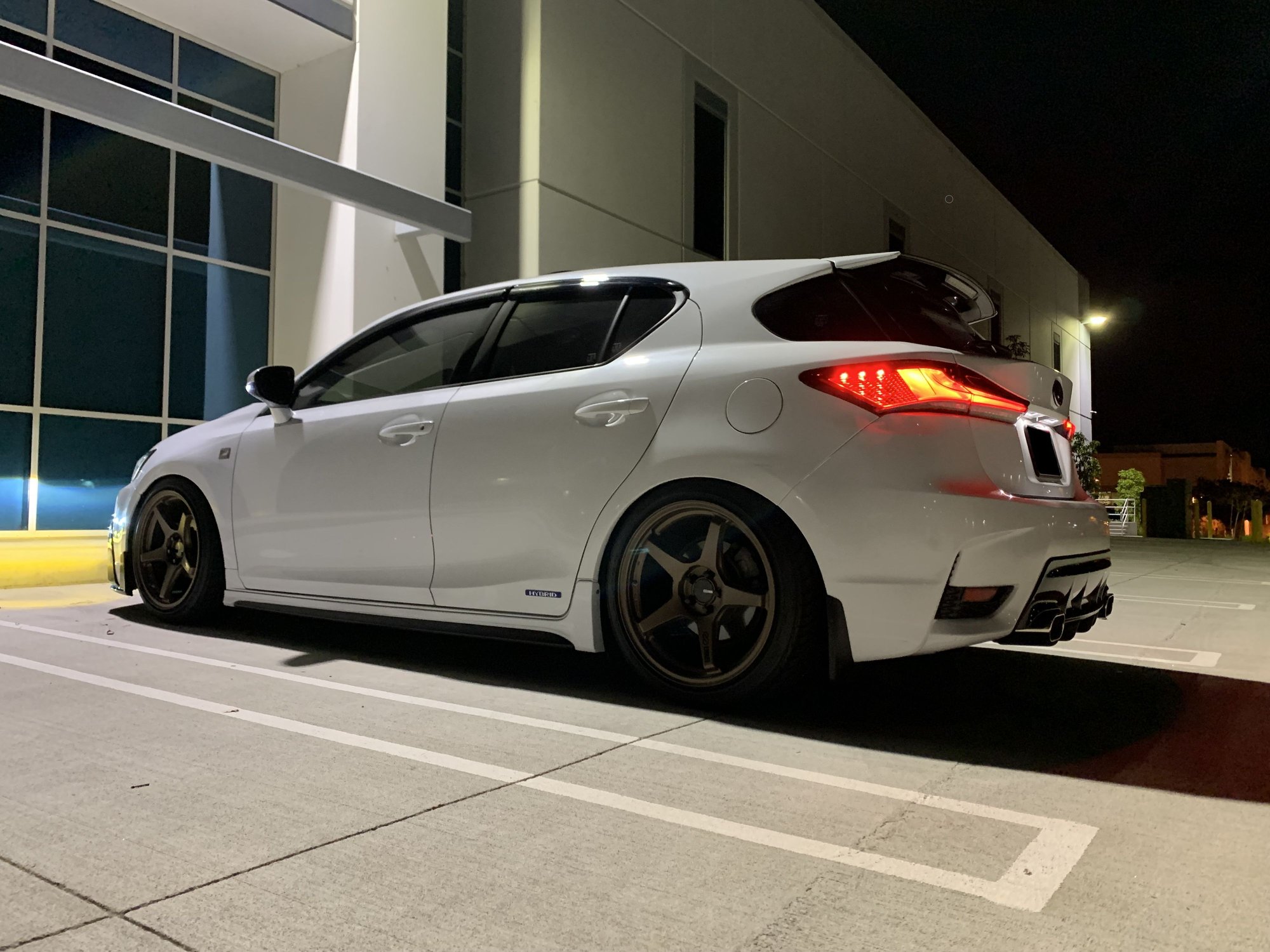

Next you need to get "HYBRID" letter badging from the ES (or UX) for the sides. remove those old style badges. i think the facelift CT uses those anyway in rest of world. The car looks good except just a tad low for my tastes. tires need more beef!! but i can appreciate the quality updates. they aren't cheap.
Already ordered the newer hybrid emblems earlier this week haha. I also ordered the “LEXUS” letter badging that replaces the F-Sport hatch emblem that I already removed. Soon I’ll remove the hybrid emblems as well, honestly I kind of like how it looks without them.

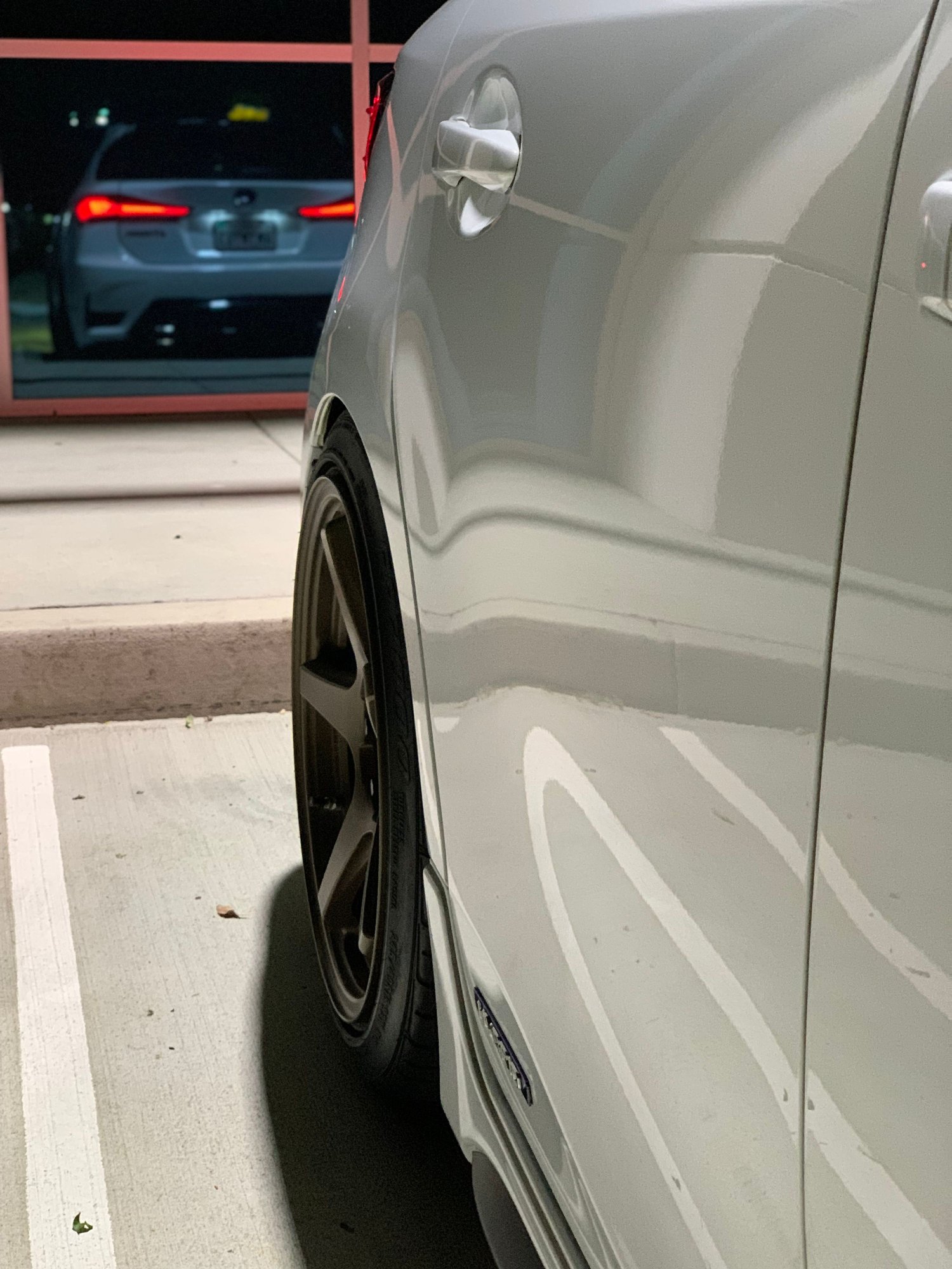

I prefer the flush look, I’m only running about -0.5 camber all around. The 245s on my 9.5” wheels have a slight stretch to help with the lowered car rubbing issues (very rare for me).
I also have the 18+ F-Sport rear bumper bezels, but I like the less sportier/subtle look without them.

I was going to say... yours looks better than I thought it would for some reason. The 2018+ is cool and all, but I never really thought it would go well on an earlier version for some reason. But yours looks great!

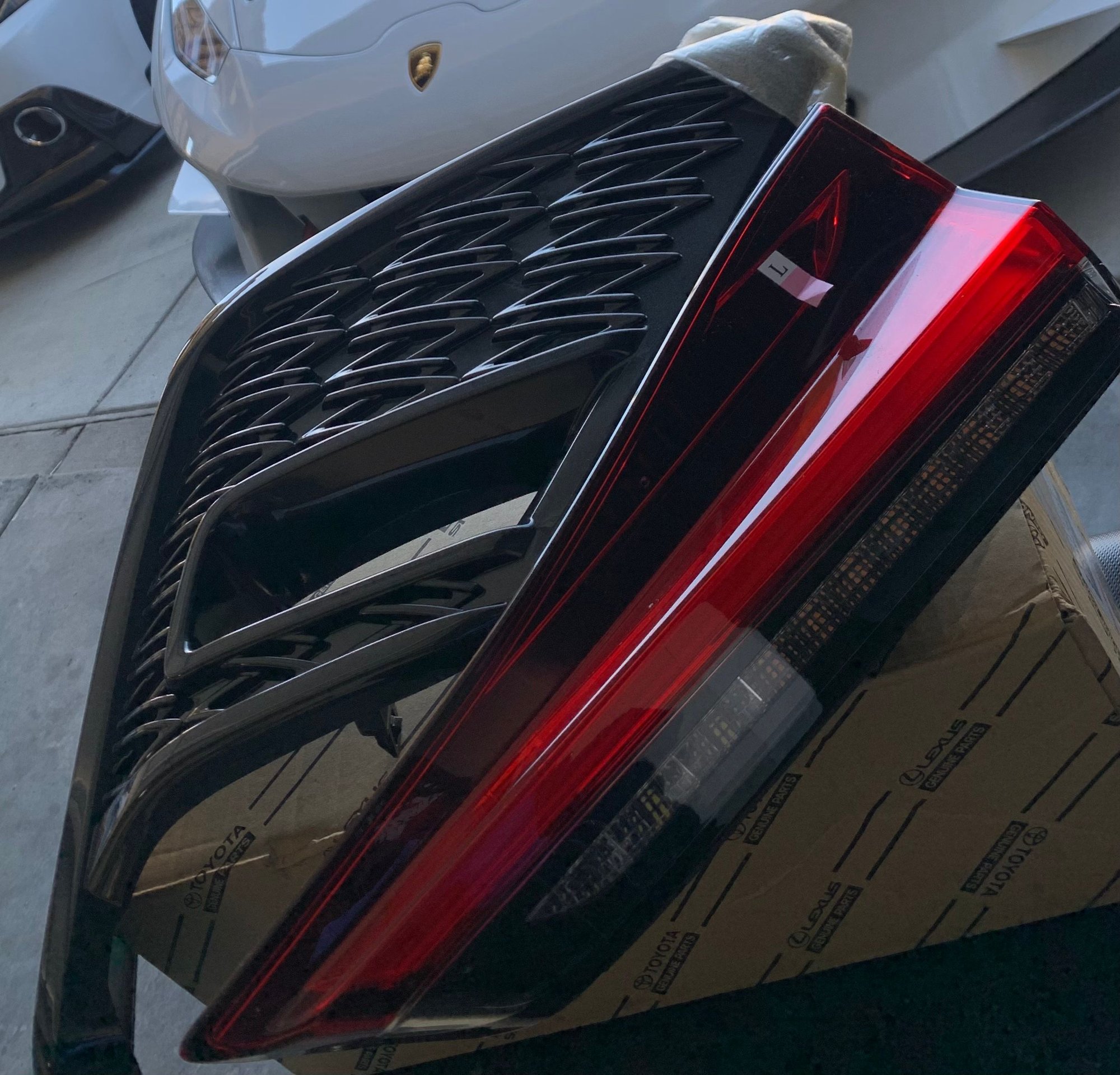

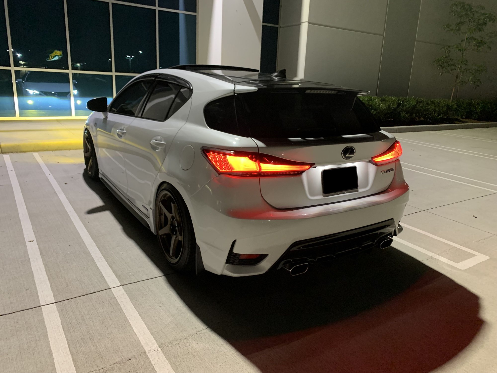

I really like the look of those solid red color rear lights, much more prestige instead of the white color Lexus chosen. How difficult was this rear light conversion? Is it a direct bolt on/off or more involve that a novice can handle? Appreciate if you can share where to purchase and installation steps. Great job!!
I don't think the install is too bad, I'm just having a little difficulty with the turn signals right now (still a work in progress). My knowledge isn't that great when it comes to electrical.
LED flasher relay installed that got rid of the hyper flash on cluster, but signals still wouldn't turn on.
I used a 50w 3ohm resistor with no luck/signals didn't turn on
Voltage adapter/reducer used
  • 6v = outer signals don't work BUT hatch signals quickly blink.
  • 5v = outer signal lights work with correct speed BUT hatch signal doesn't turn on.
  • 3.3V = signals do not turn on

Oh ya trust me I get the "flush" look. I was one of the first to flush back in the day and know the insiders who started those movements in the bay area--the OGs. trust me i scraped my fair share of driveways ripped off enough bumpers, etc. but those days are long in my rear view. i'm actually trying to look for a lift kit for my ES.
Flush is fine to an extent but to me it starts to get hairy when the tires are stretched or stick out, etc. I tend to gravitate towards the more high-end factory, fully engineered look. Yours isn't too bad though i've definitely seen worse stretches. and hats off to you for not going negative with your camber. I think for yours it's the lowness to me is too low. plus it's just a lot of headache. stuff rubs, then you have to diagnose, stuff gets damaged, you run over stuff, wheels bend etc. i can go on. suddenly your life revolves around your car and not the other way around. Just a personal preference =)

I don’t like overly stretched super mega jdm stanced demon camber / \ lol. With my current ride height I was fine driving straight over most speed bumps without any scraping until I someone offered me a 2018+ TRD front lip for almost a steal. Besides the lift kit are you planning anything else for your ES?
