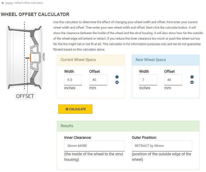

In addition to the above, I also used a wheel offset calculator to compare fitment against other examples shown online
https://www.1010tires.com/Tools/Wheel-Offset-Calculator
For instance, if you input my wheels 9.5" +40mm compared to your 7" +46mm, you'll see the outer position clearance fitment/difference of 38mm as well as the inner clearance of 26mm
