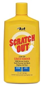

I've had some people tell me that liquid SCRATCH-OUT works very well on old yellowed or crazed plastic headlight covers....others, no difference. Not guaranteed to work, but it might be worth a try...and it doesn't cost much.
I partially blame the automakers for this.....IMO, they should be using hardened-glass covers instead of plastic. Plastic is probably lighter and cheaper.
