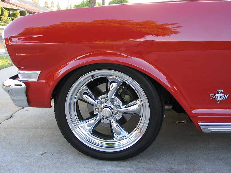

Mustang front suspension riding on 17" American Racing wheels.

Question Front brakes?
Are those Mustang front brakes too? If my memory is correct, the mid-60's Nova did not have a factory disc brake option...only drums front and rear. Some Fords had optional power front disc brakes....as did the Corvette.

The Mustang front end (90's vintage) is a cut and weld deal and it has the stock calipers for that assembly. Notice the shock towers are gone and replaced with bracing. That made the 383 look tiny as there is lots of room in the engine bay.
One lacking part was the drum rear end. I would have liked to have seen Willwoods all around and the back be a multi-link coil-over instead of the leaf.
