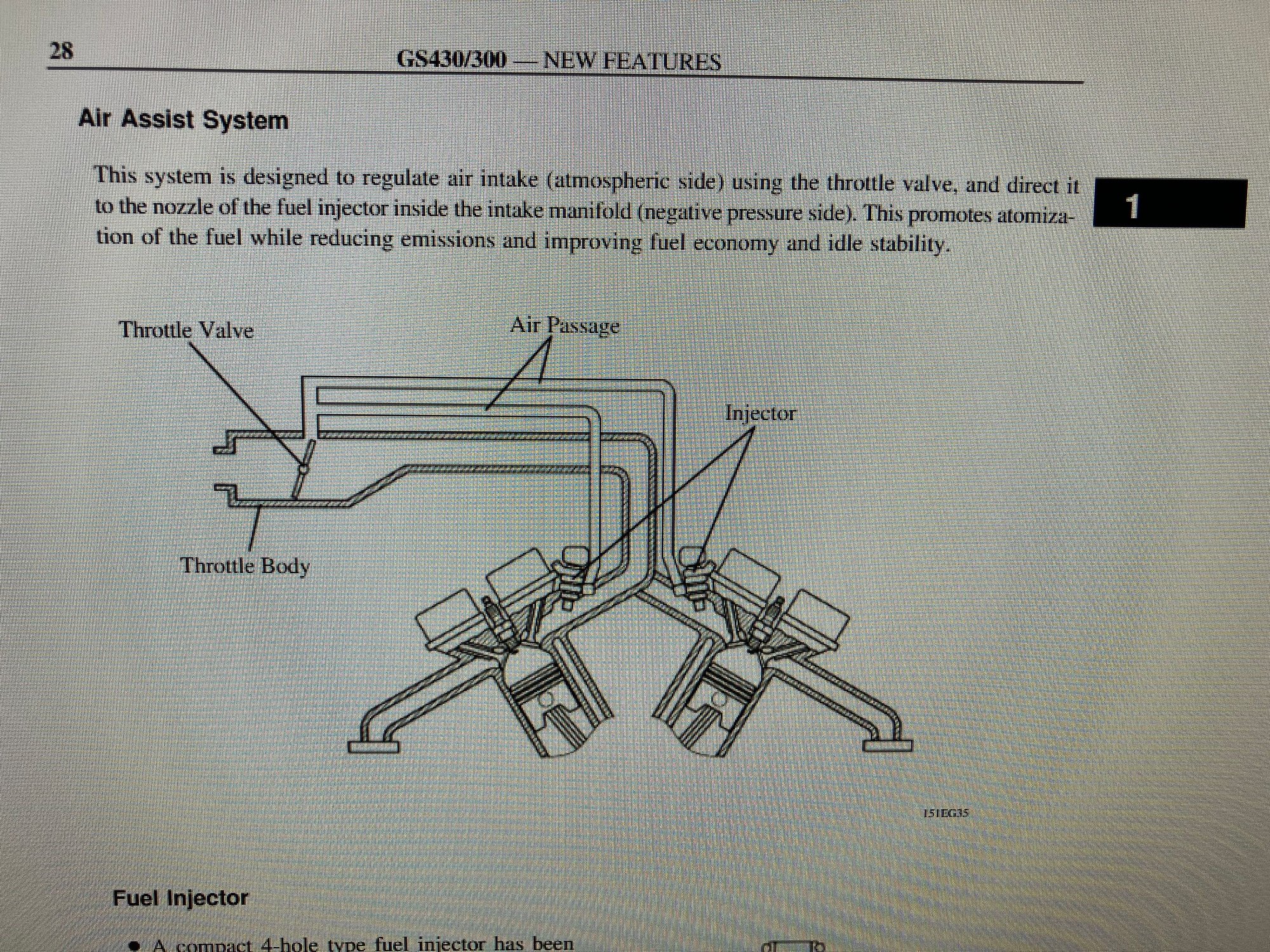

also the valve covers will definitely start leaking on a UZ at some point, and the air mix path is like a 7-8 minute job that just requires a phillips head and some throttle body cleaner (highly advised every old LS driver follow Yamae's thread for this!)
Unless the paths have not been cleaned in near 200k miles and require the intake to come off....mine would not idle right until I gave up and pulled off the whole intake and forced fluid though the paths.
After that and new driveline mounts it was glass smooth until it wore the mounts out after 65-75k and you could begin to feel it on cold startup again.

hmm did they change the design that much for the 3UZ? on my car it's literally just a little plate held in by 2 phillips screws right at the top front center of the engine, the intake piping only needs to be pulled if you wanna spray directly onto the throttle plate
They go all the way down the intake right next to the actual fuel injectors, each is like a 1 foot long path. EXTREMELY annoying to get properly clean and the car WILL NOT idle dead perfect unless you clean them every 25k miles, if you don't it will hunt up and down 20-30 rpm if the AC is off and lights are off.
Those made me irate. I spent HOURS checking for vac leaks, replacing all the vac lines, smoke testing, performing relearns, etc etc only to find out Lexus used this moronic design when they had an electronic throttle control engine. Worst part is that when I relearned it it would be fine for a while then drift back out of spec/hunt, I was finally told of the issue on here by Yamae and it was a moment of true amazement that this sort of system exists at all. It can also disrupt shifting behavior from 1-2 and at low throttle inputs
