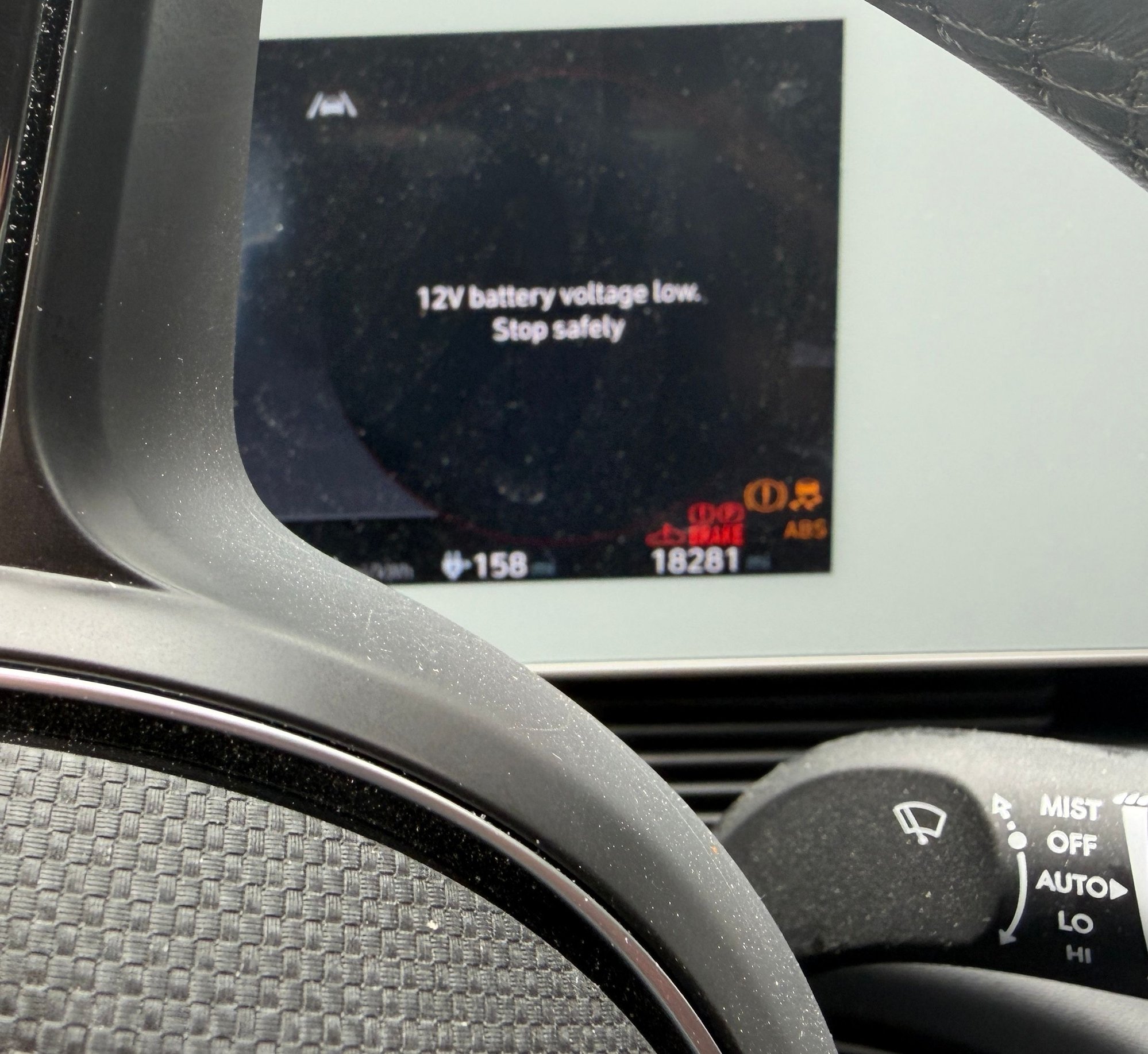

so today was substandard on the ioniq front. came out from an appointment, went to start the car and got this on the gauge.
car wouldn’t go anywhere. first rule, don’t panic. having been through something similar with the GV60 (and dealer replaced the battery), i knew i had my portable lithium GB40 noco booster in the car. opened hood, attached to 12v battery, waited a few, and car ‘started’ right up and i drove over to my office where i had to drop some stuff off but knew i had to go to the dealer after that.
i didn’t get to the car at my office for a couple of hours with stuff to do, and went out to go to the dealer with it. nothing. couldn’t even unlock the doors. knowing the portable charger was in the car, i used the manual physical key to open the driver’s door, tried the noco again but noco was nogo. the noco was barely recharged so i charged it for a while but no go still, and then thought maybe i could have the noco plugged into usb charger to charge it while having it connected to the battery for a boost. well that didn’t work, i guess the car 12v battery was draining the noco faster than the 100w usb charger was charging it. so i called the dealer, they said use the hyundai app to request a jump/tow to get it to the dealer. while waiting the hour for the tow i charged the noco (not connected to the car). got 2 bars of juice in it and decided to try one more time. success! so i drove to the dealer, canceled the tow, dealer took car to fix and gave me a loaner (lovely new elantra hybrid lol - it’s actually way nicer than i would have imagined).
dealer was great… very pleased with hyundai dealer’s professionalism, facility, courtesy, etc.
hopefully dealer has an actual fix and the car will be back on the road in fairly short order.

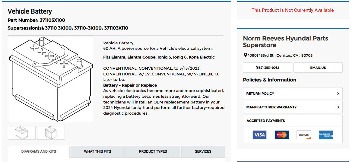

in 2 i’ve seen it sure looks like a regular car 12v battery, but are you saying it’s a less capable, (charge, amps, etc.) cheaper one?
It looks like the same battery they put in some of their smaller cars like the Elantra. It does show it being discontinued, though.
Let us know what they replace it with.

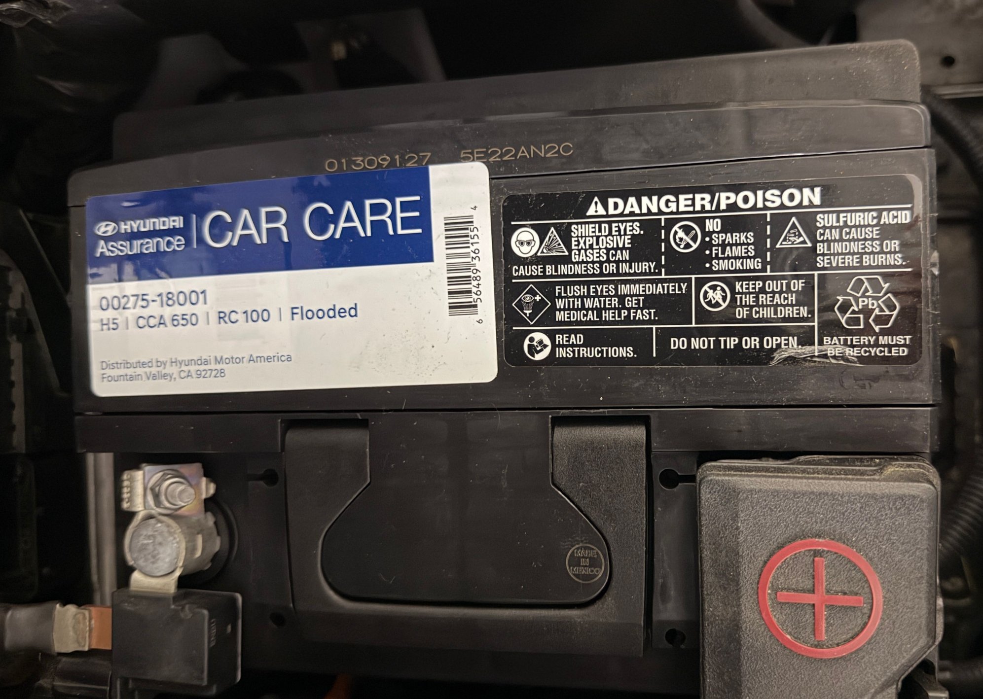

this is what i found (google AI) on what i suspect my original was and is the new one:
What 12V battery does IONIQ 5 use:
The 2023-2025 Hyundai Ioniq 5's 12V battery is a BCI Group Size 47 (also known as H5 or LN2), which is typically an Absorbent Glass Mat (AGM) battery or a flooded lead-acid battery.
i didn’t get a pic or specs of one that failed, but here’s pic of new one which is indeed, the H5 mentioned.
