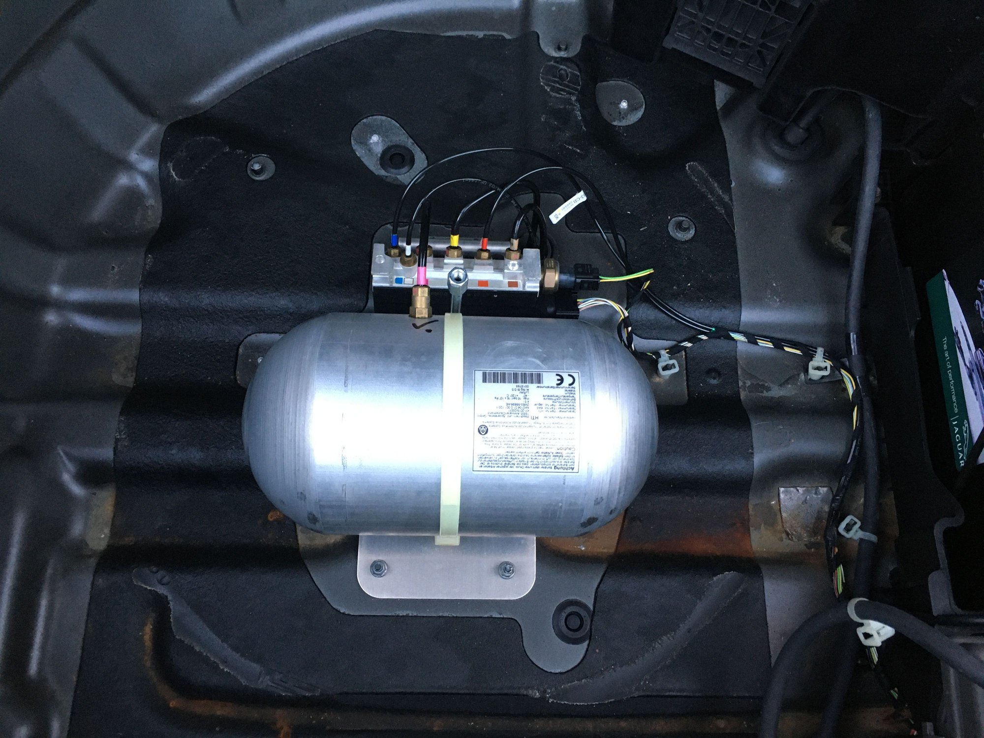

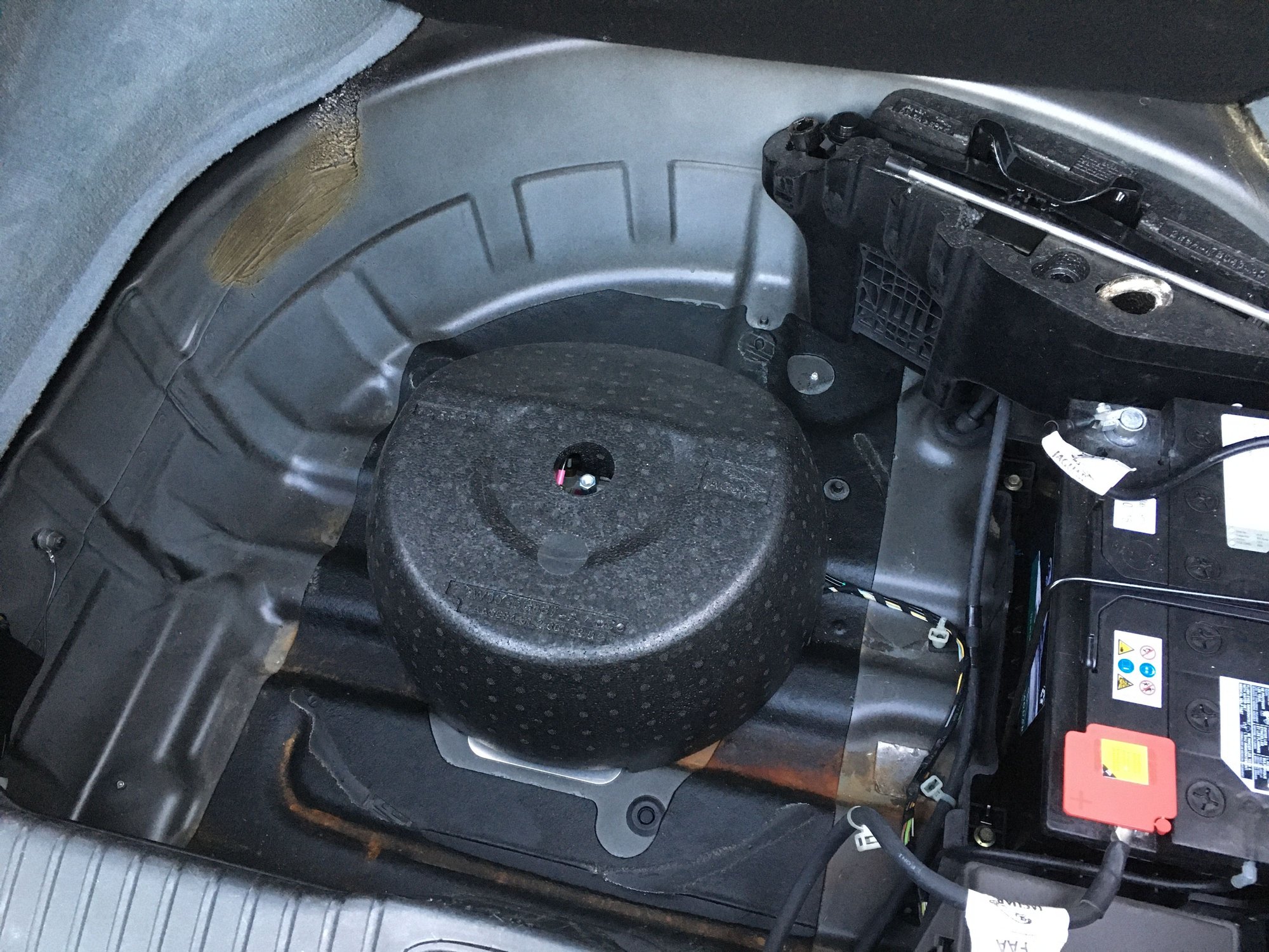

Such a very Jag way to mount something.....
I can't believe how tacked on the air system is lol!

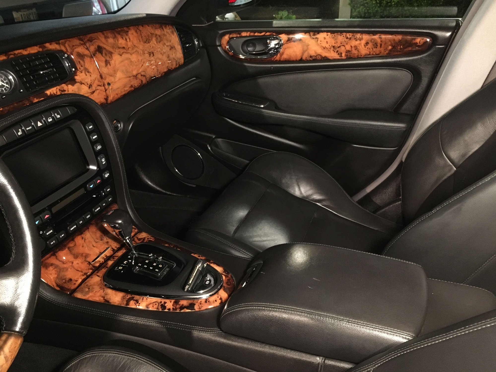

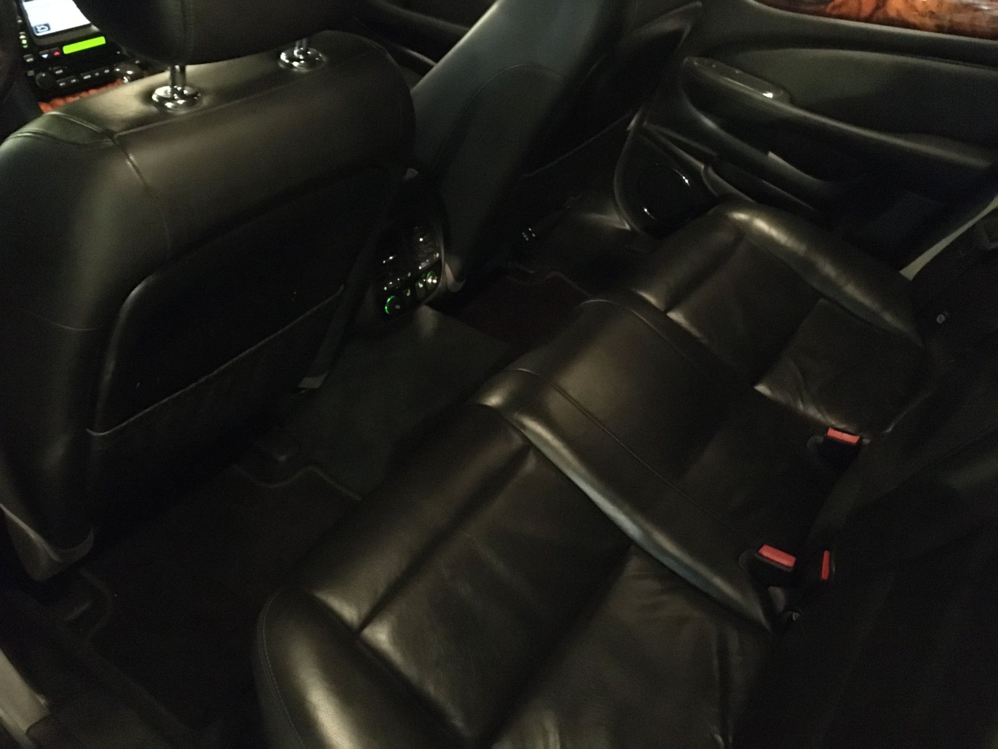

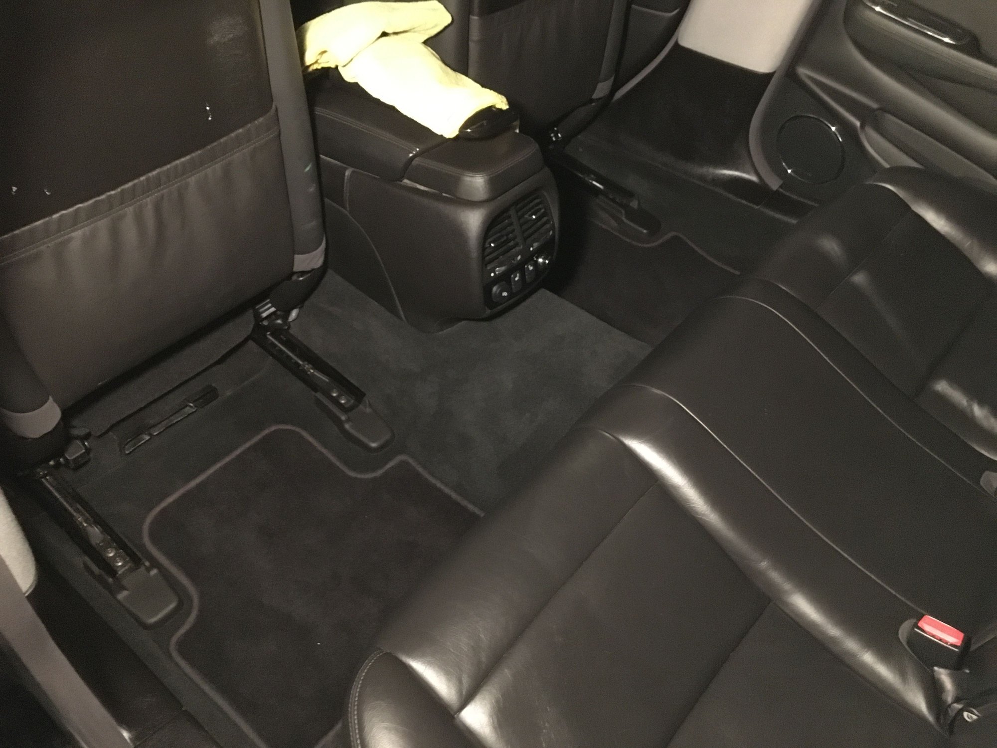

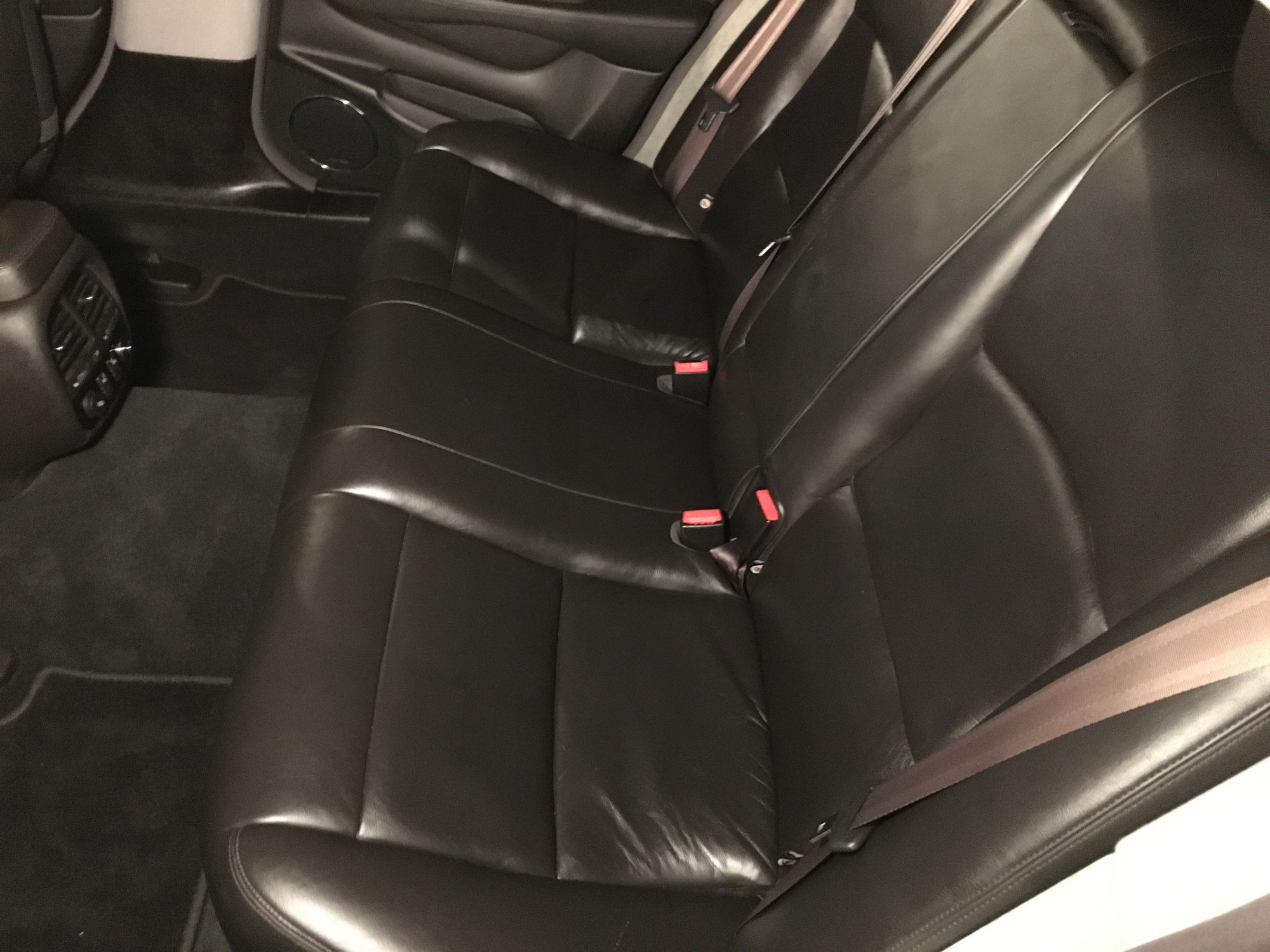

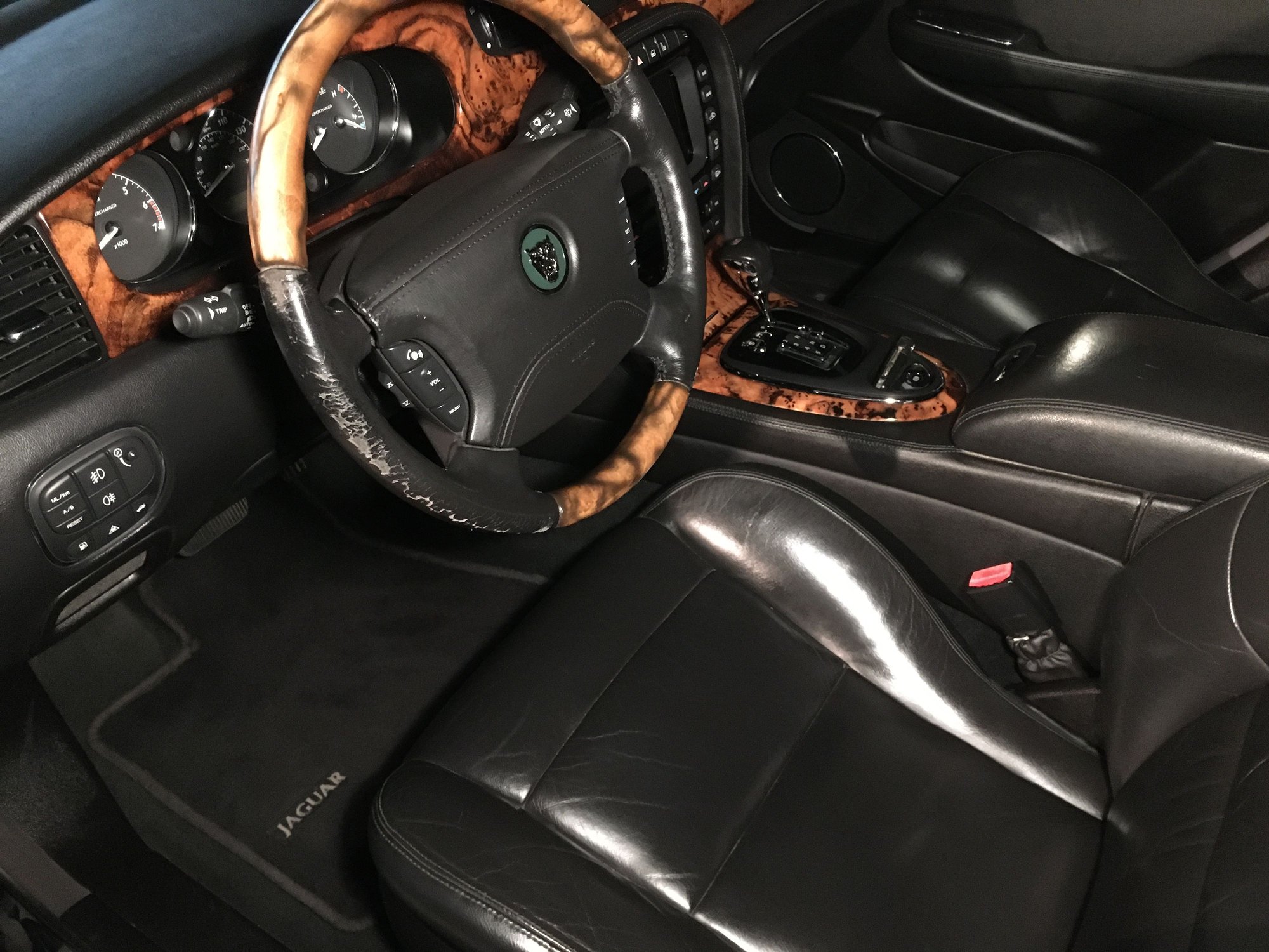

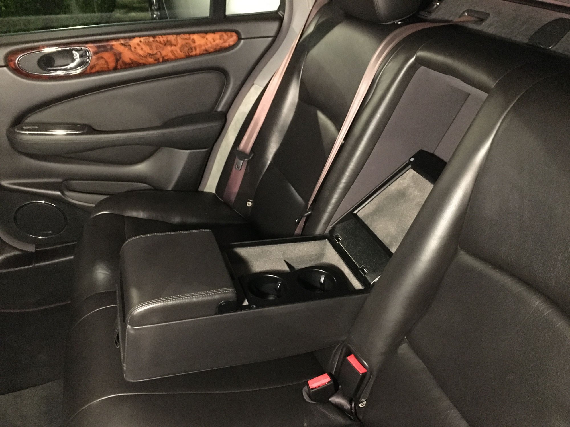

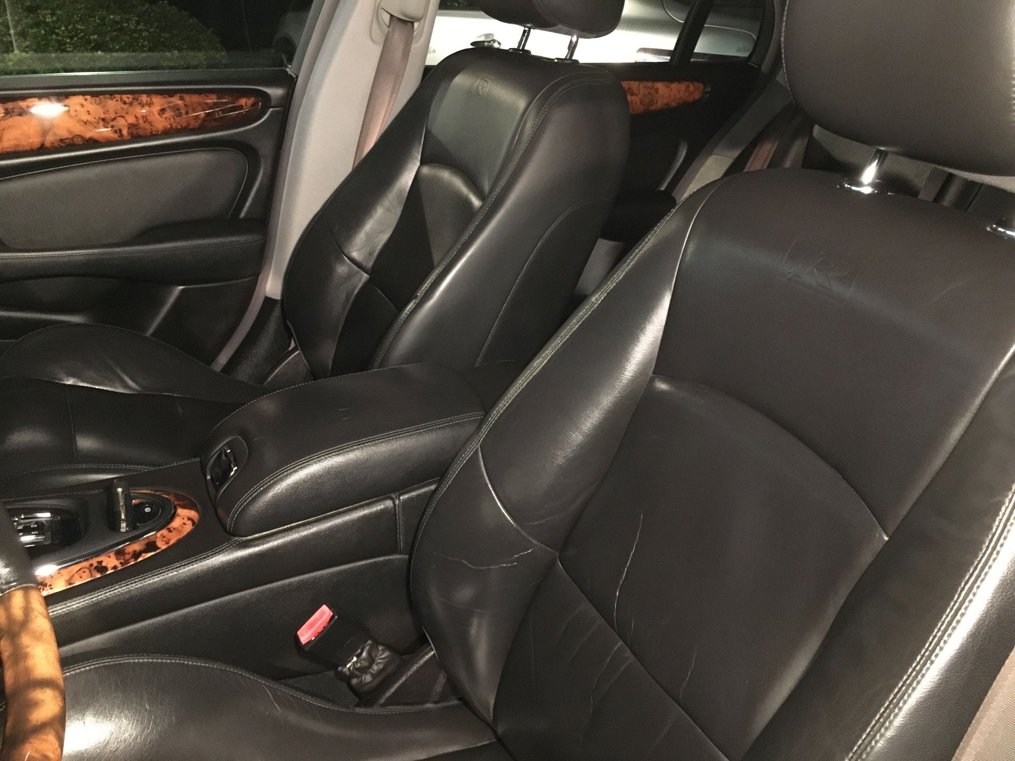

Interior as requested, it's not perfect since I don't know how to do leather repairs
Wheel is going to be replaced entirely since they are cheap and this one has both fading wood and leather damage

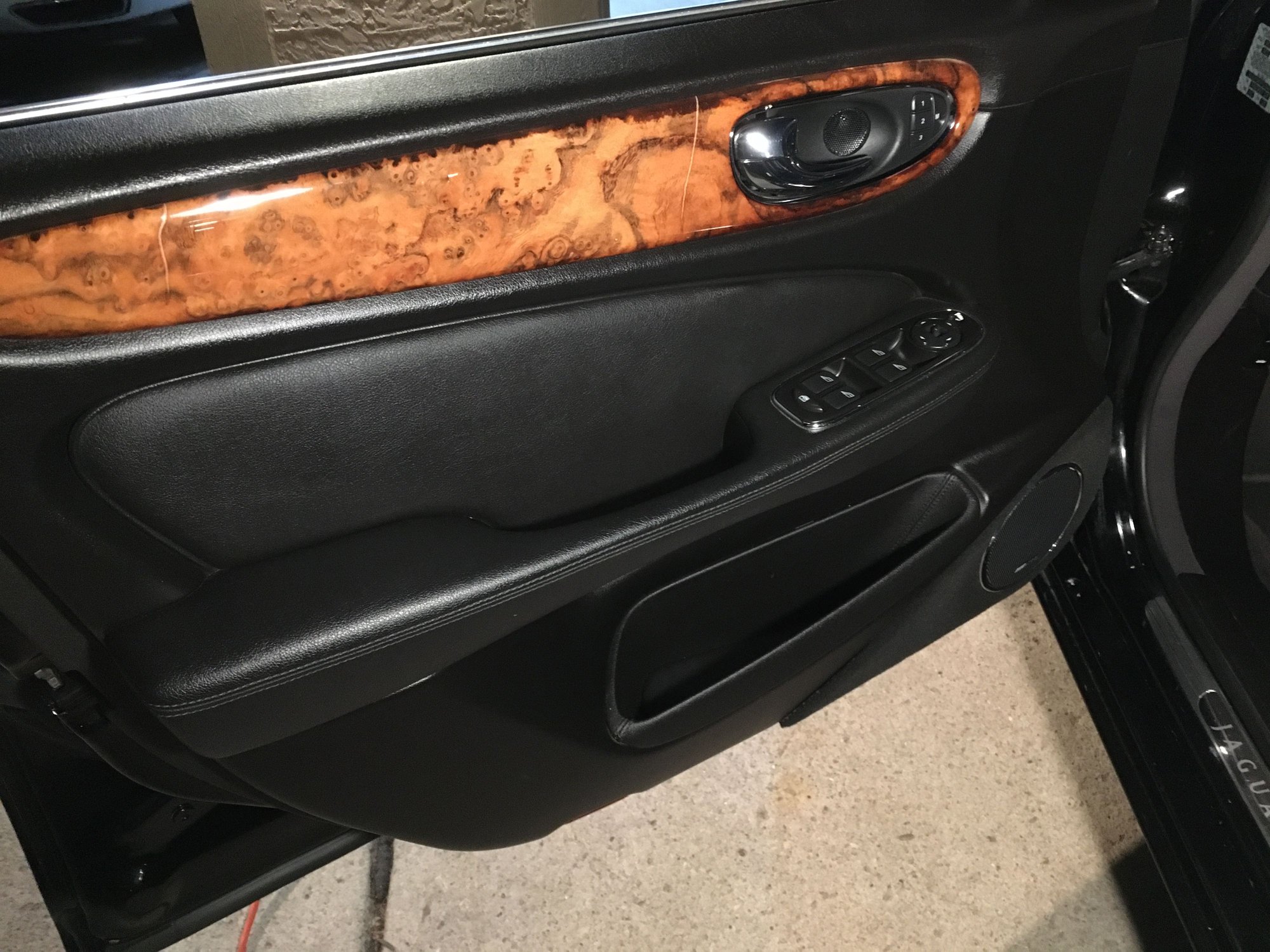

Trim on the doors was not attached when we picked the car up, I replaced all clips

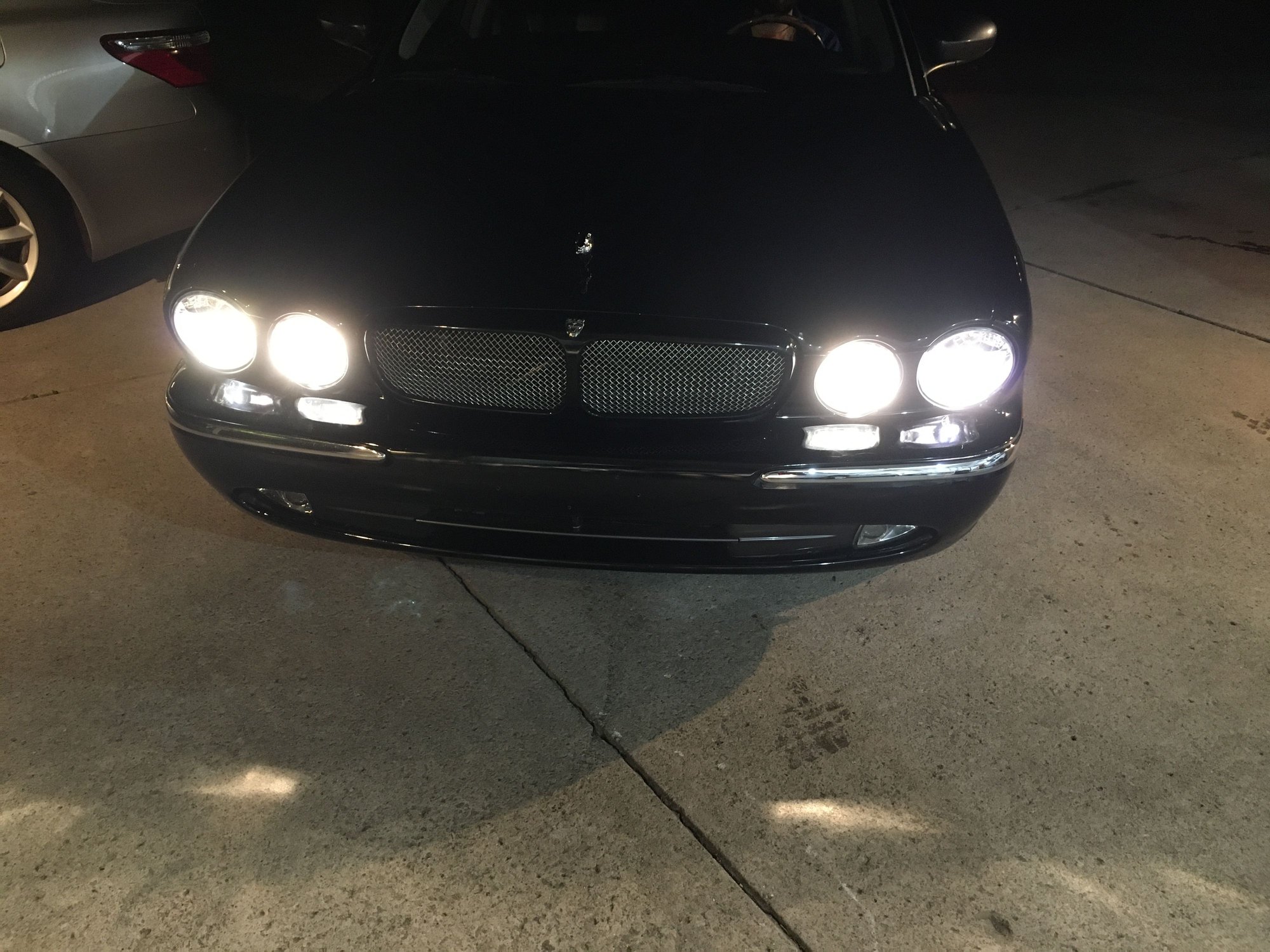

Super cool when lit!
I'm in love.
This beauty would be the perfect garage queen.
