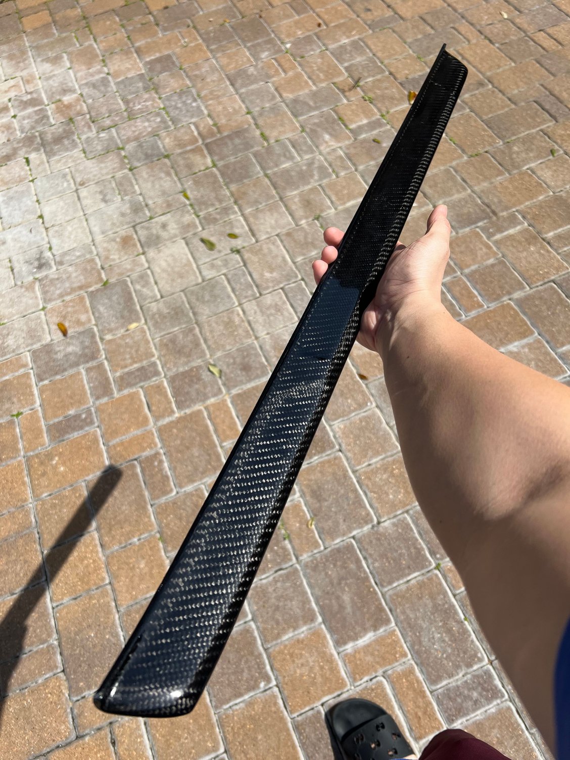

Default Carbon Fibered Outer Door Sill Trim
Did a little accenting with carbon fiber. Looks great in my eyes!

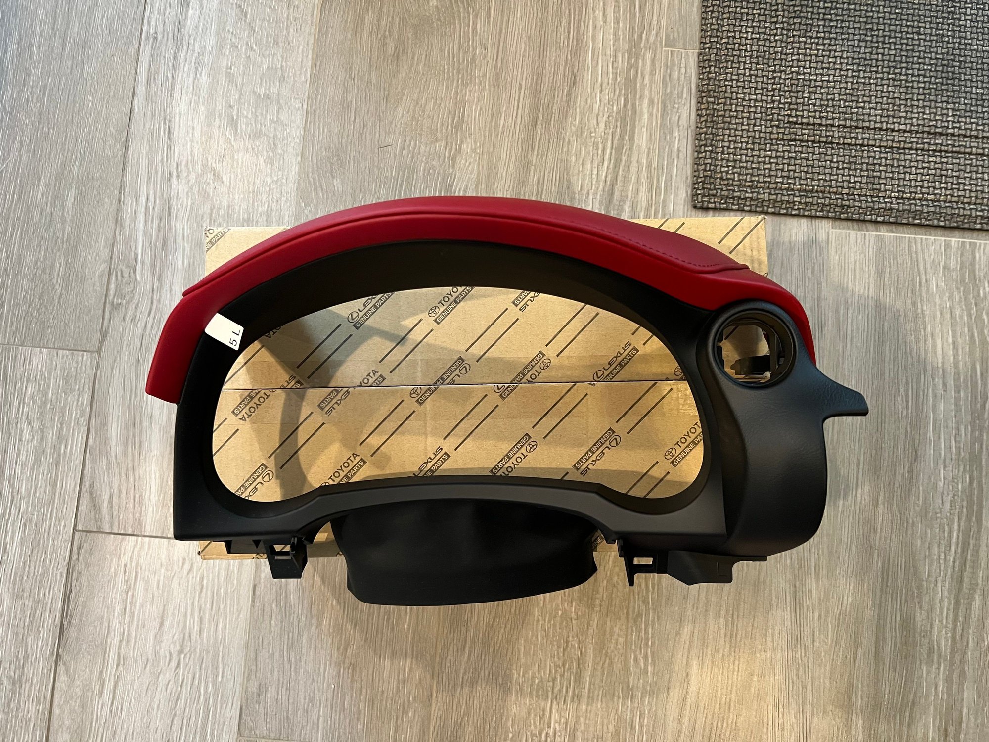

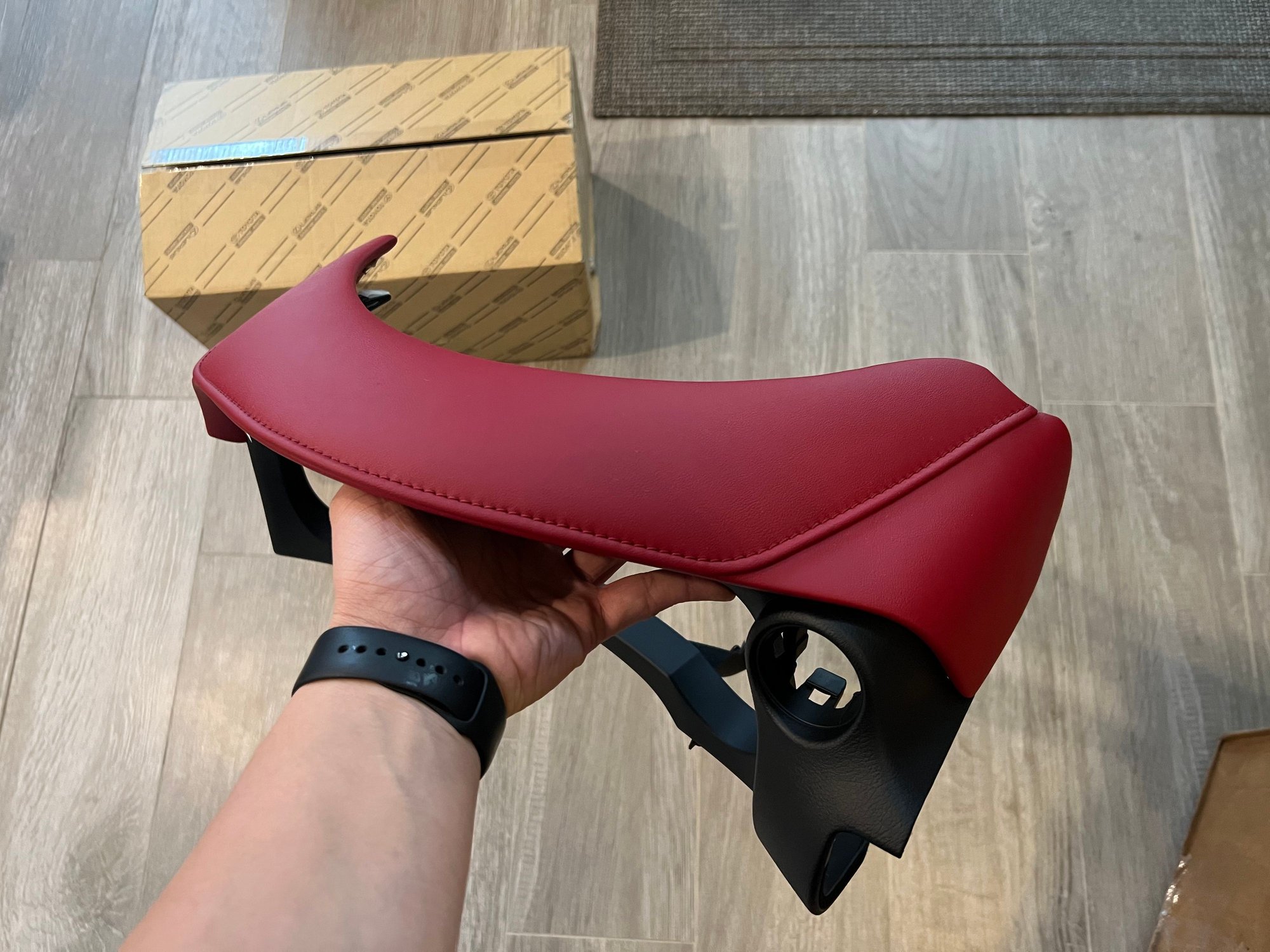

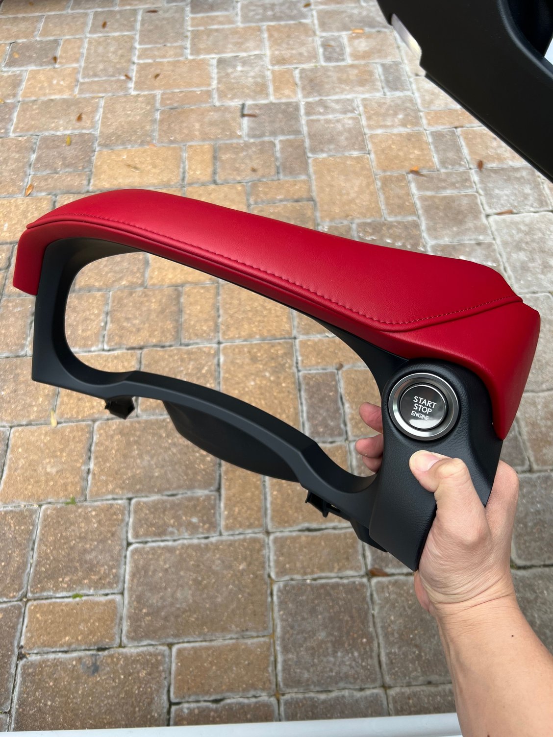

Default OEM+ Track Edition Cluster/Speedometer Hood
I had the Elvin one as previously posted but I wanted something OEM. I wanted this for awhile now, so I pulled the trigger!
I thought it was a direct swap but it wasn't. I had to shave some plastic on the bezel make it sit on the dash right.
Also preparing for an aftermarket 10” screen, so I needed a 2020+ anyway for an unobstructed view.

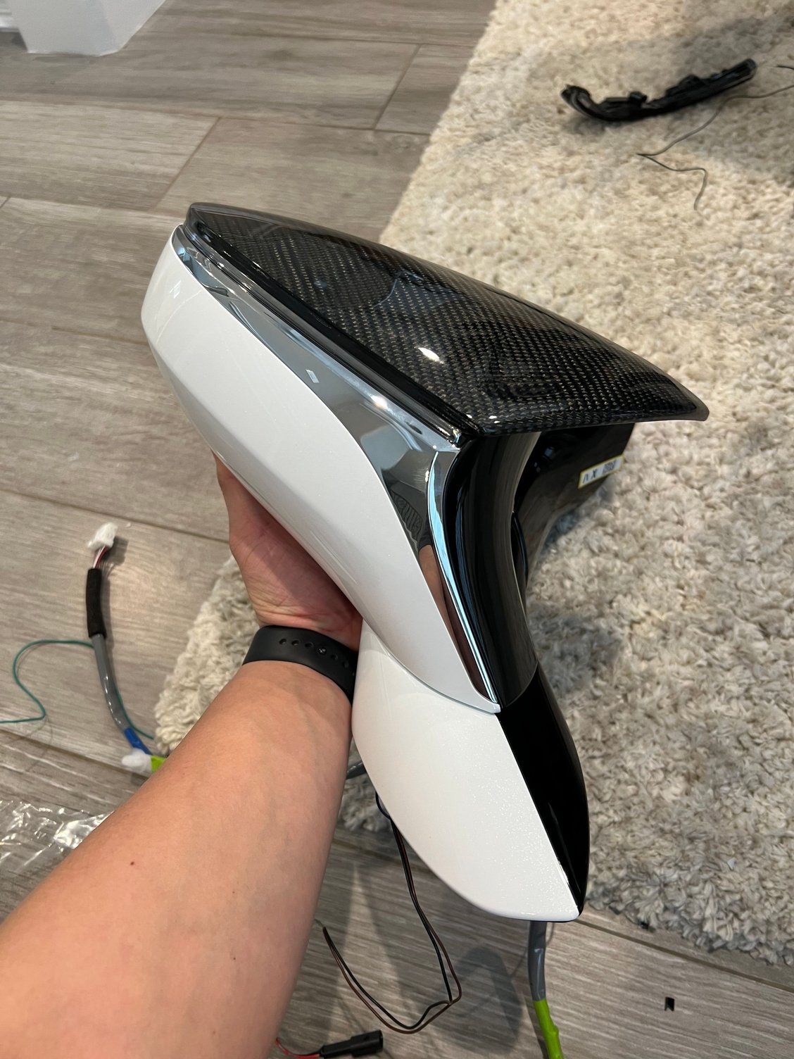

Default OEM+ 2020 Side Mirror Assemblies
Figured these were plug and play by a fellow CL member. I waited months for a good sale to pop up and it did two weeks ago! They came in yesterday and went straight to work!

Default Carbon Fibered TRD Winged Style Mirror Covers
I think the winged look looks great on this vehicle. It flows with the body lines very well.

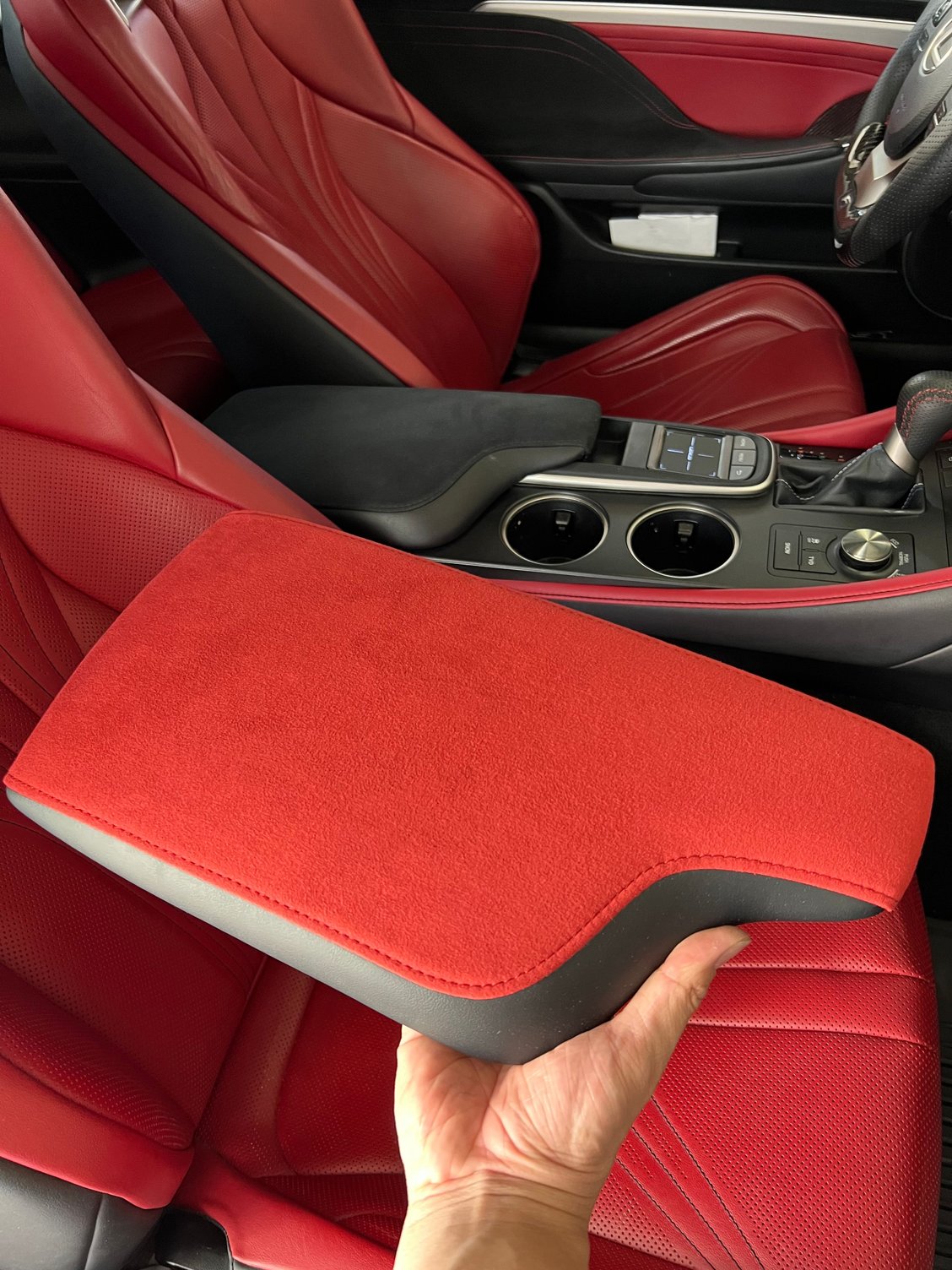

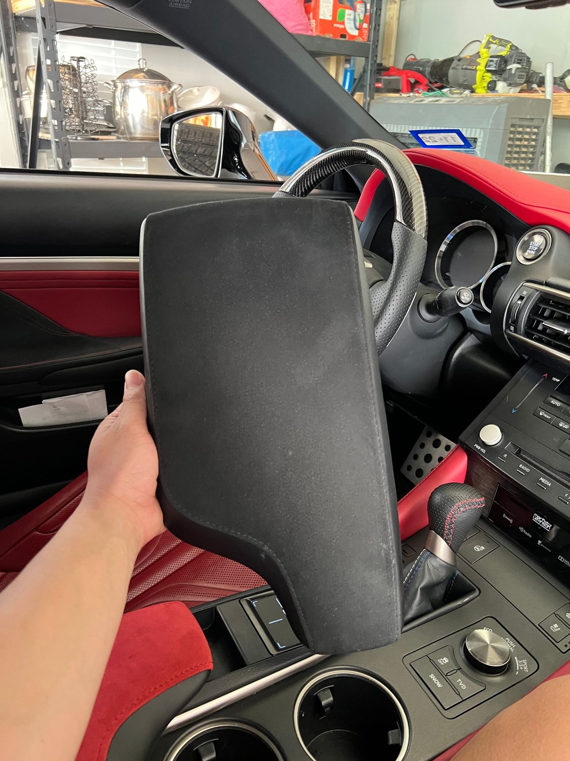

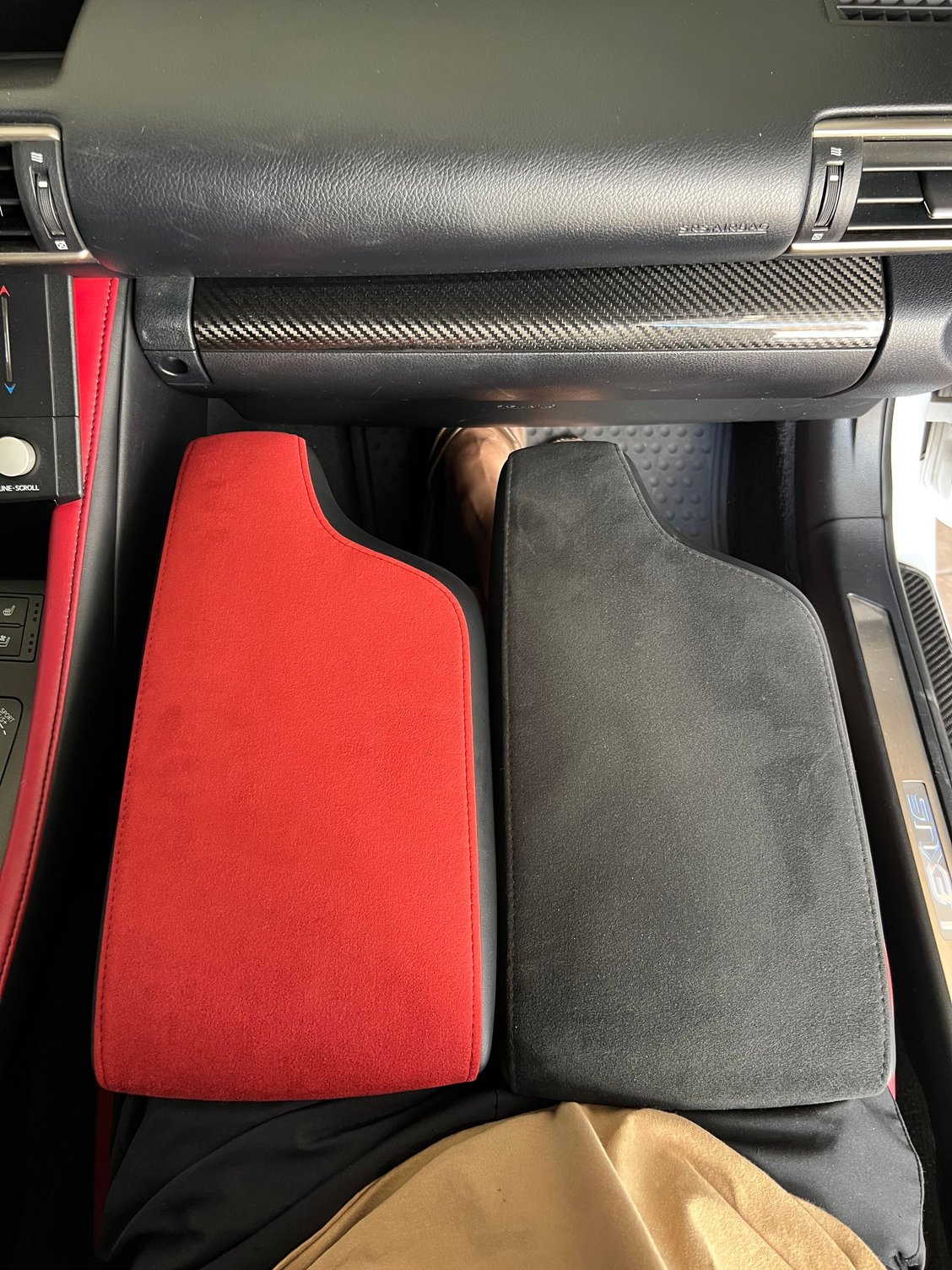

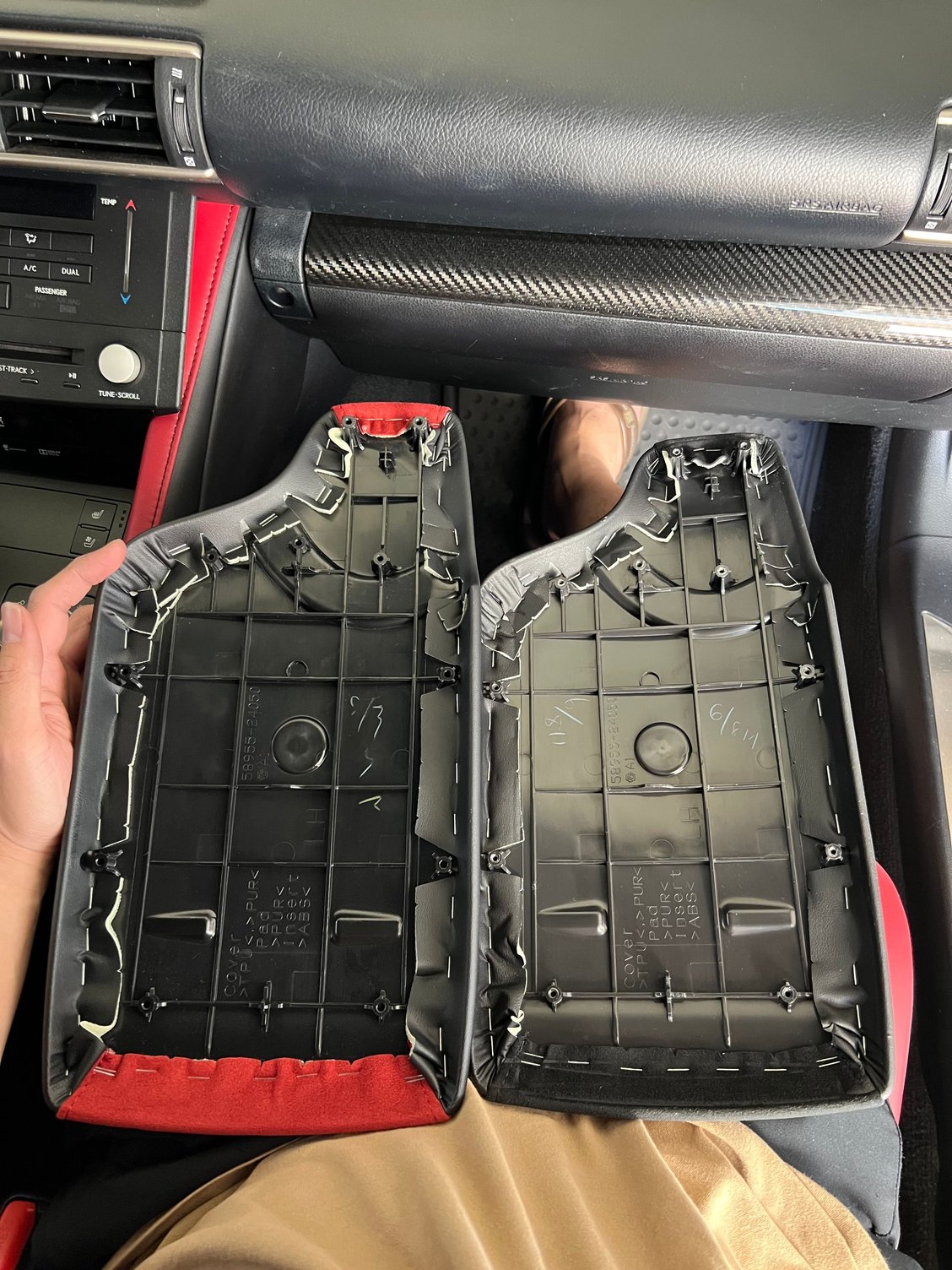

Default OEM+ Track Edition Center Console Armrest
What’s better than red alcantara? I live for these OEM+ upgrades!

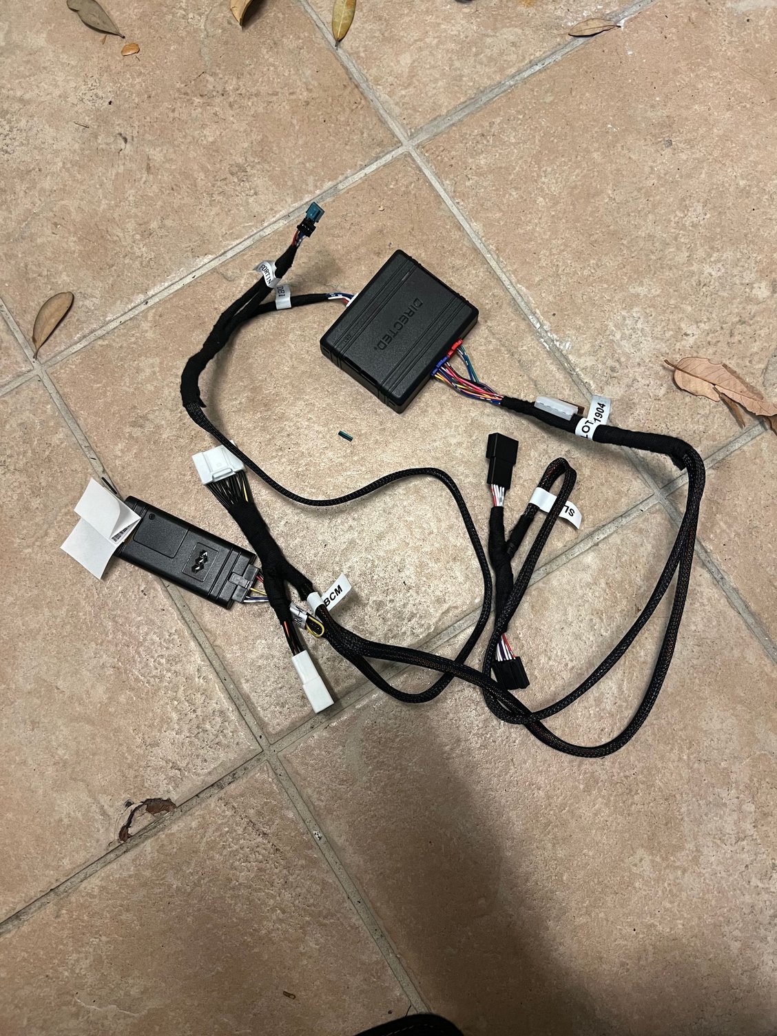

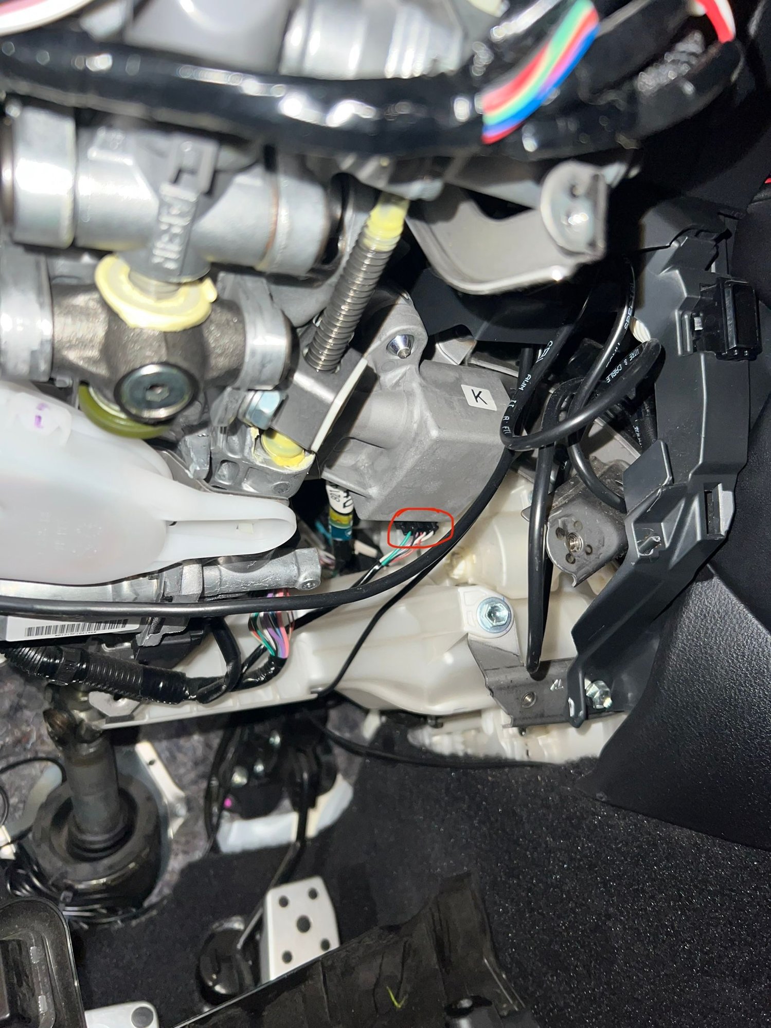

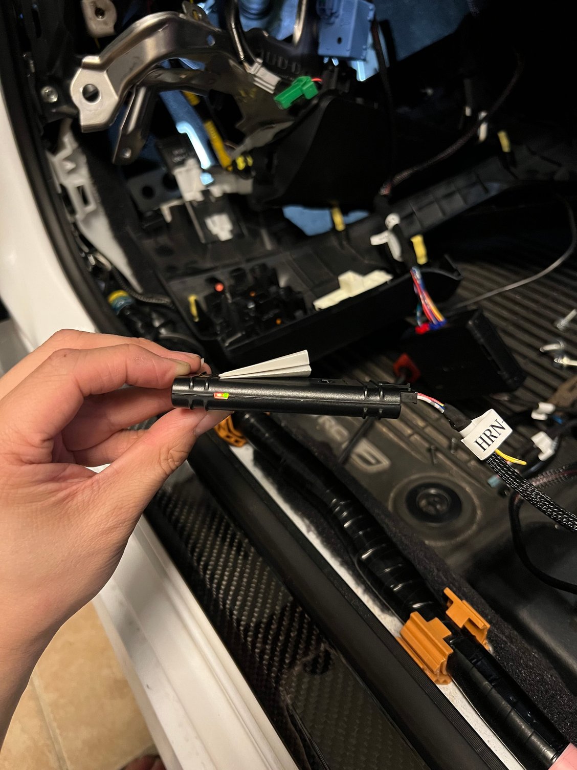

Default 12Volt Solutions Remote Engine Start Kit
Why pay Enform when it’s discontinuing in October? I figured I’d rather buy this kit now than paying monthly for Enform.
Service on this relies on 4G network while Enform is 3G. The amount of response time is drastically reduced and almost instant.
The install was straight plug and play, no guess work. Loving this new kit!

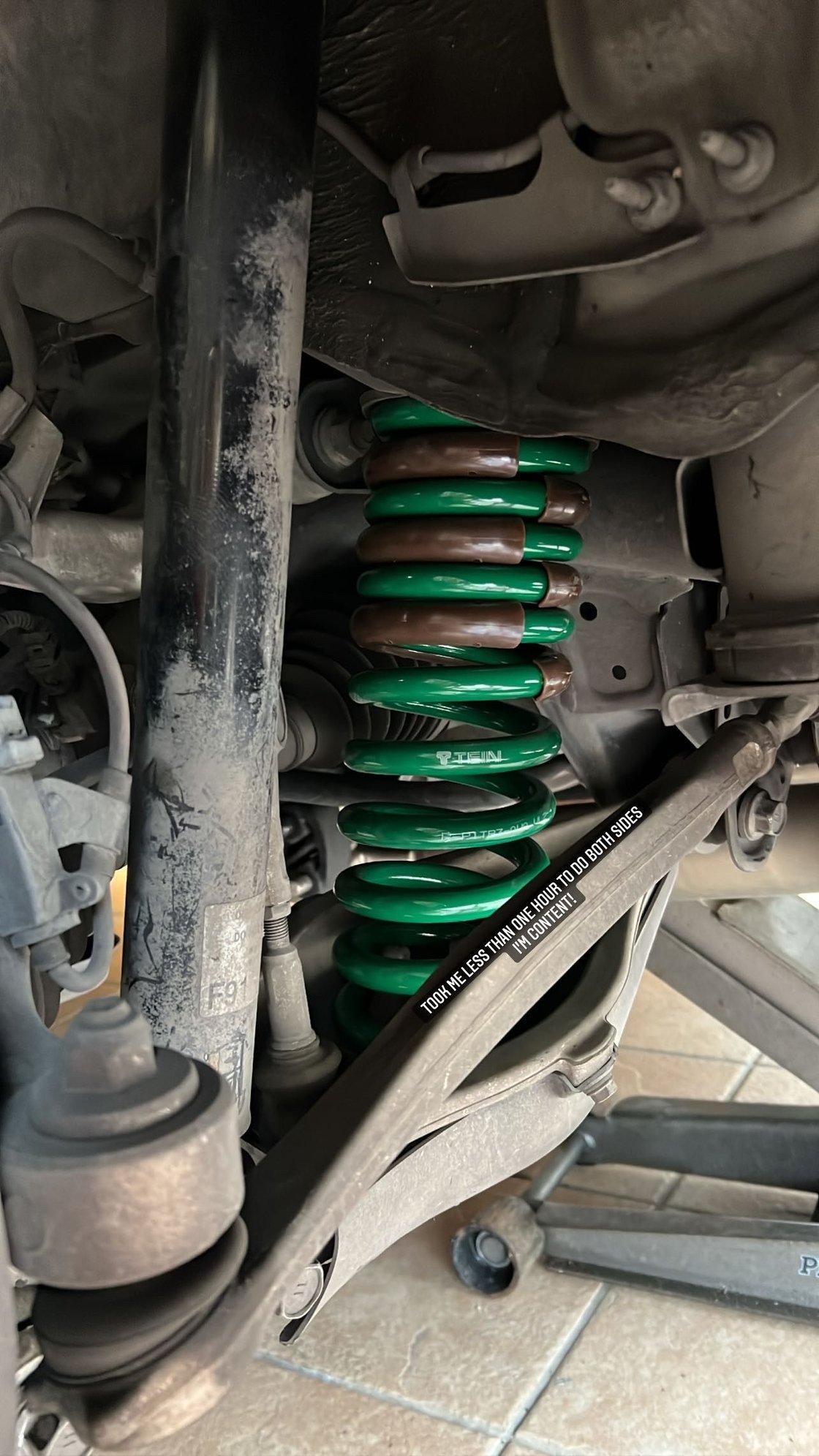

Default TEIN S.TECH Lowering Springs (Rears Also)
When I did the fronts only, the reverse rake disappeared. After a few hundred or thousand miles, it went into a forward rake. Then my friend showed a video of my car rolling and it looked very funky in the rear, so I threw on the rears today! I am loving the new stance now!

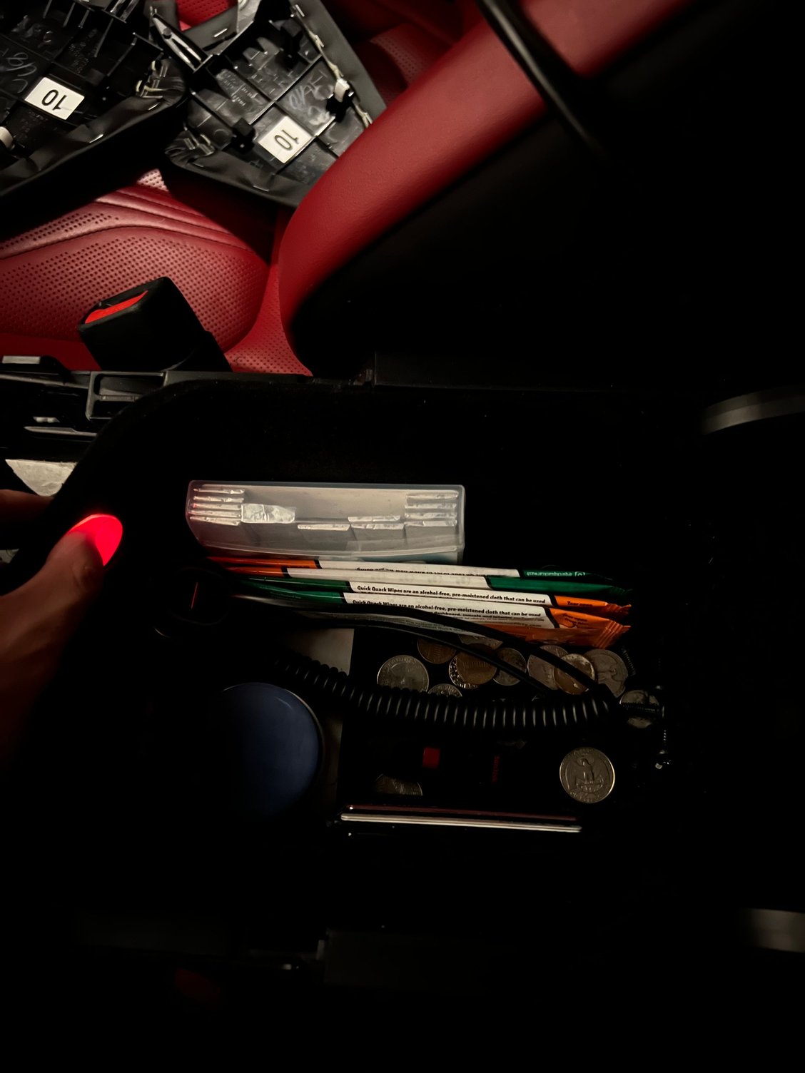

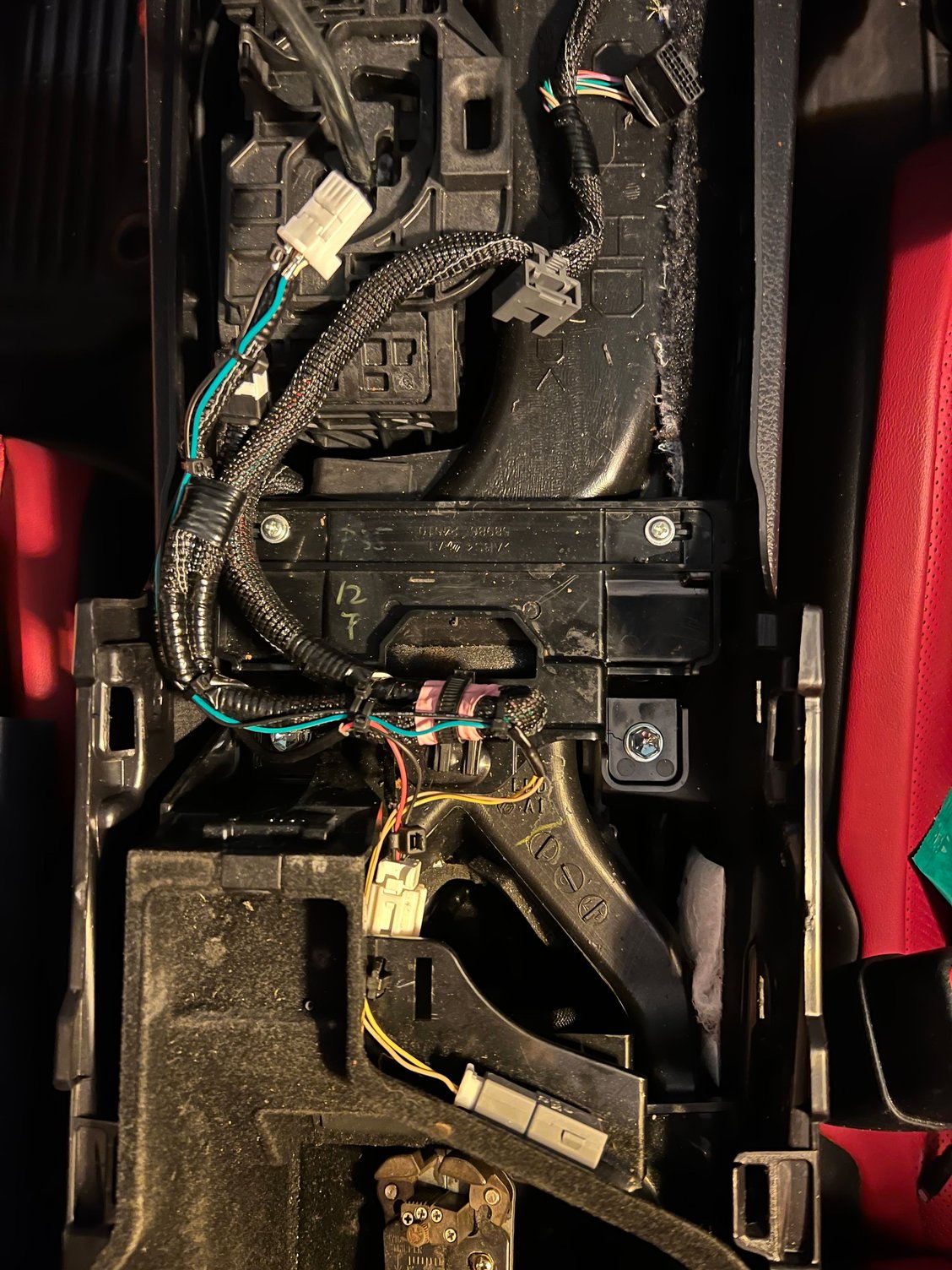

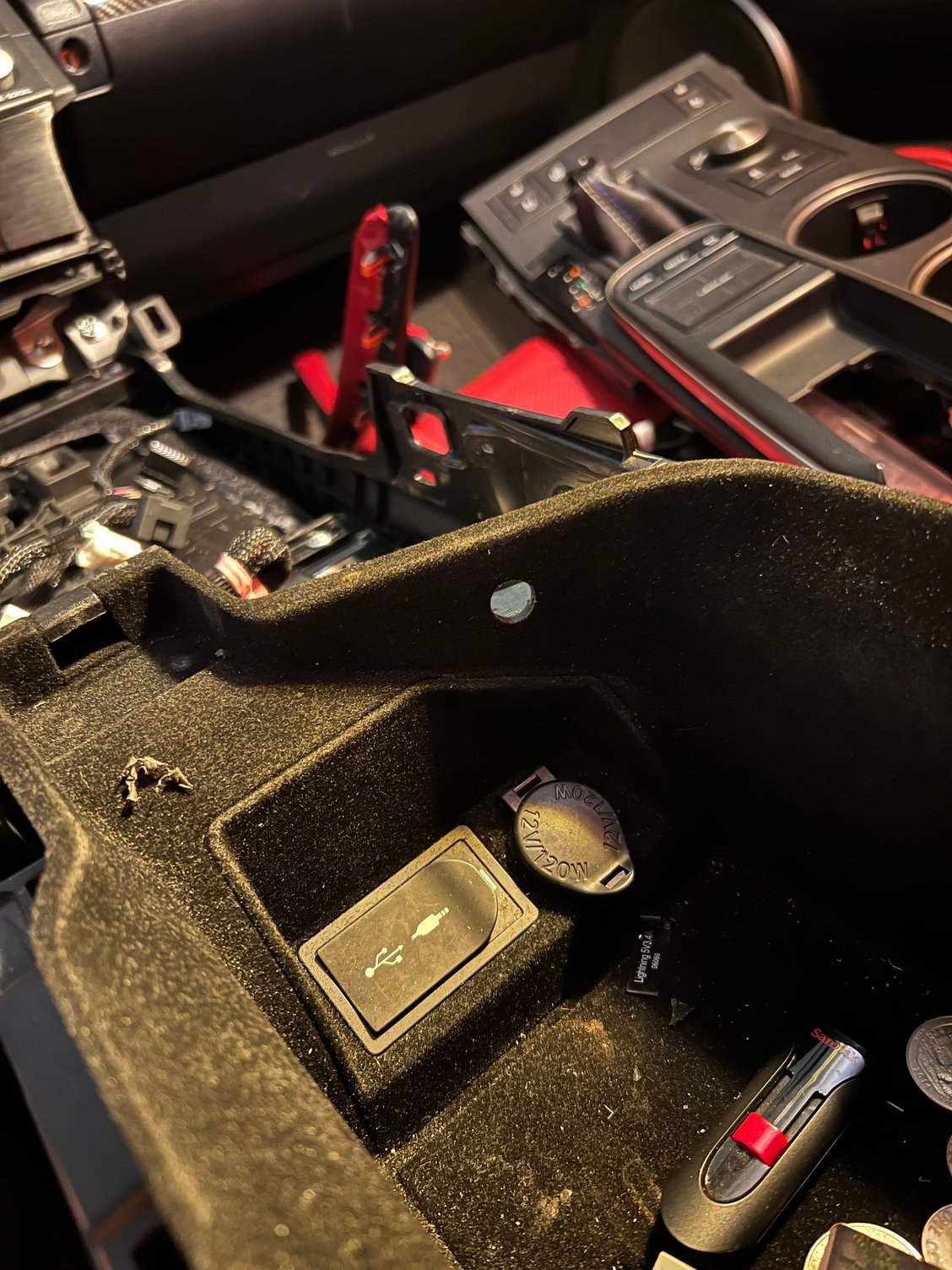

Default OEM+ Center Console Box Light
One thing that bugs me about this RCF is that there isn't a light in the center console box, so I decided to go my way about it.
No more scrambling around in the dark!

  #85
nigel821's Avatar
nigel821
Joined: Jan 2017
Posts: 1,533
Likes: 866
From: Virginia

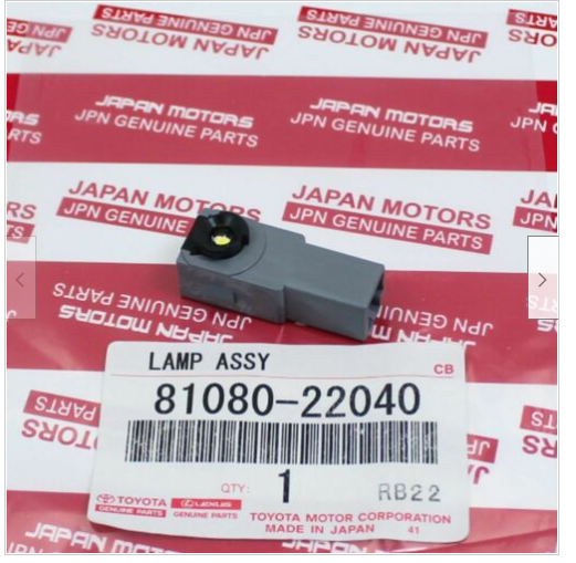

^ Great idea on the light!
What is the part number or part that the LED light is from (vehicle)?
I want to do the same thing now.
Did you glue the led from the inside the console or is it just press fitted in the hole?
Looks OEM.
-Nigel
Old Mar 9, 2022 | 07:07 AM
  #86
IntrinoX's Avatar
IntrinoX
Joined: Nov 2017
Posts: 1,291
Likes: 617
Looks OEM.
-Nigel
1. I don't know part number. It's the center console light from the GS.
2. I drilled a hole and hot-glued it in place.
3. Thank you!

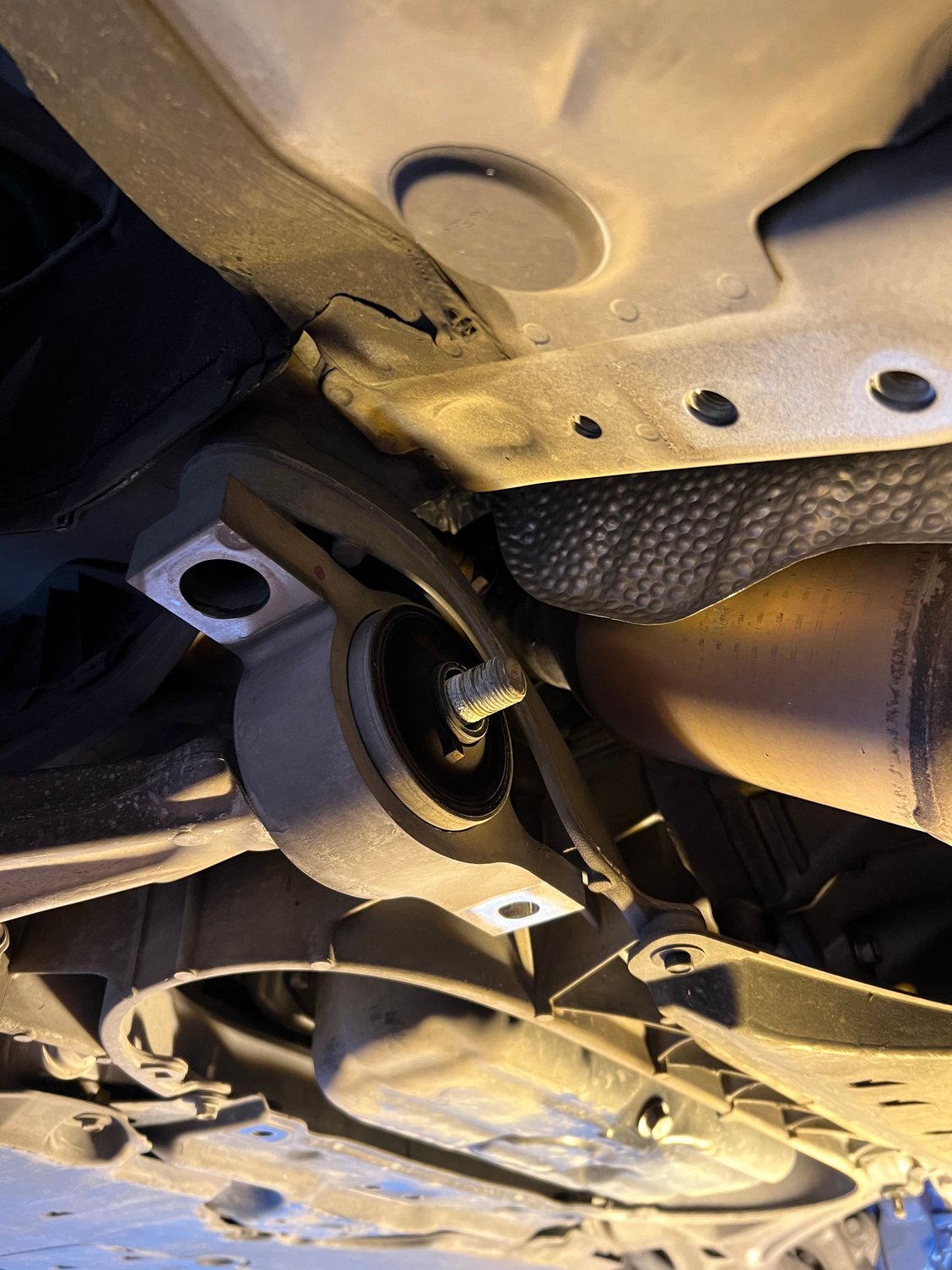

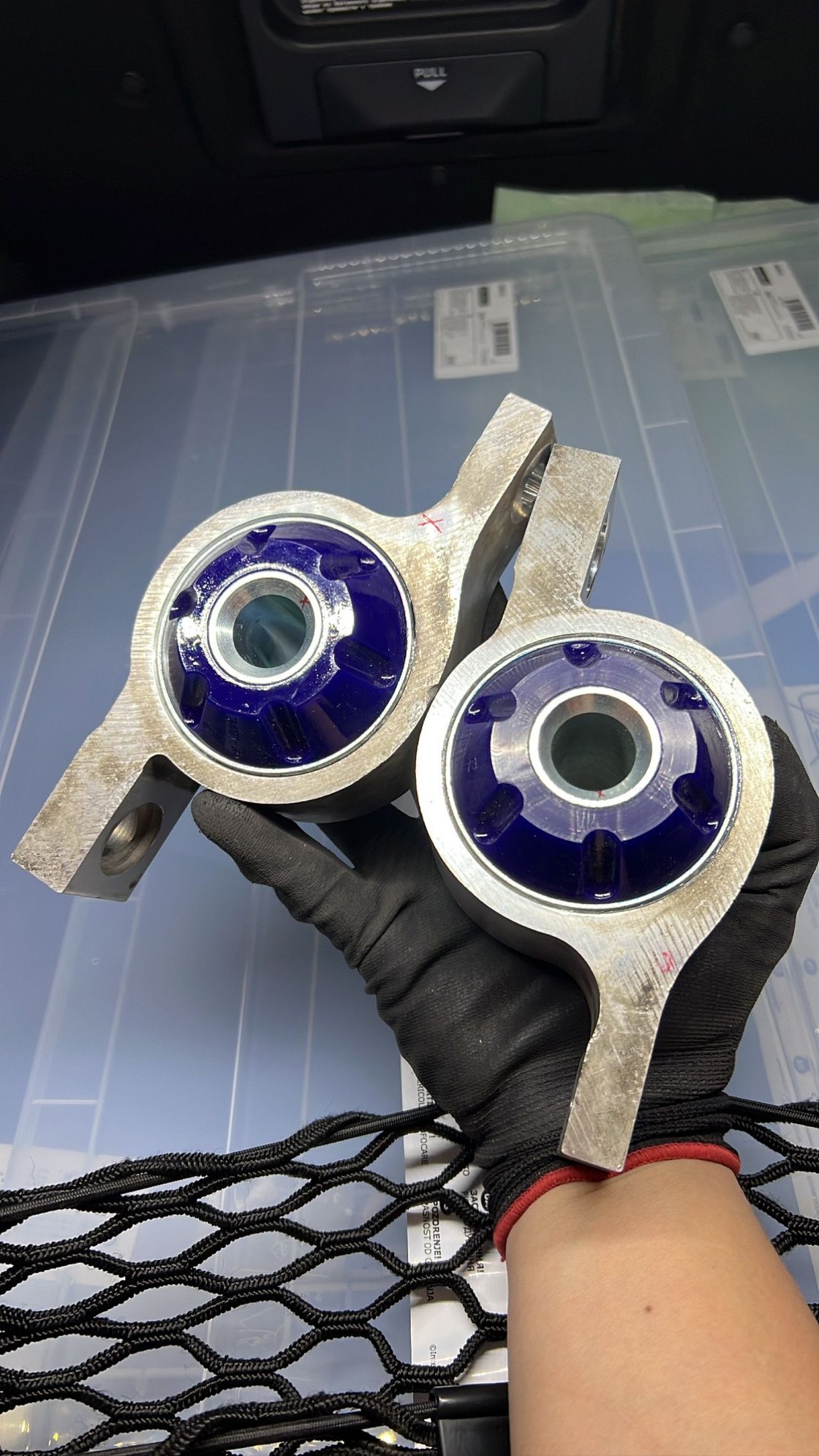

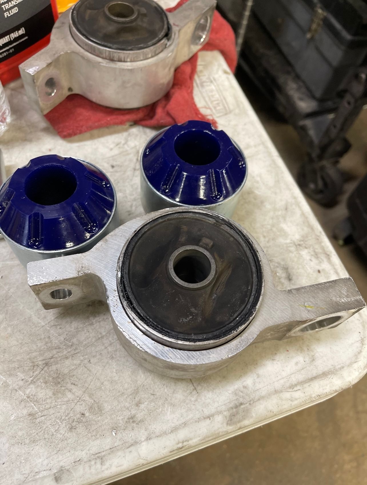

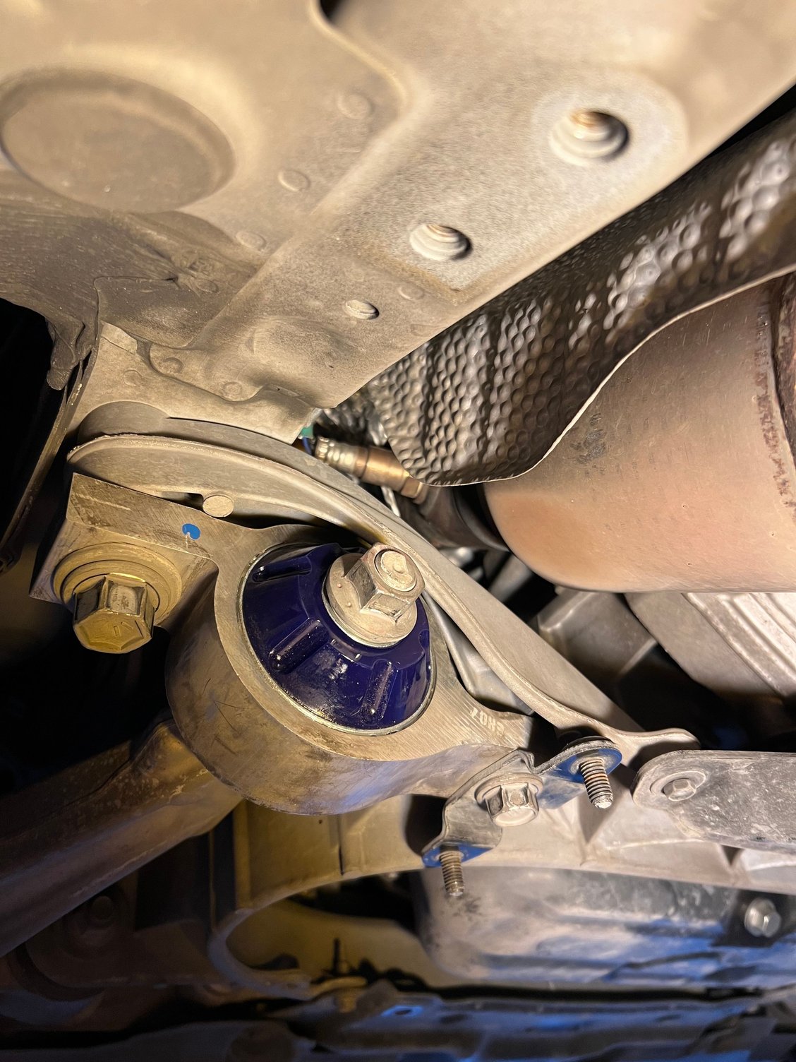

Default Fig's Engineering Poly 90 Front LCA Bushings
Got these Super Pro bushings from Figs pressed into OEM mounts. It helps with front inner toe wear and adds stability when braking. Overall, performs much better than OEM!

nigel821's Avatar
nigel821
Joined: Jan 2017
Posts: 1,533
Likes: 866
From: Virginia
Arrow
3. Thank you!
Nice!
Found it!
-Nigel
Old Mar 10, 2022 | 09:30 PM
  #89
IntrinoX's Avatar
IntrinoX
Joined: Nov 2017
Posts: 1,291
Likes: 617
Nice!
Found it!
-Nigel
Mm that doesn't look like it. The one I had had a frosted cover over the diode.
Old Mar 11, 2022 | 06:36 AM
  #90
nigel821's Avatar
nigel821
Joined: Jan 2017
Posts: 1,533
Likes: 866
From: Virginia
Arrow
Yea the frosted cover is just the cover that the black piece clips into. Toyota/Lexus puts a different cover on it depending on model and what color they want the light to be filtered at. LS, GS, ..etc.
-Nigel
