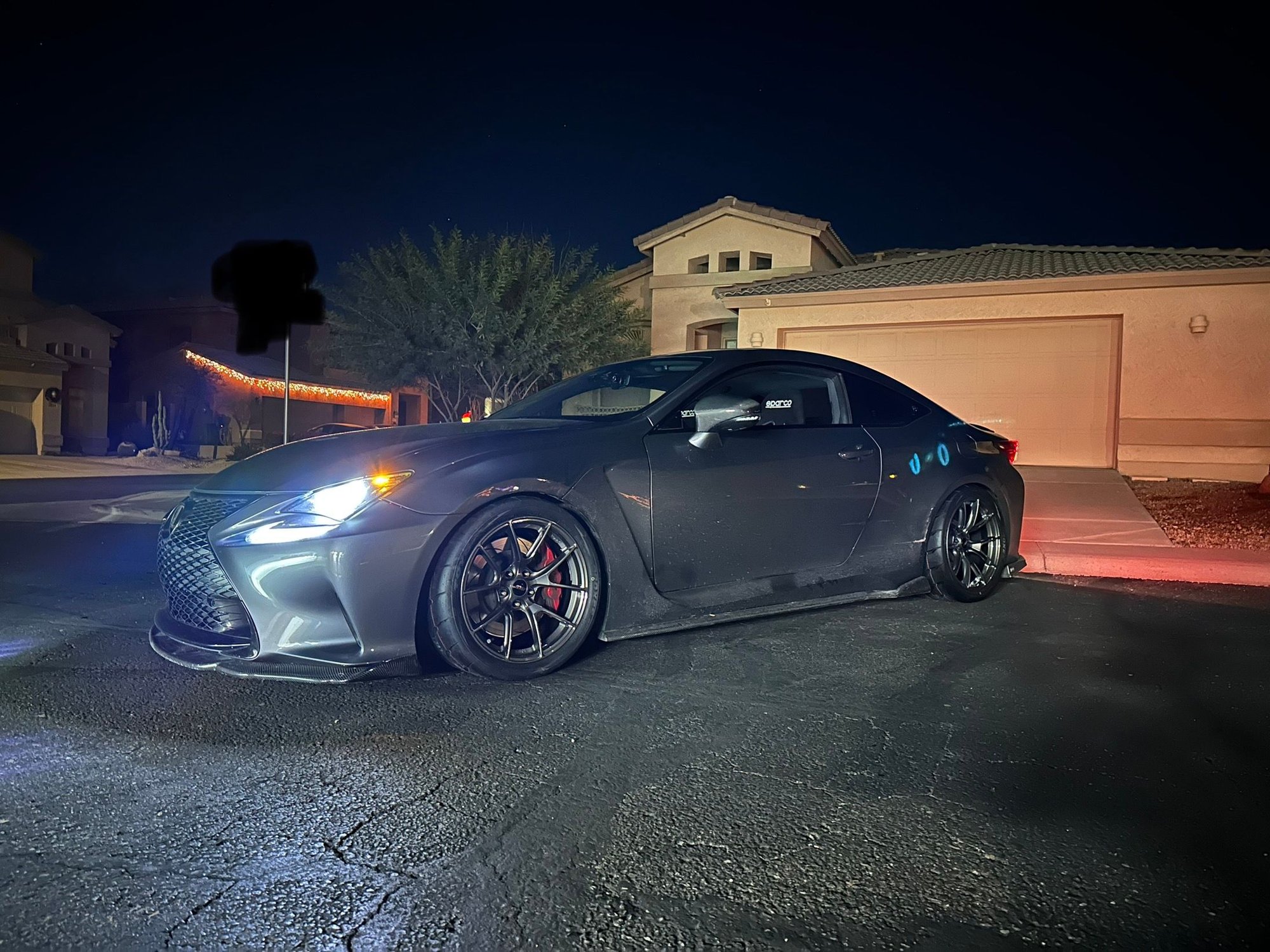

I had ordered a set of Lexon Japan fenders for the car back in march from Topendmotorsports. I was the first person in the US to actually get these, but supposedly PMD vip rushed a car out and got it installed on a facelift rc before I got my car back from the bodyshop. So take that how you will. Had some nia spats installed as well. bought some IS500 side emblems that im debating installing. Haven't committed to putting them on yet though. Take a look:
The car is now running better than it ever has, just have a few kinks to work out. It's finally Cooling off here in AZ so im excited to see 12lbs of boost again.

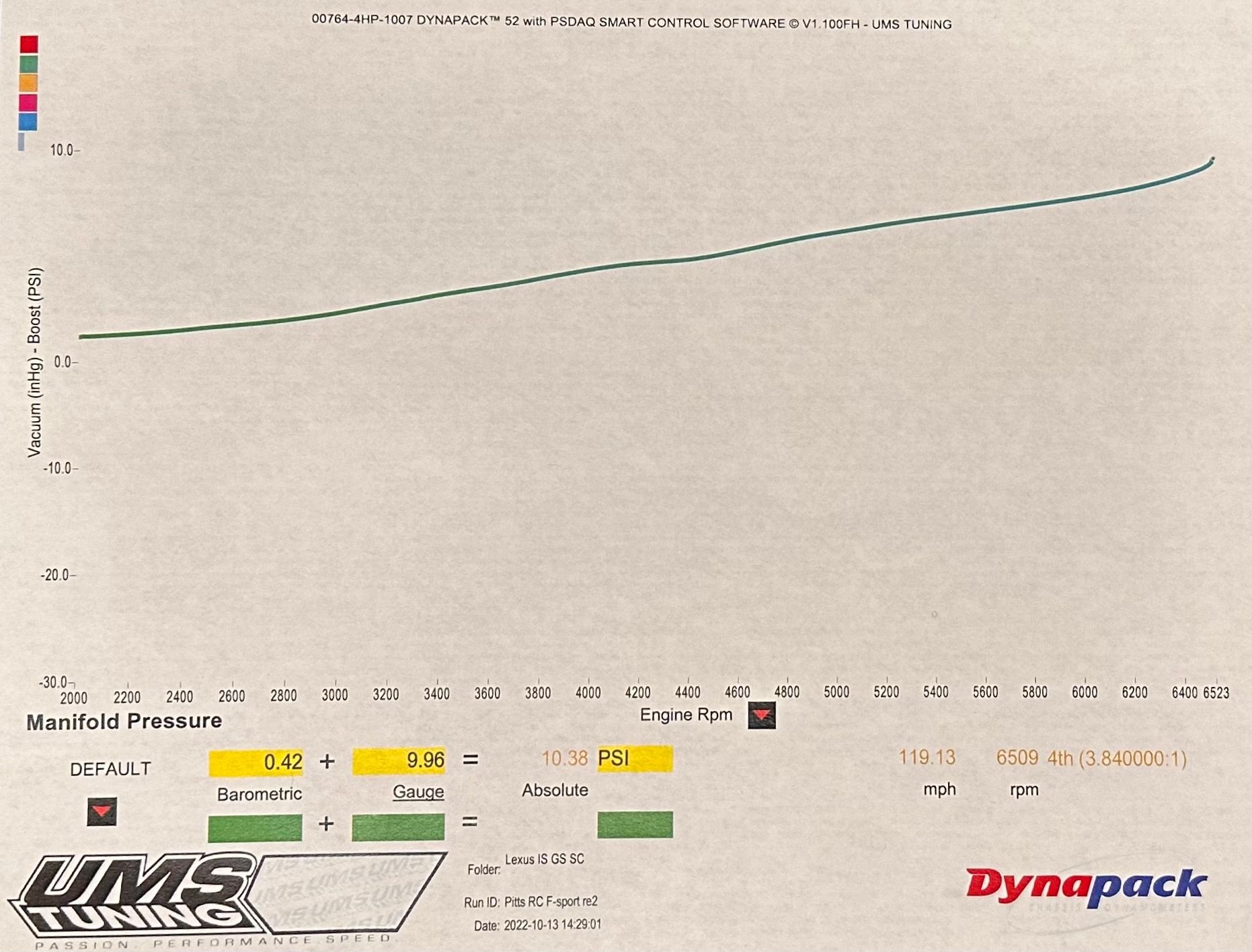

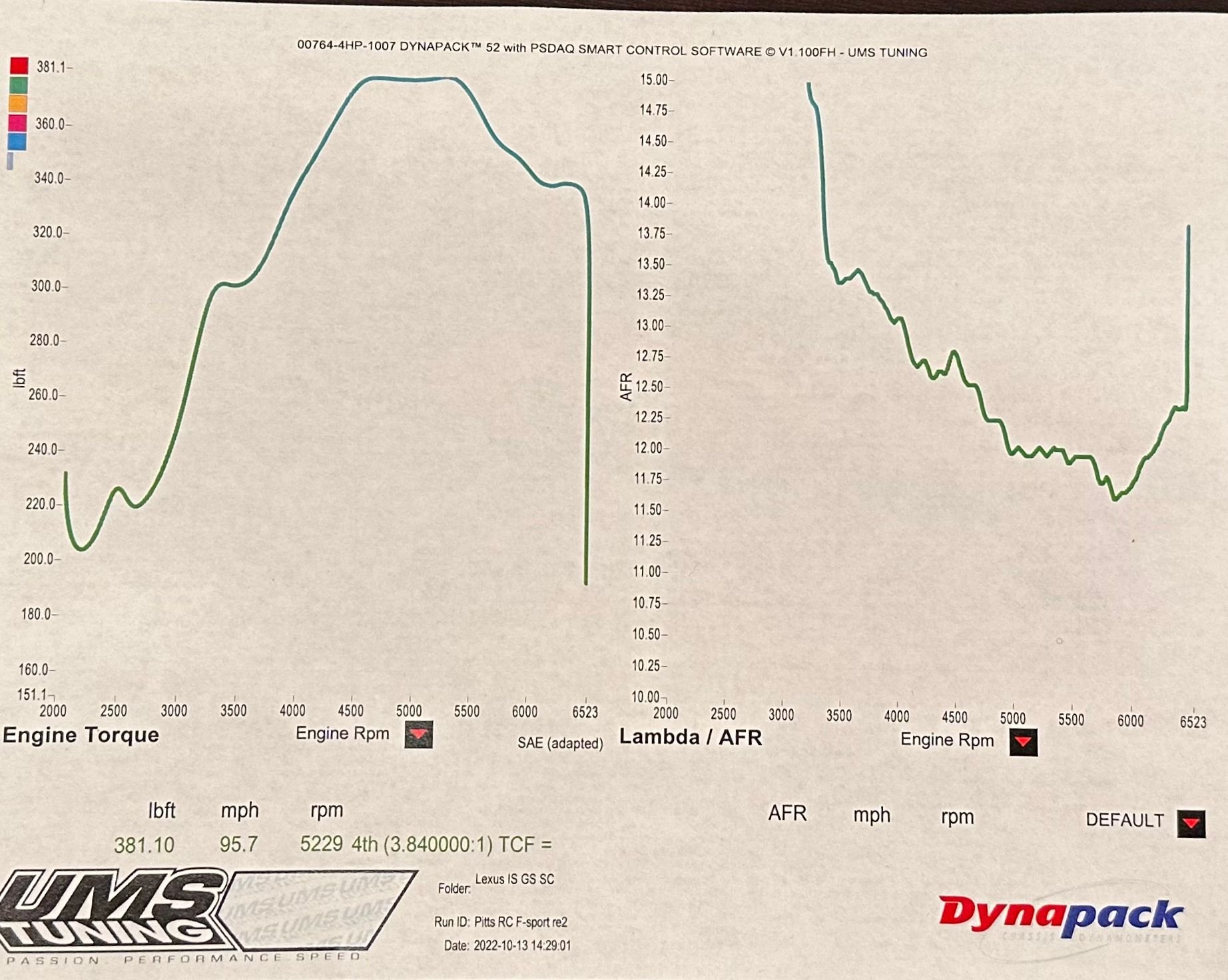

Finally hit the dyno with the supercharger. Got a solid tune in. ambient temp was 100 degrees yesterday so I'm anticipating the boost to increase come winter time here in Arizona. Here are the graphs:

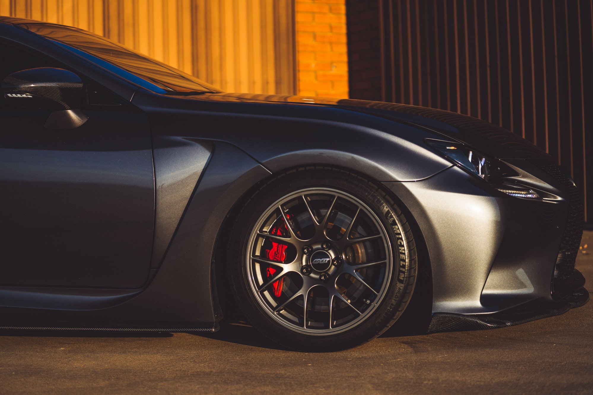

Here she is.
Apex VS5-RS Wheels, 18x10+40, with 10mm spacers, so really it's 18x10+30.
Wrapped in a beautiful @toyotires @teamtoyoUSA Proxes R888R, 295/30/18 FRONT AND REAR.
I present to you, the widest documented square fitment on an RC350.
ignore the Ferrari damage. lol. still twiddling my thumbs waiting for insurance.
