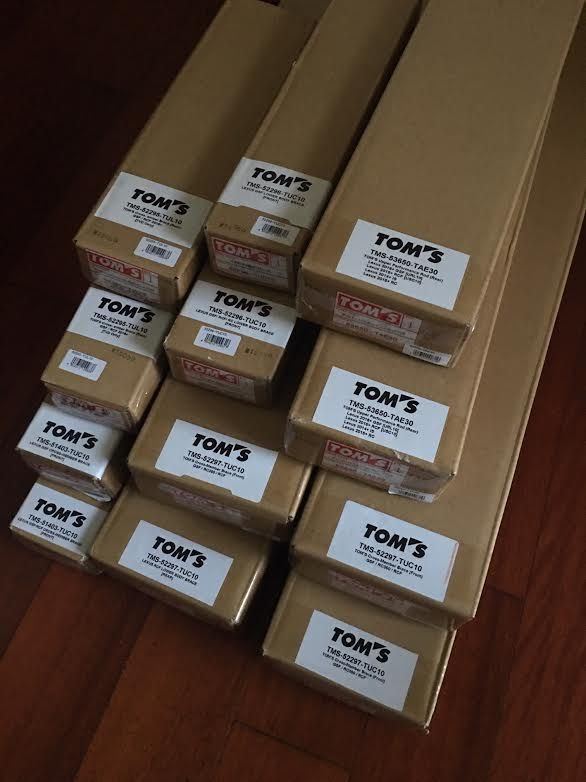

TOMS suspension bracing: Got these recently from good ol Josh from Meraki! Car feels so different - like night and day to me personally. It makes the F feel more nimble and responsive and I can't wait to pair it with my suspension upgrade.

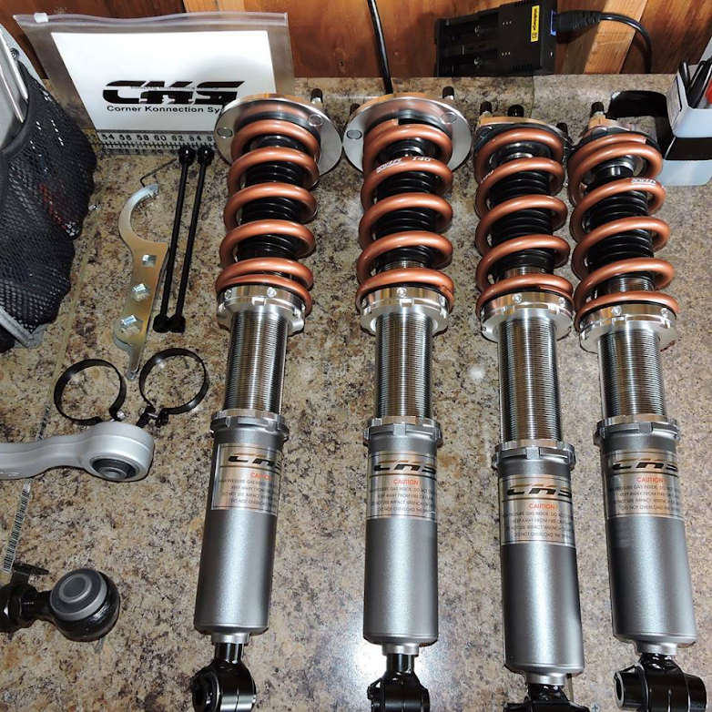

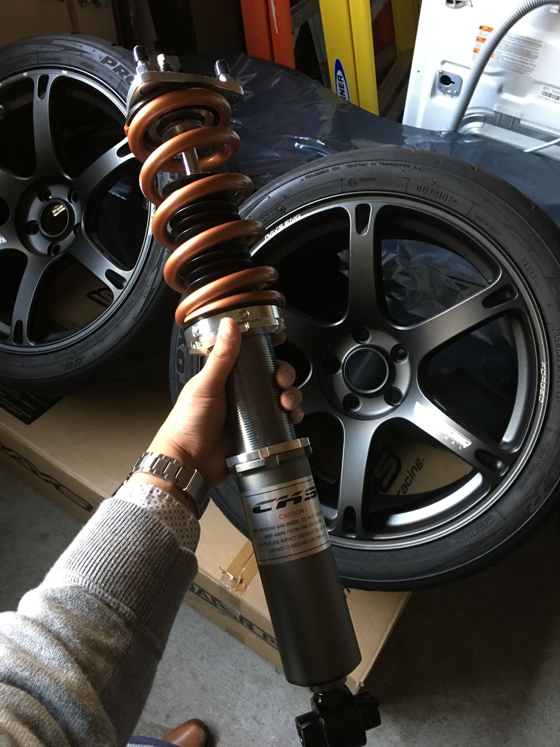

CKS coilovers + Swift Upgrade + Air Cups (Photo courtesy Louie): I'm not quite done with air just yet! My driveway is pretty nasty so I need some form of height adjustment so I decided to go with cups. Performance/reliability of a coilover setup with the height adjustment of air. Planning to order these from Louie soon.

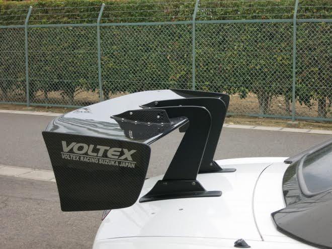

Voltex Type-7 Swan Neck: Ordered this and will have a friend's shop fabricate custom base plates + reinforcement plate for this. The goal is to retain the active wing and mount it on the non-active portion of the trunk.

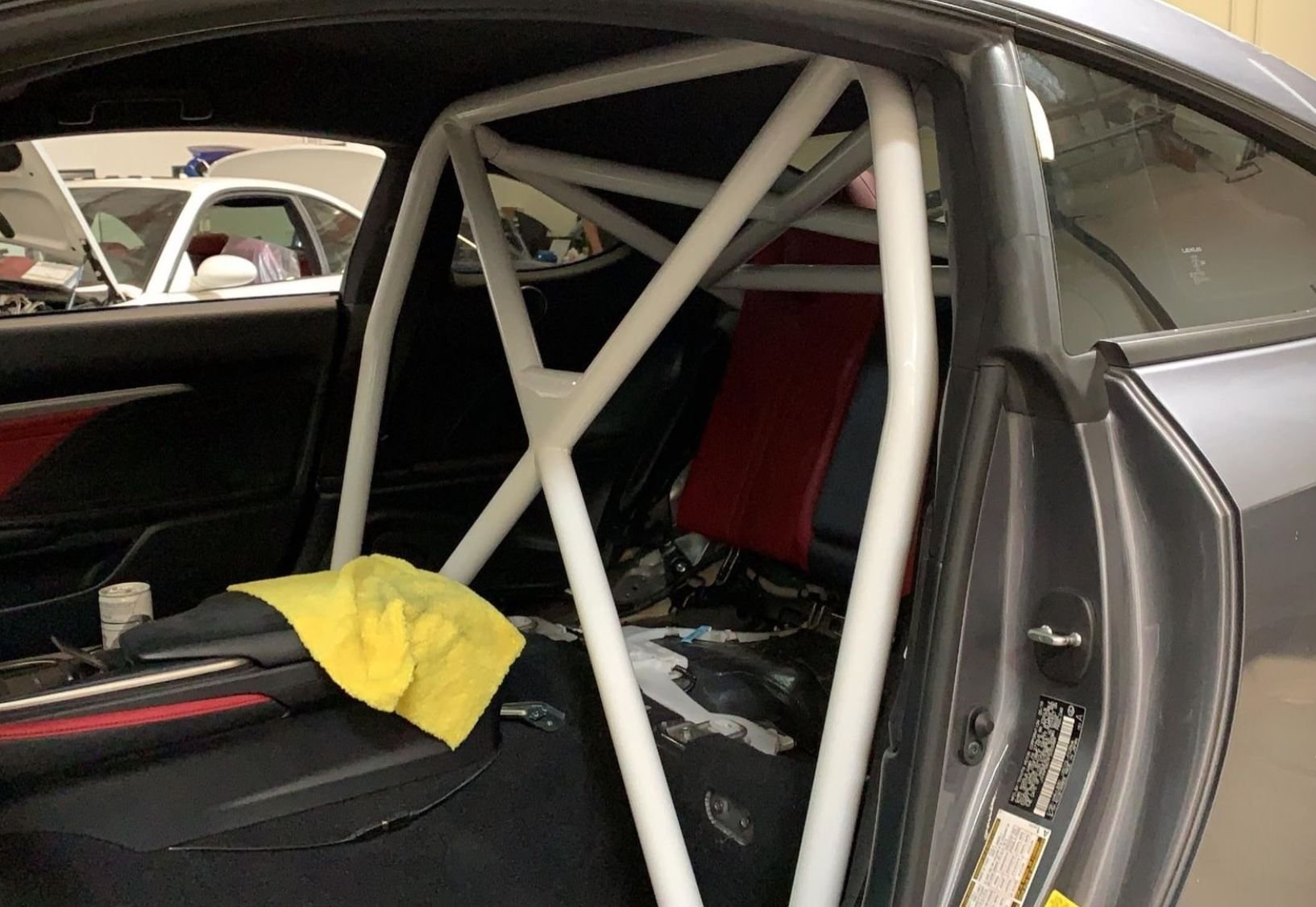

I'll get you pics of the cage tomorrow most likely. My friends are coming back from SoCal tonight!

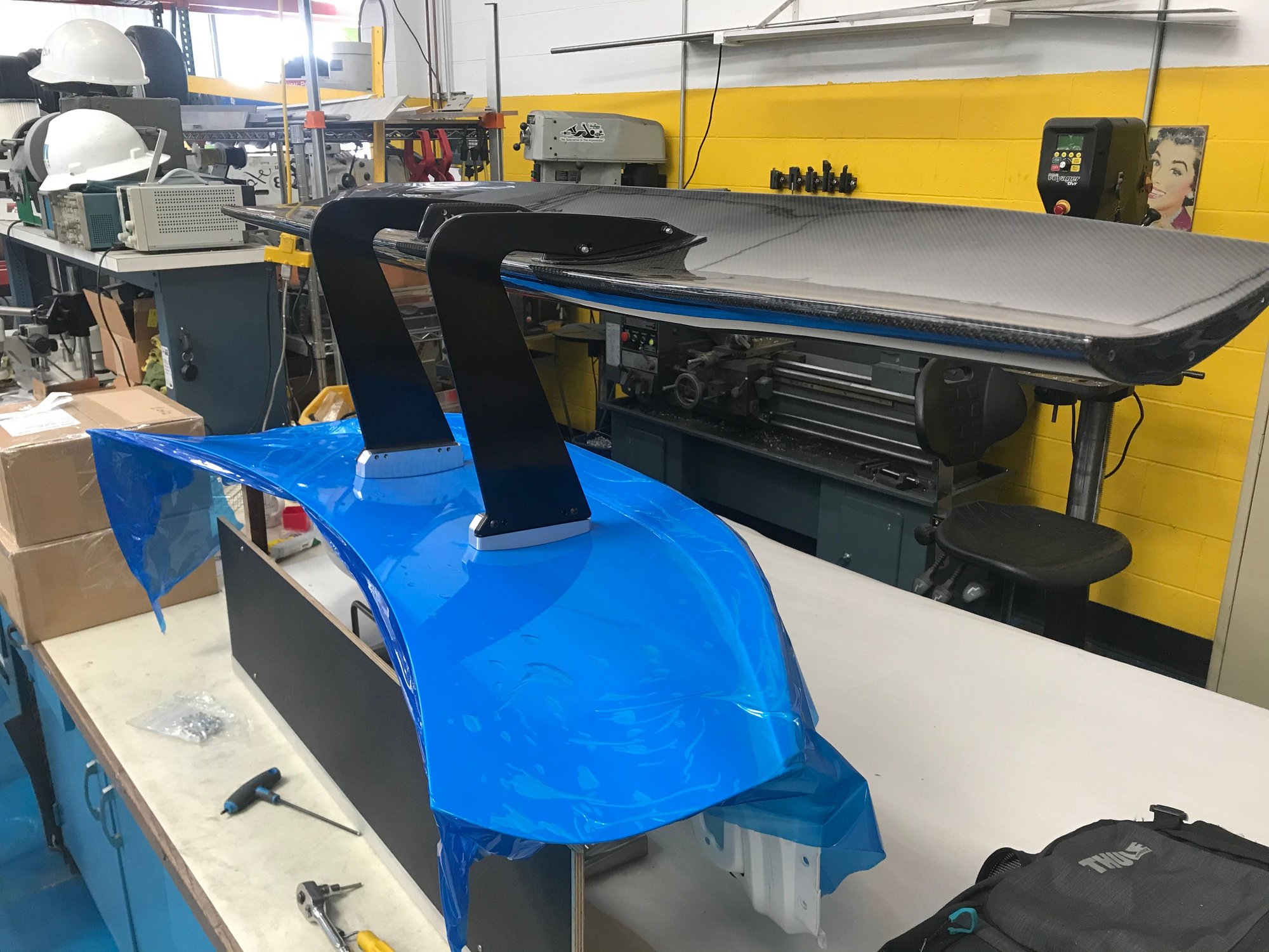

We have to cut the swan neck portion of the Voltex wing because it's a little too long. If I mount it on the non-active it'll hit the rear window when I try to open the trunk. End plate fabrication soon along with reinforcement plate.

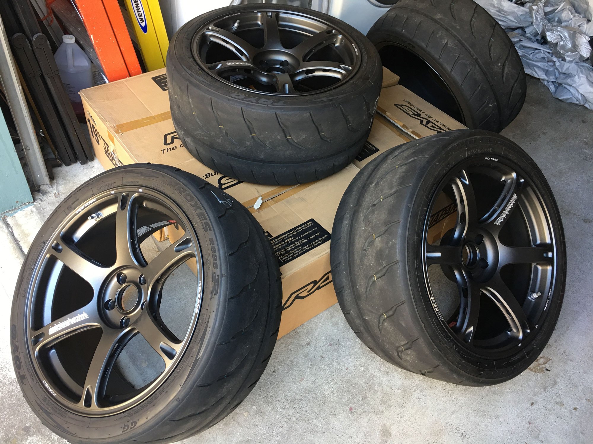

Went ahead and ceramic coated the wheels this weekend also

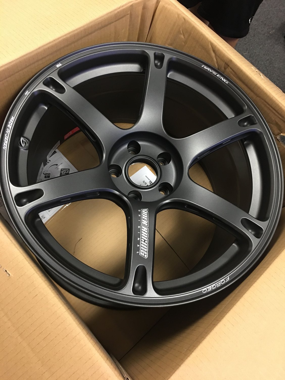

Slapped on the TE037 6061 wheels and my new suspension setup: CKS Coils + Swift Springs + StanceParts Cup Kit. Installed FIGS camber arms in the rear also. Still working on getting it dialed in completely for track but Mingofish has been a huge help!
Bags were great for overall use but they're not gonna be as good as a solid coilover system on the track which was my reason for switching. Paired with USRS/Toms Bracing, there's no such thing as body roll and I can take corners with an insane amount of confidence (partly due to R888R too).
Unfortunately, even after cutting some liner in the rear, there simply isn't enough room to fit the cup kit so I only have front adjustments. Pray for my Artisan diffuser when it gets installed LOL

You didn’t tell me rear cup kit didn’t get installed. Huge bummer.
Is it the cups too big to fit where it bolts up to the shock tower? Or just not enough travel on the threaded body to accommodate the extra distance?
Envious of your cups even if just fronts. Scraped up my Tom’s front lip other day...
Any NVH from the front end due to all those extra parts?
Just buy a new trunk deck since you have the wing already!
I have the deck but gotta wait who knows how long for my voltex to show up. Sigh..
Oh I thought I told you LOL. Yeah, the rear cup kit is too wide. We're already at minimal space using a true coil system in the rear. We couldn't get the strut to line up and bolt properly. All good though - I just kept two cups as backup in case I have any issues or any of my friends want to cup their fronts.
Shoot sorry to hear about the lip! No extra NVH in the front - it's just a cup that fits over the coil so not too much up there.

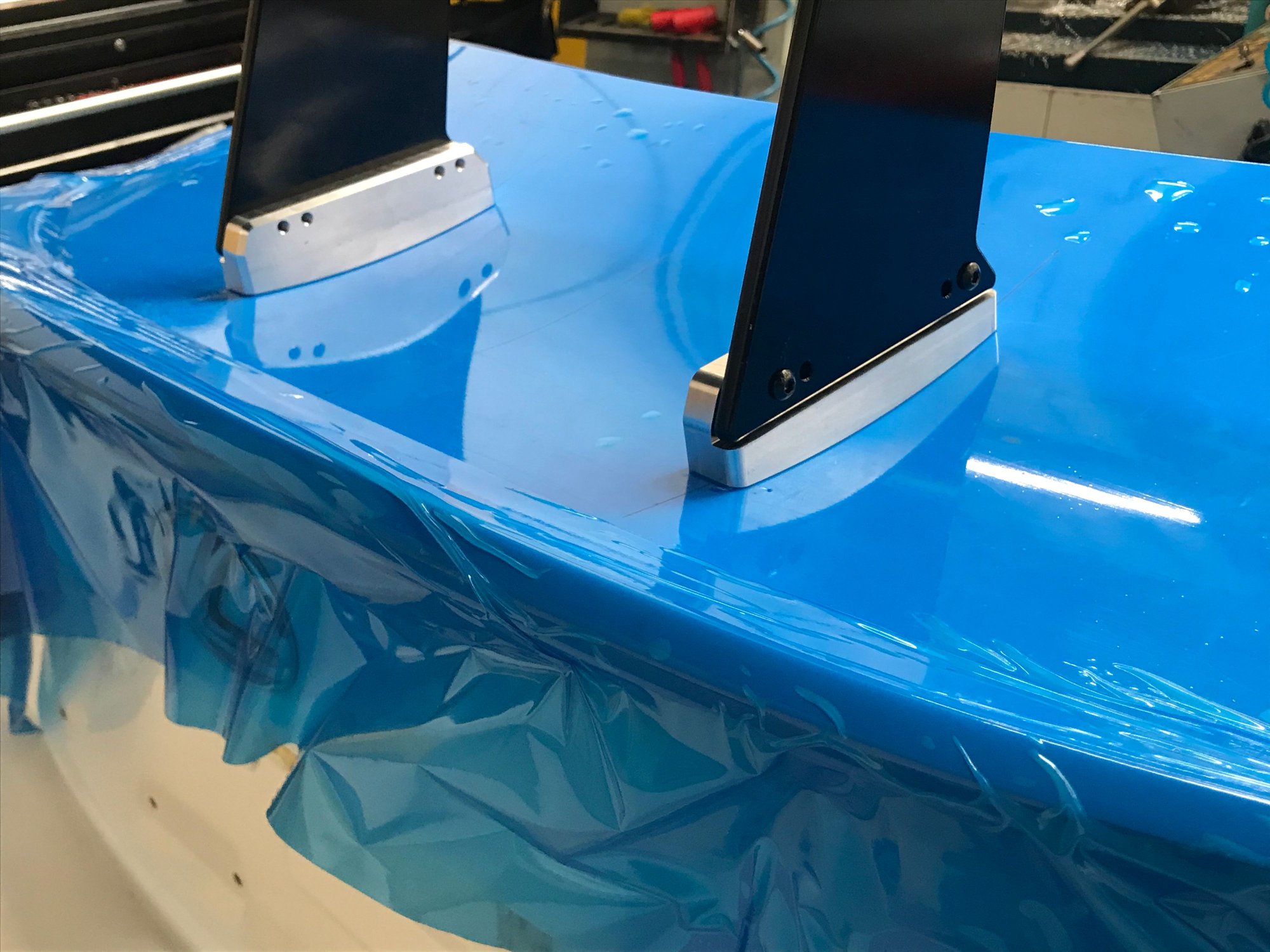

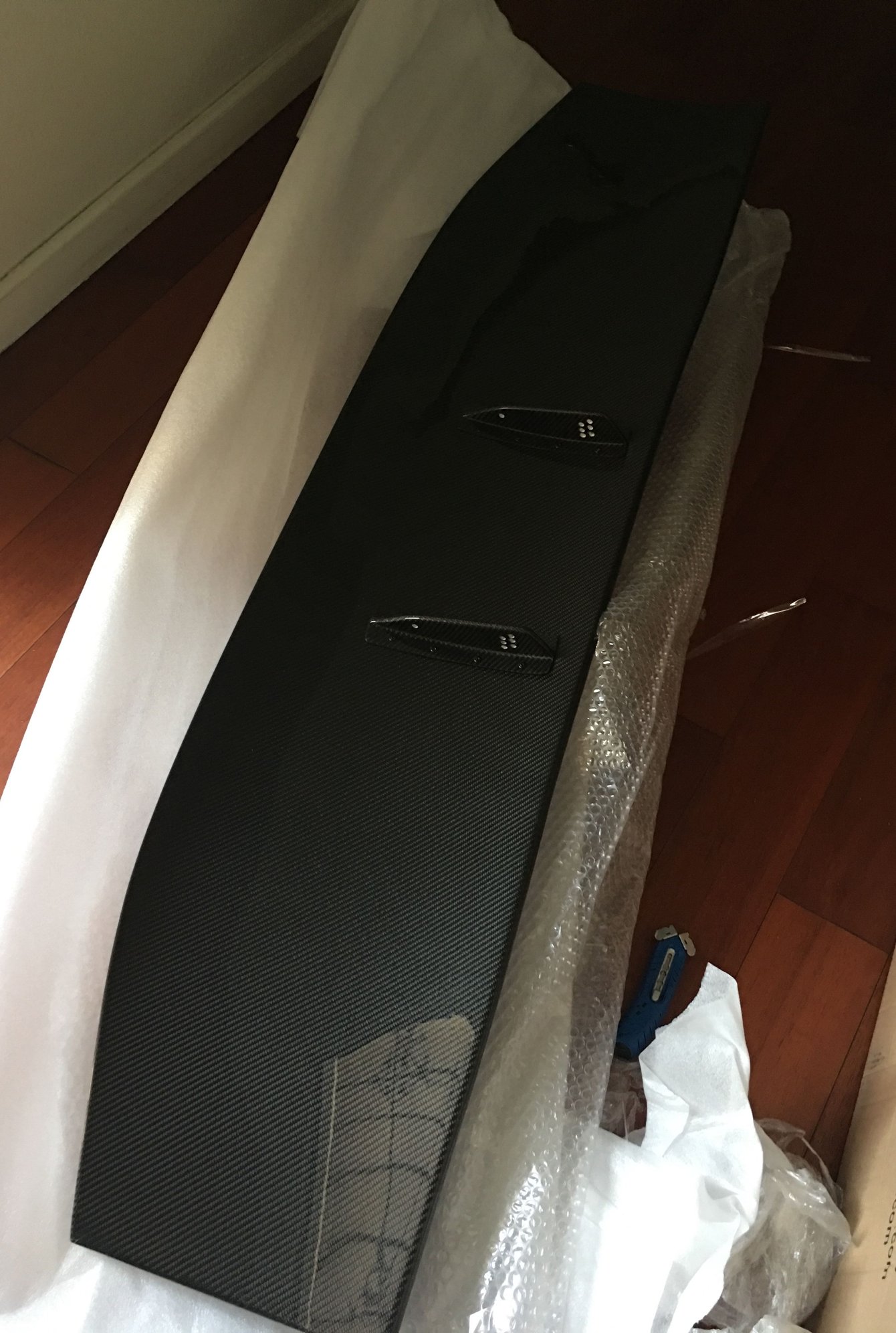

Voltex Type 7 Swan Neck: Purchased the RC350 trunk and had ArtecFab in San Carlos fabricate me these base plates. They're also reinforcing the interior portion of the trunk to make sure it holds up without issues on the track.

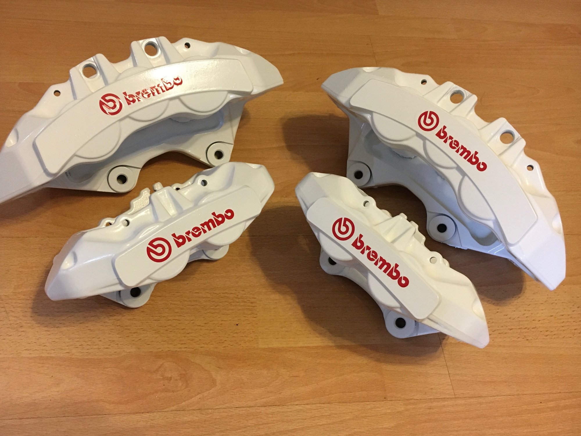

Changed brake caliper color to white because I was getting a little bored of the yellow.

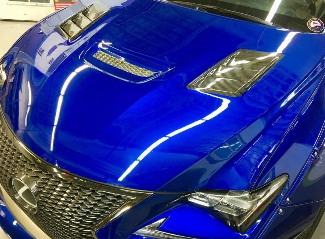

Also seriously considering the hood vents from slickcarbon! I wouldn't mold it though as I've heard that with the molding material, it can weaken over time so I'd rather have them just bolted on.
I'll update this when the trunk gets painted and the wing gets clear coated. Should be on the car in a few weeks!

White calipers look awesome!! Wonder how they hold up long term with all the track rubber and 800 degree brake dust....
Funny you’re looking at vents. Was just thinking whether I should chop up my hood.

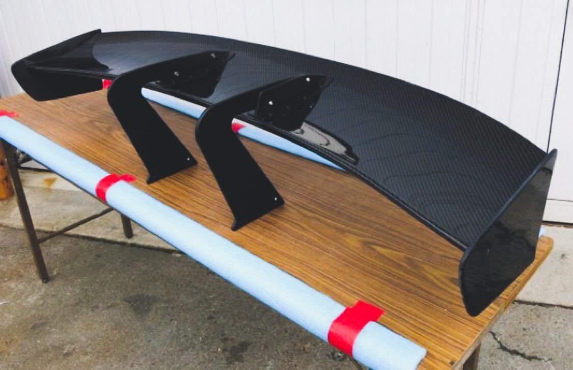

Ming was showing off his sweet wing setup so I had to finish mine!
Pictures were taken before the Voltex decals were added +
Alpheyga GT4 splitter coming soon along with paint on the Artisan Spirits side + diffuser.
enjoy
