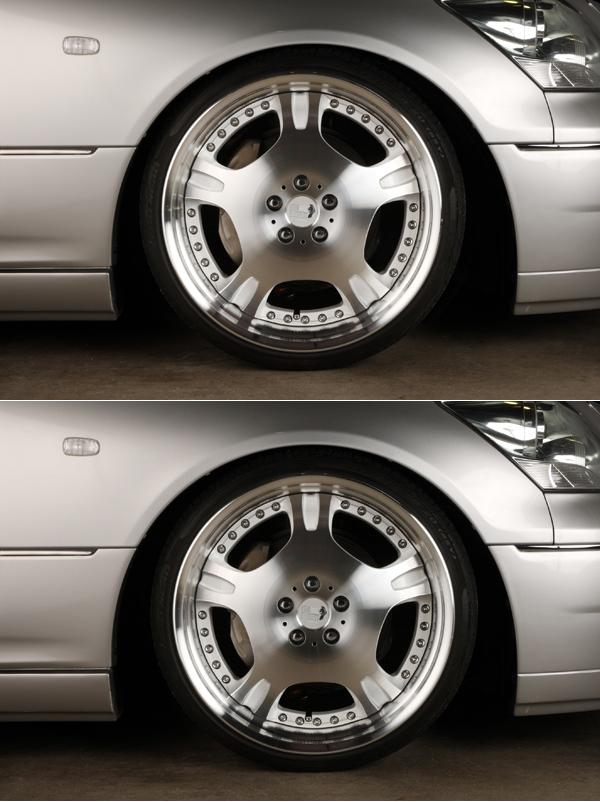

Thanks! For some reason when you lower the LS, it doesn't get much front camber. Also, this car has caster issues. When lowered, you will notice the front and rear wheels aren't centered in the wheel arches anymore. The camber adapter will correct this caster issue and will add more negative camber as well as lower the car even more. So it corrected every issue I had.
As for the rear arms, I wanted the rear camber to match the front and to be able to recenter the wheel in the wheel arch.
You can see what I'm talking about here.
