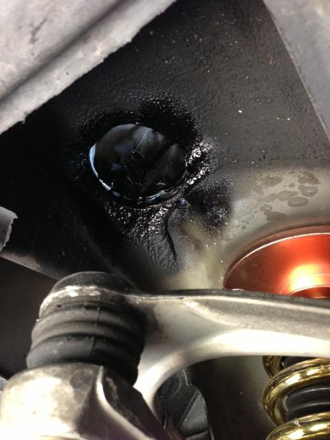

Small update. Since I got my coilovers my front upper control arms keep banging the top so I cut some holes.
I used a 2 1/2 inch hole saw. A carbide one is more expensive but it will cut much smoother and last longer.
Look to see where it's banging and drill a pilot hole to the top.
Then use that hole you made to guide the holesaw down.
Use some sandpaper and smooth out the edges. I made a slight mistake so I had to touch up a few spots.
I covered the top with some tape and sprayed it with some paint so it won't rust. Then I used touchup paint for the top. I'm looking for a rubber gasket that fits the hole to keep the dust out. It's nice because the LS has engine covers to hide the holes. I have no more UCA banging problems.
