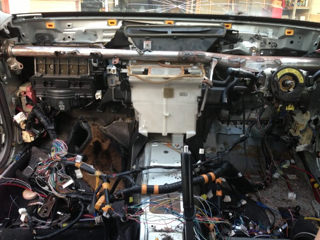

i need a rhd uto altezza main harness .... or a wiring schematic for the main harness... ive been looking and still nothing ...any help or links would be great... the jdm harness i have is for manual and im keepin my car auto for now ... this is the only thing holding me back now...
