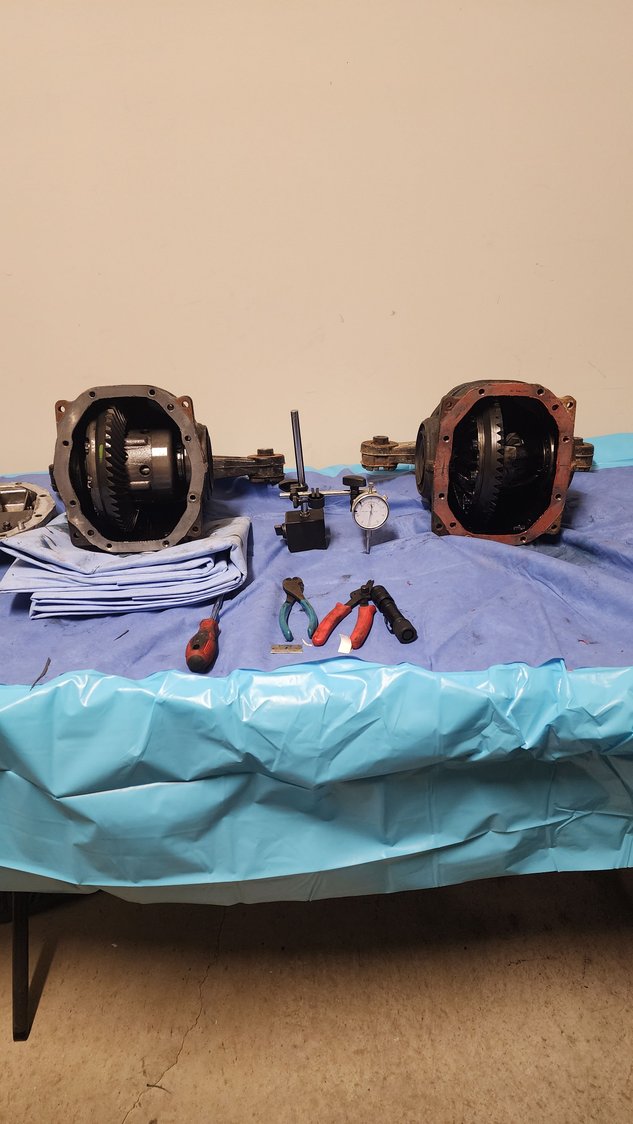

and then right after that I got a similarly attractive deal on a gently used rcf lsd that I am working on swapping to my stock 3.77 gear ratio before I put it in. that will also be getting new urathane bushings when I get around to putting it in.
in the background I have still been going back and forth with vf tuner trying to get more comfortable with the software since I have had limited sucess with piggybacking the computer as many have done for older models, this generation is more finicky about signal interception, and since there new update I am optimistic that I should actually be able to do a decent mild ecu reflash to correct my fuel trims and give me more power. so fingers crossed in the coming months I will have the ecu dialed in and I can go back to the dyno and see what it makes and keep improving on the tune.
