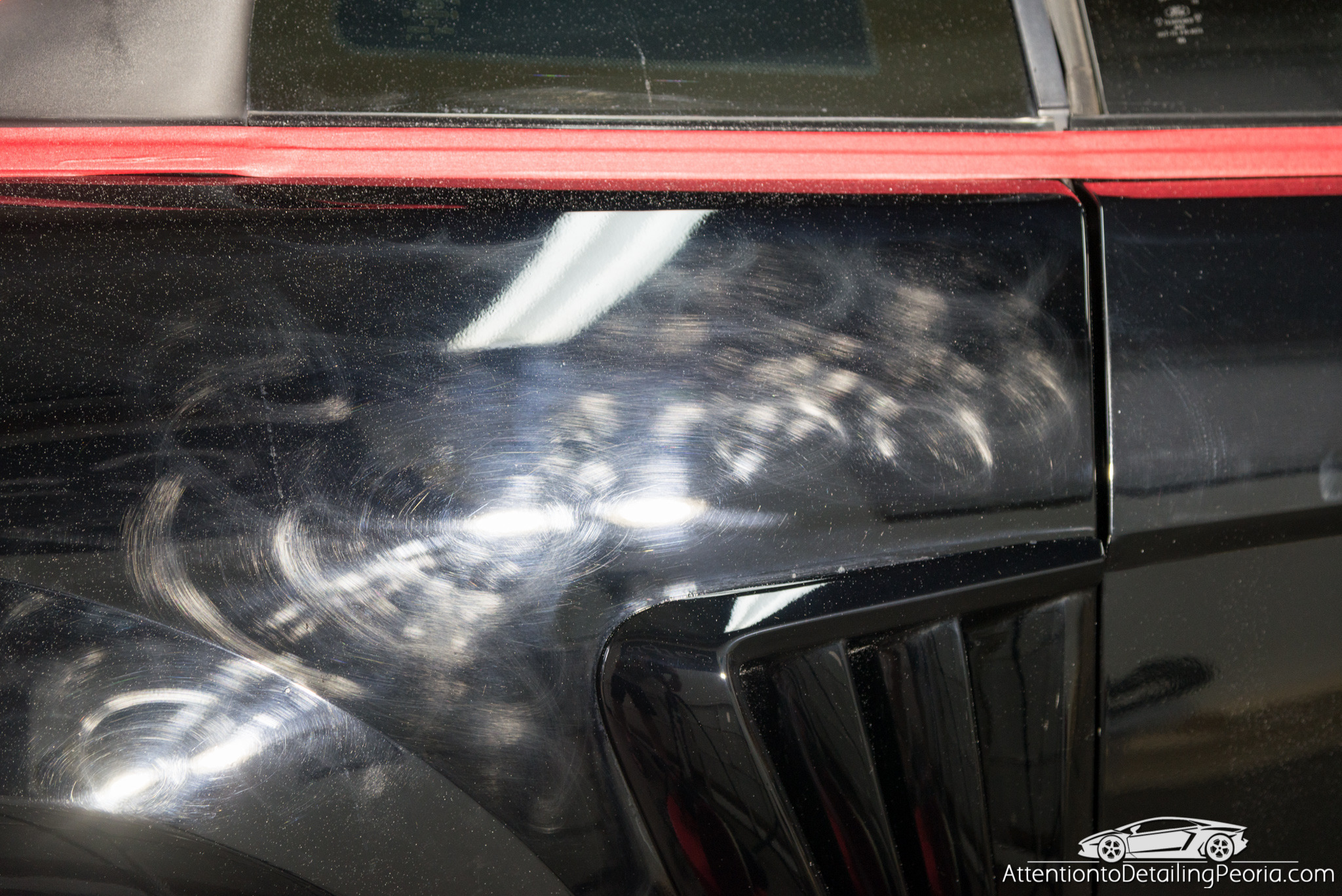

Here is a jet black mustang that was severely neglected. Notice the massive amounts of defects in the paint that have created a very lack-luster appearance.

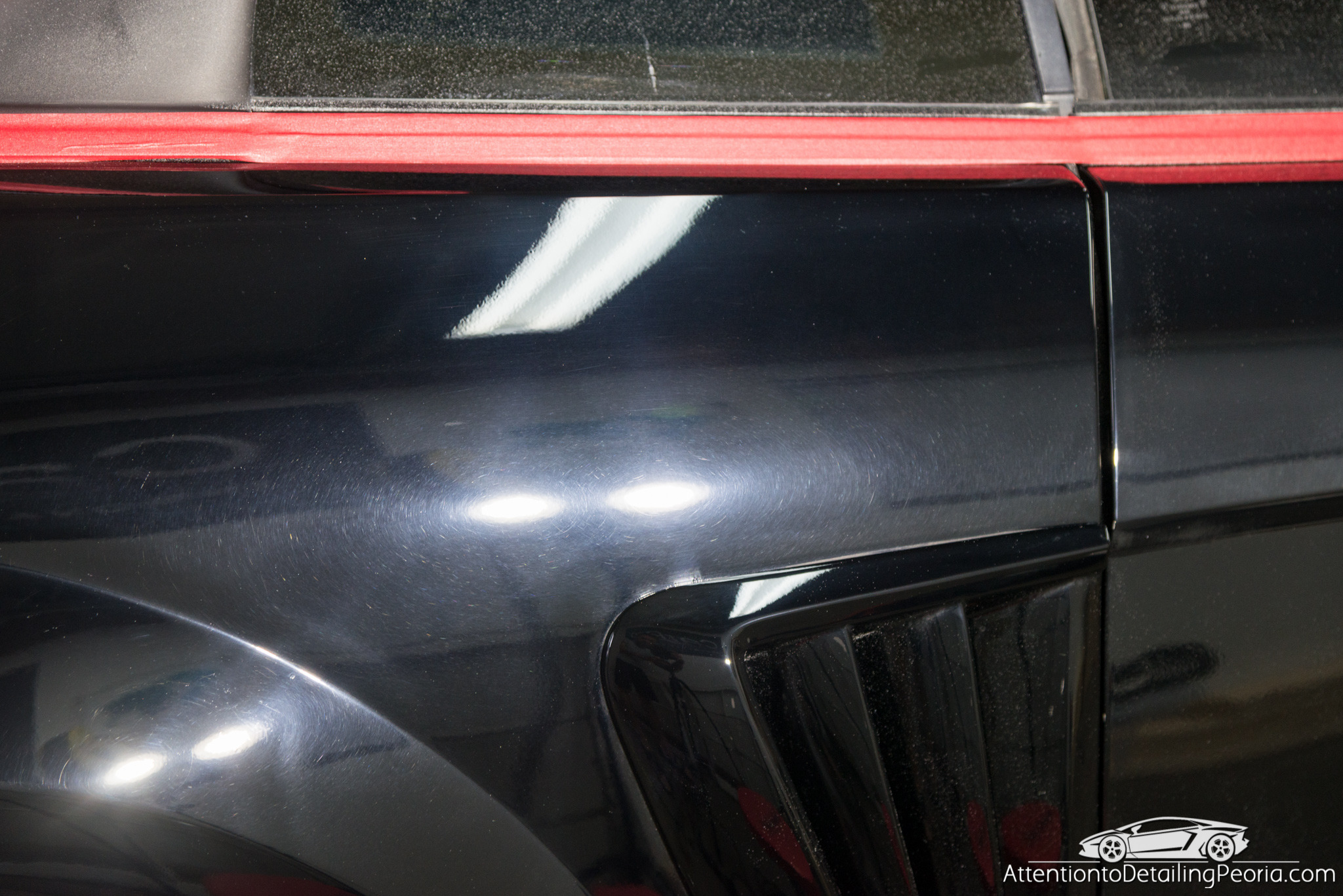

After heavy compounding, the defects have been removed, but you will notice the paint still does not look so great. There are tick marks known as micro marring all over which still leave a dull/faded look. This micro marring is a product of heavy cutting and is to be expected. This is why we must follow up with a series of finer polishes to fully restore the paint.

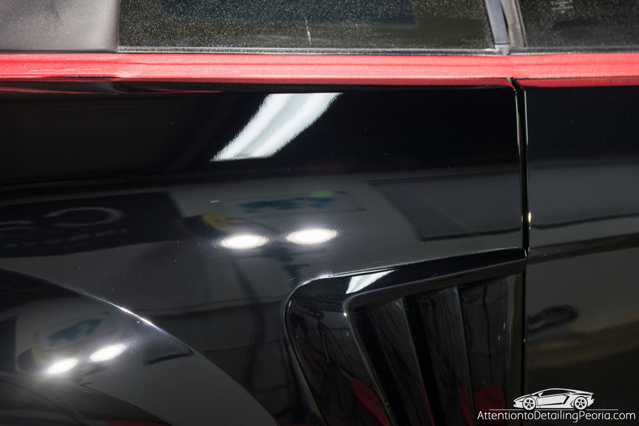

You will notice in this photo, the paint is now deep and black. There is no detectable marring after a careful polishing process, and the defects are almost entirely gone. A successful correction.
