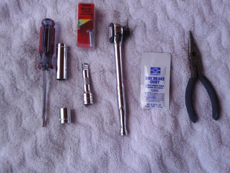

Size:  93.4 KBhere are some things you will need. 14mm deep socket and regular socket, needle nose pliers, flat head screw driver, brake cleaner, disc brake quiet, hammer, c clamp or a brake caliper tool, equipment to lift vehicle and remove wheel, and a m-8 1.25 screw.
this screw will be used to remove rotors.

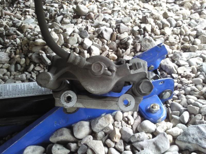

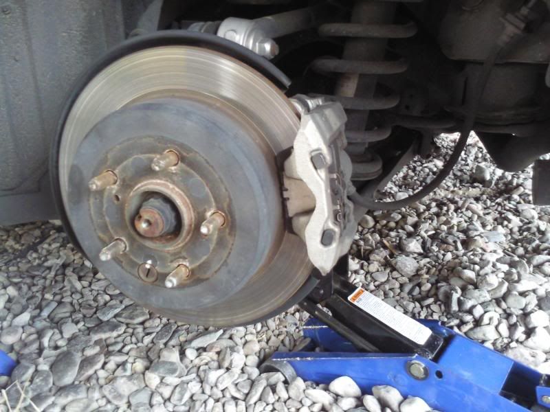

start by lifting one side of vehicle first and remove wheel.
Size:  44.9 KB romove 14mm bolt, and a second 14mm bolt on the bottom side
now u can remove the whole brake caliper.

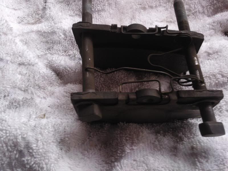

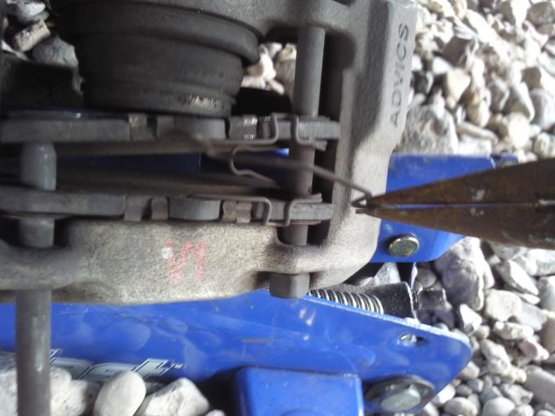

now with the caliper removed u can remove the brake pad slide pins retainer pins and brake pads
you will need the needle nose pliers to remove the retainer pins.
now that the those pins are removed the sliding pins will slide out
make sure u keep these pins and do not brake them or discard them
Size:  59.1 KB here are some other angles on how they go together for more reference.

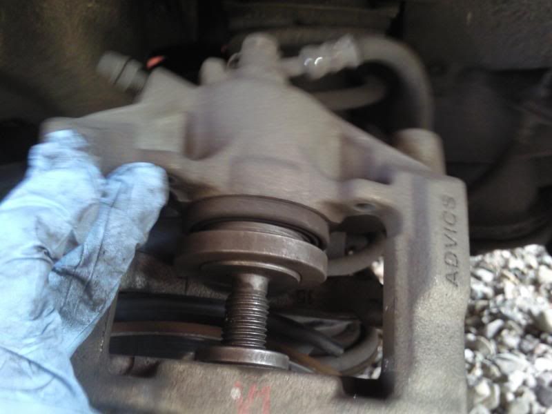

now u will need the caliper tool or c clamp to push the piston back into place.
now with the piston back in place u can take this time to paint your caliper if so choose to. use a towel to cover up the inside of the piston and moving parts before you start to paint.

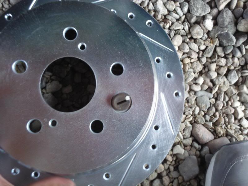

now with the disc removed, if you are going to replace the disc remove the rubber groment from the old disc.
you will take this and place it on the new disc and put the new disc on. it should just slide on no screwing on or pressure needed to put the disc back on.

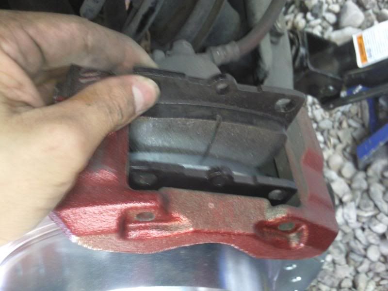

now you will bolt the caliper back on into place without the new pads in.

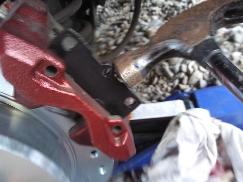

after you bolt it back on you will place the new outer pad in.
with the new pad a few love taps should get it to slide into place.
now that the pad is in u can slide the inner pad into place.

Is it safe to jack up your car on gravel!?
Old 07-09-09, 08:29 PM
Phiber
Phiber's Avatar
Join Date: Jun 2009
Location: CA
Posts: 773
Received 0 Likes on 0 Posts
it should be fine, he has jack stands on the frame also..

Guys, jacking a car on gravel is a bad idea, also jack stands should be used, its not fun to drop a car on the ground because of a faulty jack.
Also, if you don't need to replace the rotors, you can just pull the spring clips and use a big screw driver to push in the piston.
