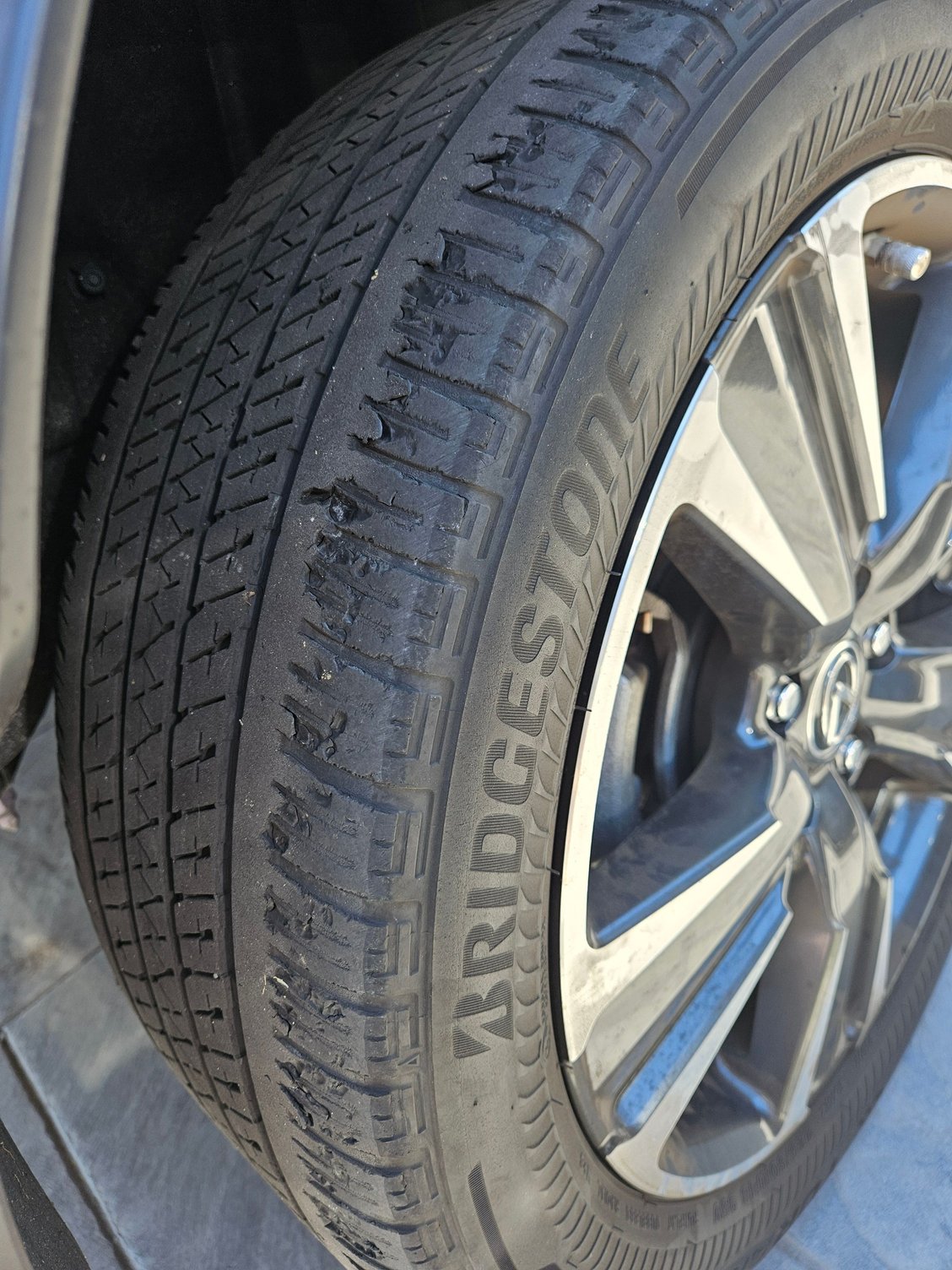

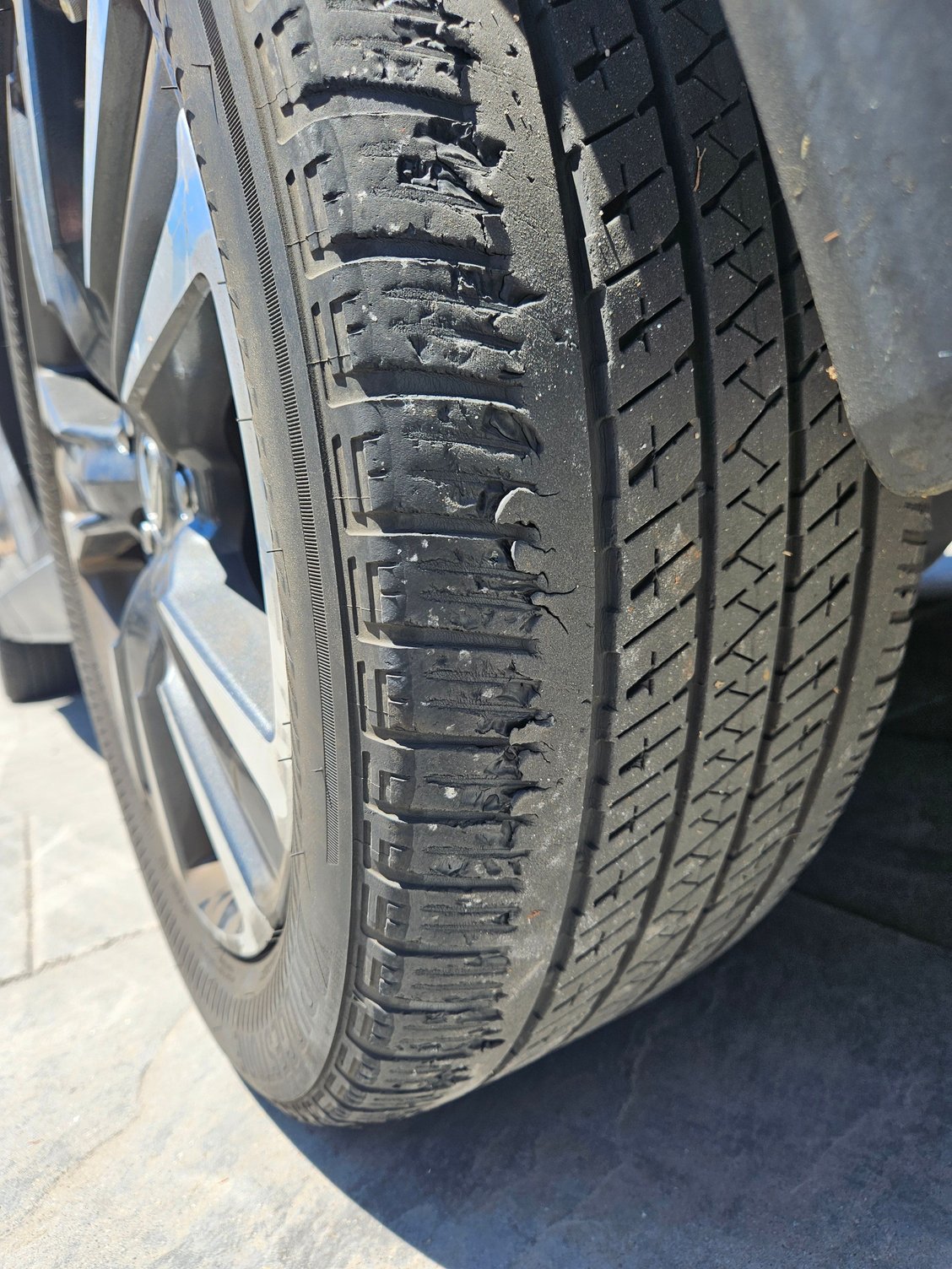

2019 UX200 with 22k miles. The front tires have horrible wear. (fronts have now been moved to the rear) There is some chunking on the inner and outer edges (mostly outer). I took it for an alignment thinking that was the issue. The alignment was off a negligible amount, I had them align it.
The car is driven in So Cal. Our roads suck, but this is not the result of roads. I have other cars and this does not happen. The rear tires are wearing perfect. Tires are inflated to specs on door sticker.
What is causing this?

Coil springs and struts are weak or bad

Either way you're coming up on 5 years on original tires. I'd replace them.
You did have some mild toe in on one side which combined with the dry rot of the tires due to their age, could have exacerbated wear. Could just have had bad /defective tires that rotted prematurely. But either way time to start a fresh with new tires and your new alignment. but for anything else gone very bad (doubt it) i think you'll be fine w/ new tires.

The tires are terrible run flats. time to buy a new set. Get Michelin CC2s

The peeling and chipping on the shoulder of the tire is caused by dry rot and scuffing during sharp turns. There is nothing wrong with the steering or suspension, this is the typical result of too many sharp parking lot turns. In a hot environment, tires can show a dry rot condition after 4 years, those tires are almost 6 years old.
