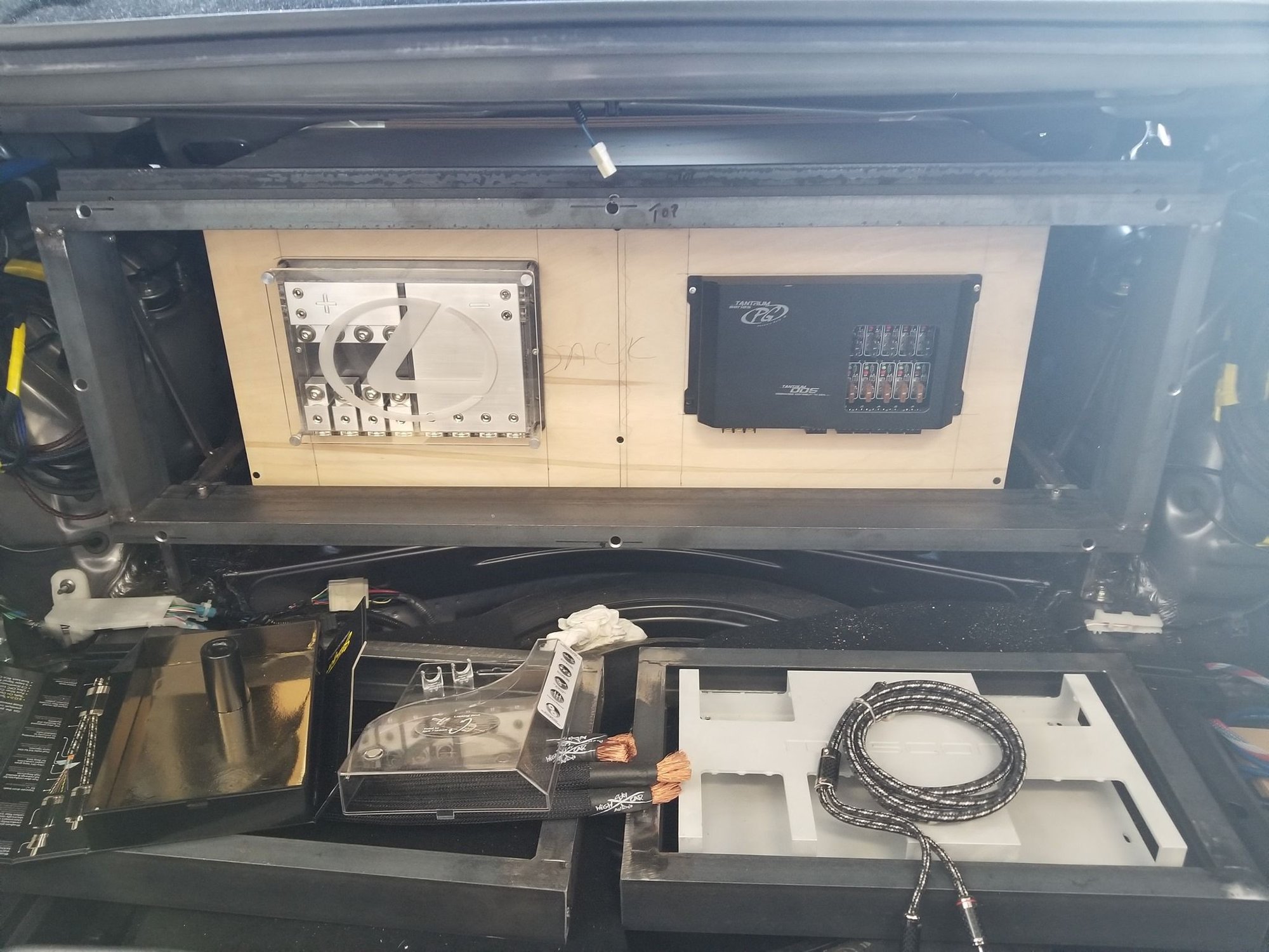

So I have a 2014 GS350 that is currently having a really nice stereo system in. Motorized amp racks, tons of stuff. So, I am a little worried on weight, while it it is still in sub mock mode, but getting towards the end of the mock, I may need to obtain some coil overs to dial in the suspension and ride height. While I am not opposed to being lower, I would prefer it to be capped at 1". Some of the roads I drive on are more towards the rural side. My main question is, it seems a lot of people like BC Coil overs, I am just worried that the weight of the stereo is going to have a worse effect on coil overs than it is with my stock strut/springs(not worn out, very responsive at 40,000 miles).

Coilovers will def help you dial in the right height, but you may want to consider getting a stiffer spring rate in the rear. I had a 4Runner with a heavy amprack in the rear, raised floor, plexi, 3 amps, xovers, etc, probably ~200lbs, and the suspension kept settling over the years until the axle was resting on the bumpstops. Just a thought.
