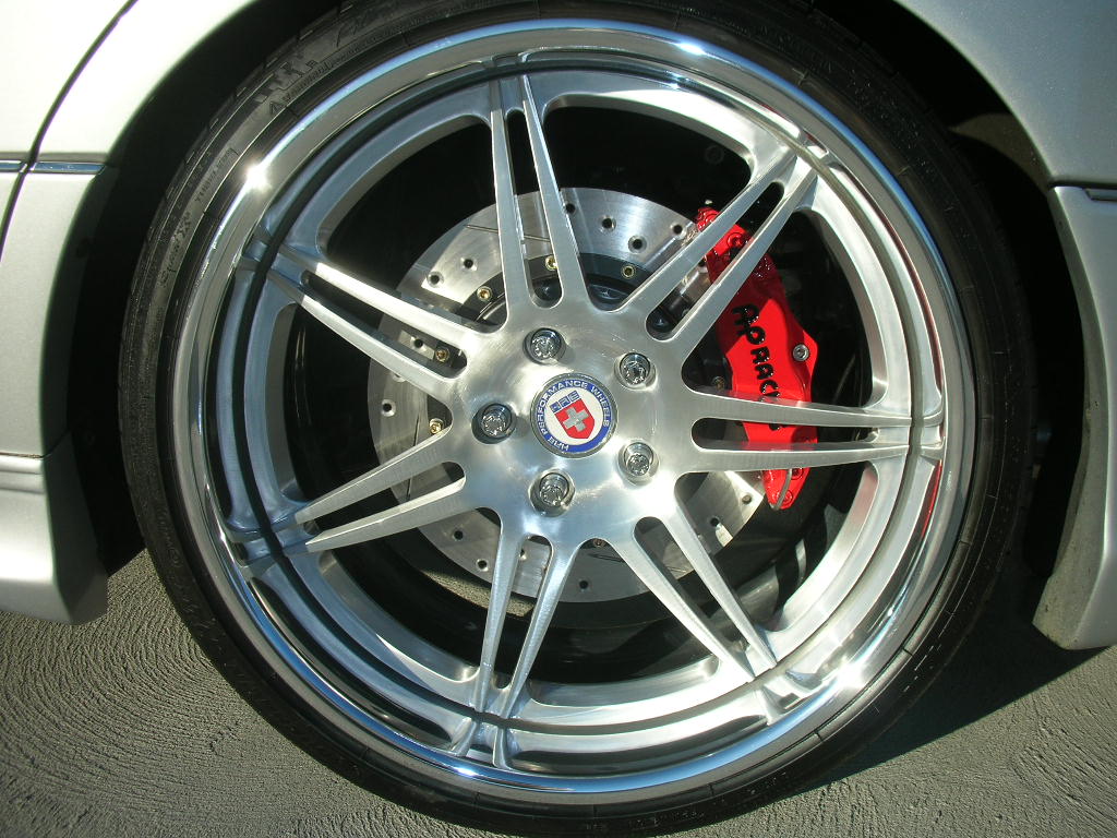

redgs4 had the StopTech 4 corner on his GS back in 2004. They had 355mm rotors all around and the caliper body was the same size as well, however the internal piston size was smaller in the rear, which makes sense.
Unfortunately since ClubLexus lost a lot of the old picture database, this is the only shot I could find quickly of the rears.
ISPilot was the owner of the now defunct PLP (ProLexPerformance) in which he worked with StopTech to get the 4 corner set up first introduced on the IS300 and the ONLY IS300 you will see with them was his car (now sold to another member). Redgs4 was able to get the 4 corner set up, through working with Mike and StopTech.
These two cars were really the prototypes if you will. Obviously this never took off.
Back in 2007 I posted my APRacing 4 corner set up.
https://www.clublexus.com/forums/sus...r-the-2gs.html
I basically ordered the Supra TT 4 corner kit. The front is bolt on and we had to make custom brackets for the rear.
I took measurements off of redgs4's rear BBK set up, which allowed me to design the custom brackets. Then the shop that sold me the BBK was able to fabricate them for me.
These brackets WILL NOT fit anything but the APRacing. You cannot mix and match different brand brake calipers with brackets.
If anyone wants a bracket for the 4 corner set up from APRacing, you can contact me. As for the StopTech set up, we know it can be done and we know they have the plans.
Unless the market demand justifies it, no one's going to sell it. With the curent state of the economy, I'd say if you really want it, you'll have to do it yourself .
Good Luck
