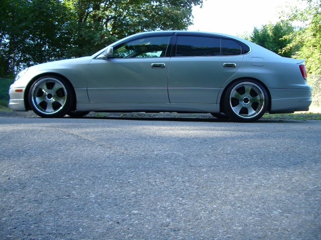

i don't see how people can run that low on the CS.
i have the v1.0's and the perches are at the lowest setting. with the damping even at it's stiffest setting, the front struts bottom outo n their stops because they don't have enough stroke to make up for the loss in height, so there is a lot of bashing and crashing to be experienced.
i also question the safety of taking off one of the two spring perches!!! is that even safe? i'm not saying that tein's stuff is bad, but i've seen the perch break into 2 pieces on a cheap set of sleeves on a honda... i don't have to tell you what the end result was

Can we get some pics of your car all the way down?

Old Aug 24, 2007 | 05:09 PM
bighitbike's Avatar
bighitbike
Joined: Sep 2005
Posts: 2,999
From: washington
Damn, I need lowerrrrrrrrrrr. I want those wheels though

those are 19's in the pic btw. but when i was on 20's i couldn't make those tuck either (as in no gap or even less) :huh:
california roads must be billard table smooth and paved with gold...
