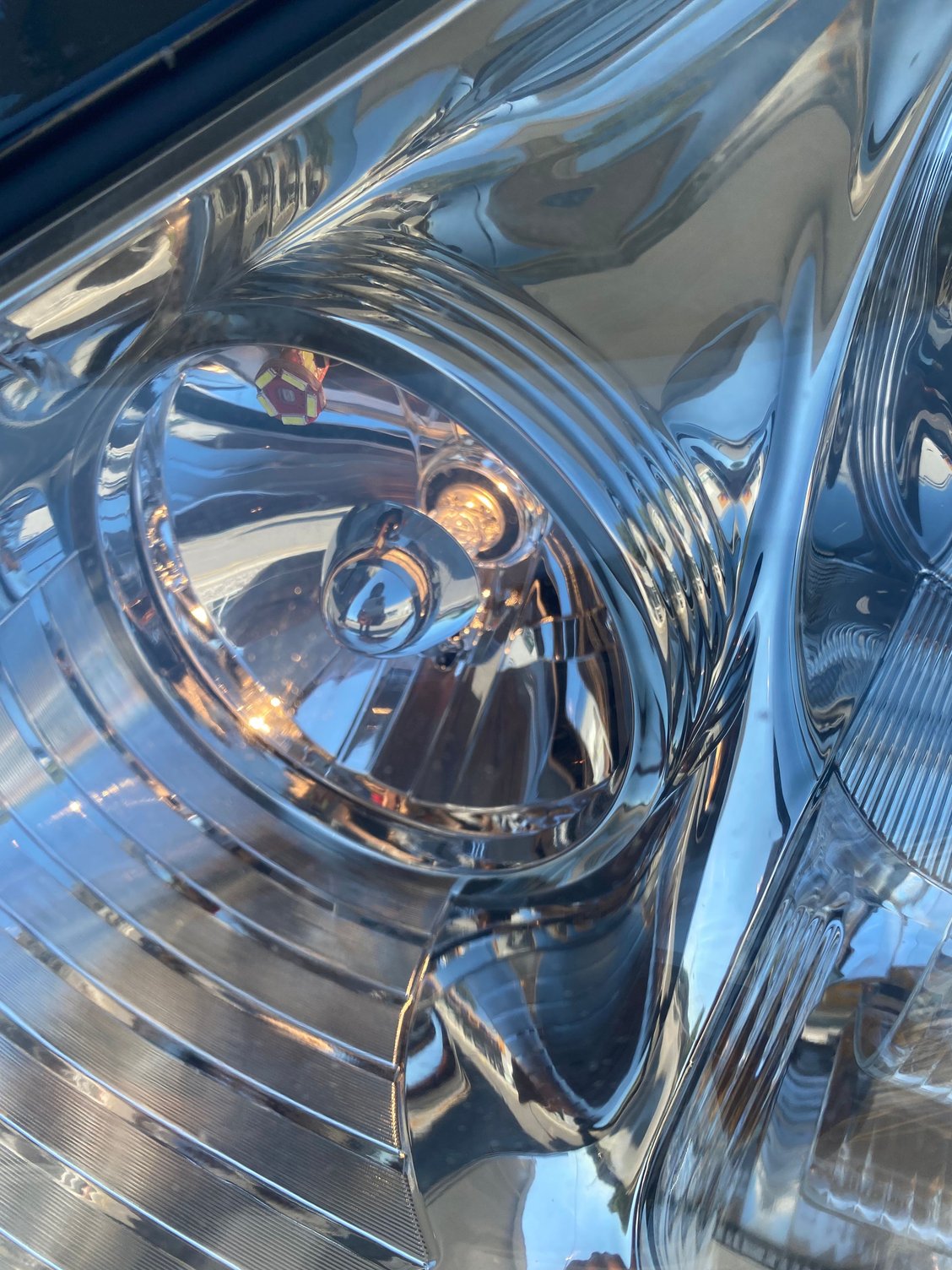

BIG QUESTION HERE IS... There's a smaller 194 sized bulb in that hole that's angled down.. that seems to be the DRL.. I assumed the DRL was the 9005 bulb and shared the DRL+HIGHBEAM Function with lower voltage for reduced visibility.
- Replaced Side Markers with White LEDS (Doesn't matter as side markers on my car are yellow) -- One was out
Am I wrong to assume this for the 08+ (I know there was a facelift in 06+) but from most posts I've searched/read, there's been no mention of this dumb little light.
Either way I replaced the 194 that angled into the housing with a white LED, and it seems my DRL light is only this one bulb, and does not share it with the 9005. High Beam works.. so I assume I have it right.

I has the same question years ago but no one seemed to know the answer. Definitely, it’s not DRL since it’s only on when the headlights are on, besides I have turned off the DRL and it’s still on.
Some says it’s parking light. May be. I replaced it with white LED and still don’t know what it is.

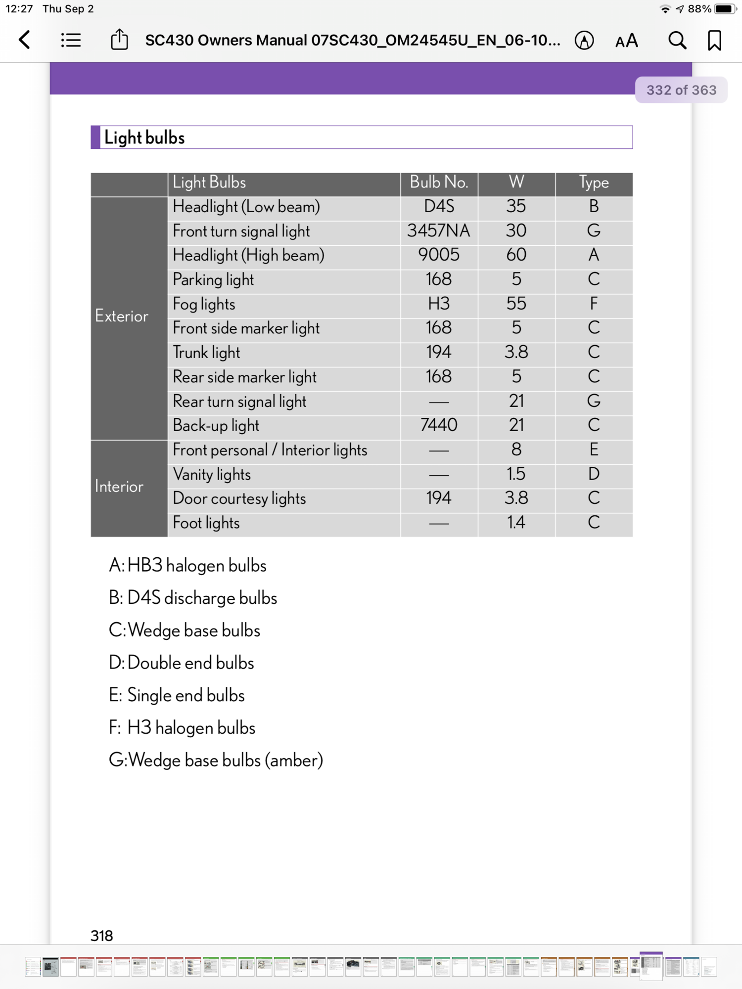

The FSM (for 2002) shows the bulb and it is labeled as a "Clearance Lamp Bulb". The Owner's manual refers to a bulb in that spot as a "Parking Light", and bulb type as 168. Obviously a change between 168 and 194. 168 bulbs are brighter than 194 if trying to use this for a DRL.

What is “clearance lamp bulb” ? What does it mean ?

......not looking @ my car, but if I remember correctly, that is the park light bulb. I have a led in mine & it's white currently. I've changed them back & forth , from white to orange occasionally
